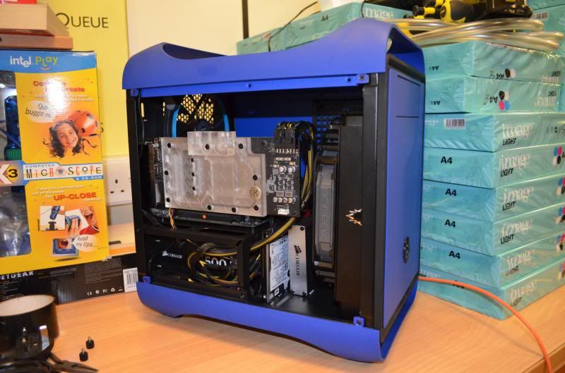

Hi,
I'm going to put a custom loop in a prodigy and been looking at other peoples builds and i've noticed they put a 240 or 200 in the front of the case and i'm just wondering that will be effective in my case as i have the aqua blue case which as a solid front panel. I know i'll be putting a 240 in the roof and i'm not sure what pump to go for either. The loop will have a cpu and gpu to be cooled.
Thanks,
Mark
Ideally you want some opening for your radiator fans to suck air from. If it's a solid front panel it's not going to be as effective. You could do the 240mm on the roof and a 120mm at the back?
There is a boarder around the front which has some intake. I have a 200mm fan in front sucking some air in so i might do as you suggest and have a 120 at the back. Intake on the big front and small back and exhaust in the roof with the 240 up there
Remember, ideally you want positive air pressure inside your case. I.e more fans blowing in that out. You could have your 200mm intake in the front, 120mm intake at the back and the 240mm on the top as your exhaust.
