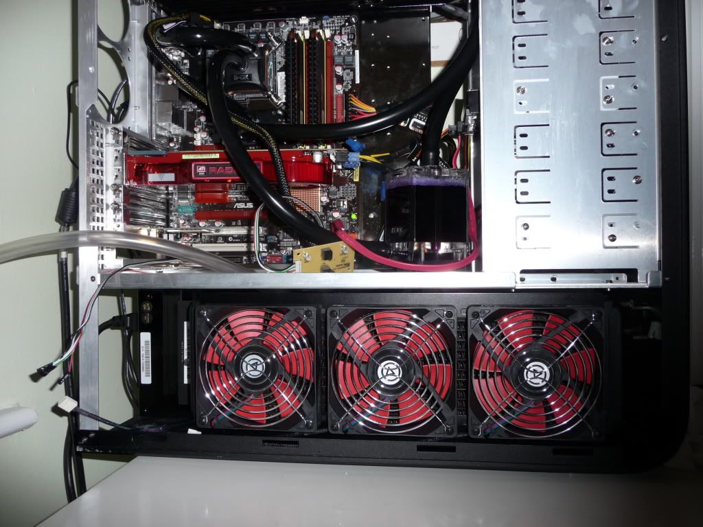

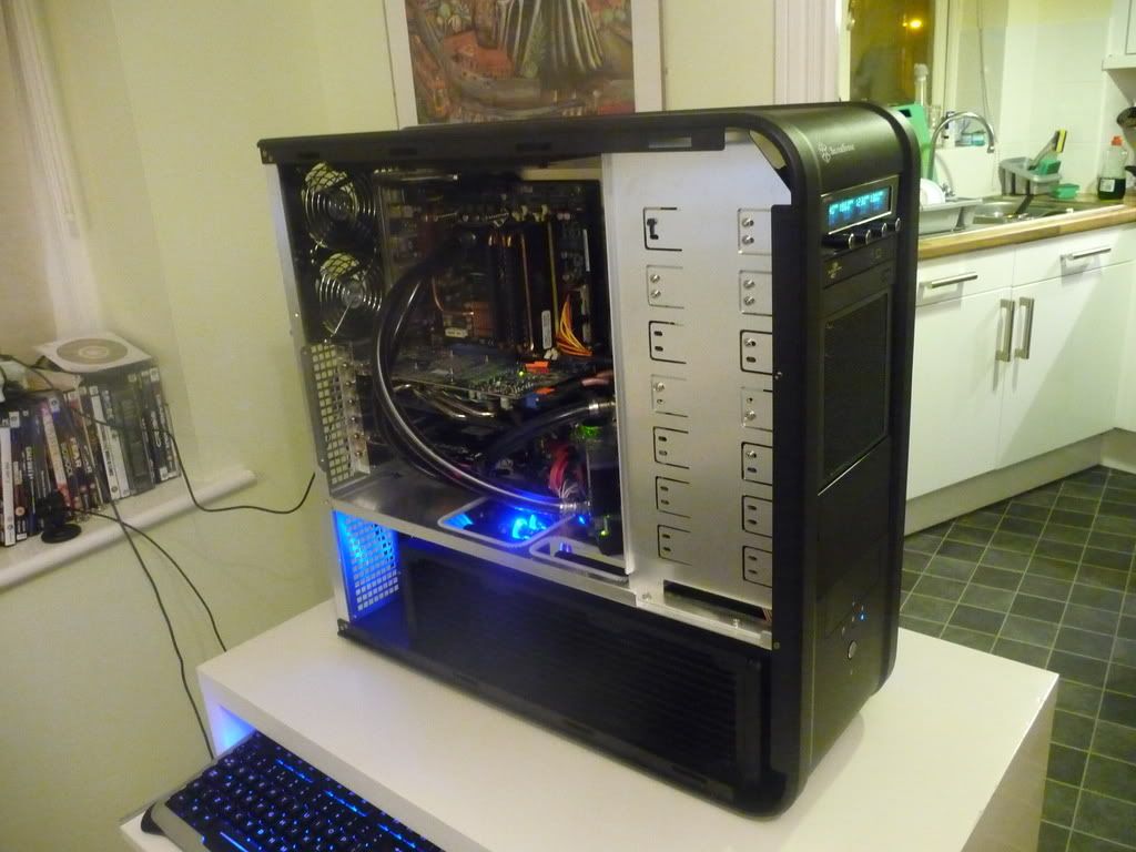

some pics:
old setup
some bits have arrived :)
stripped out
Let cutting begin!!
Suprisingly neat
Blocks on
Testing begins
fitted bottom RAD on custom-ish stand
not a bad start but still got a lot more to do..
lian-li bezel for DVD drive.
Custom front plate including Red LED mount.
mounting of both Pumps.

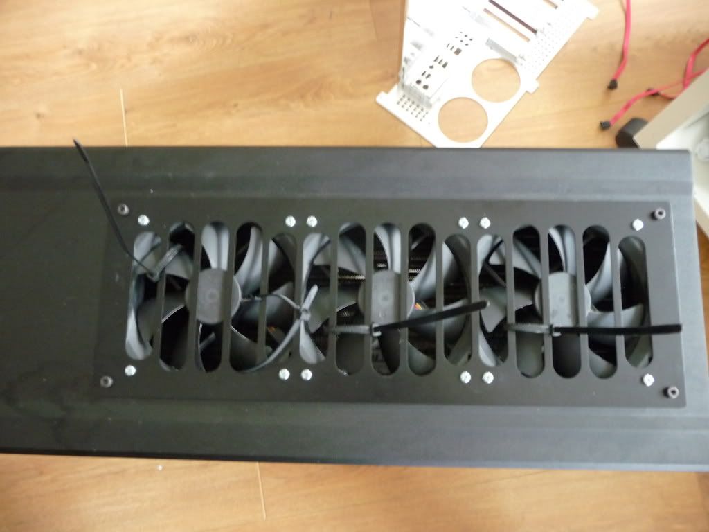

Custom side grills are being made, need to spray the meshing that is going underneath.
the pull out mobo tray wont close due to a fan hitting the top RAD so im going to stand off with some spacers.
the front LEDs to change to RED.
4890 water block to be fitted.
Mobo holes to cut for cables (i might braid a few more cables aswell!!)

the tygon stuff is better, getting a small radius with the XSPC stuff is hard, might have to fit coils (which i dont like :))
Update:
Bits have been ordered EK4890 block, feser aqua pure + red dye and some coils will post some pics when it arrives.
Going to cut mobo holes this weekend and fit the 2 pumps (with velcro for the moment), this means will be able to finalise cable routes and start braiding as needed.
getting ok temps on CPU considering i have the N/B and mosfets being cooled,priming at a max of 60 with fans on half power.

ive cut a few bits already..the roof, the triangular mobo bit at the top to get the rad in and a slot on the back so power cables can go behind the mobo directly.
im going to cut holes for the mobo power and the power to the GFX card, so i can fit the 2 pumps in at the bottom next to the bays at the front.
have decided to mount the 2 92mm fans outside so i dnt have to stand off the back panel was having a lot of hassle matching threads to the stand offs i wanted...seems they are not a regular (what i can steal from work anyway!!) thread.

Great build, the first pic really gives a sense of the size of the TJ07 - more so than a commercial pic against a plain background!
