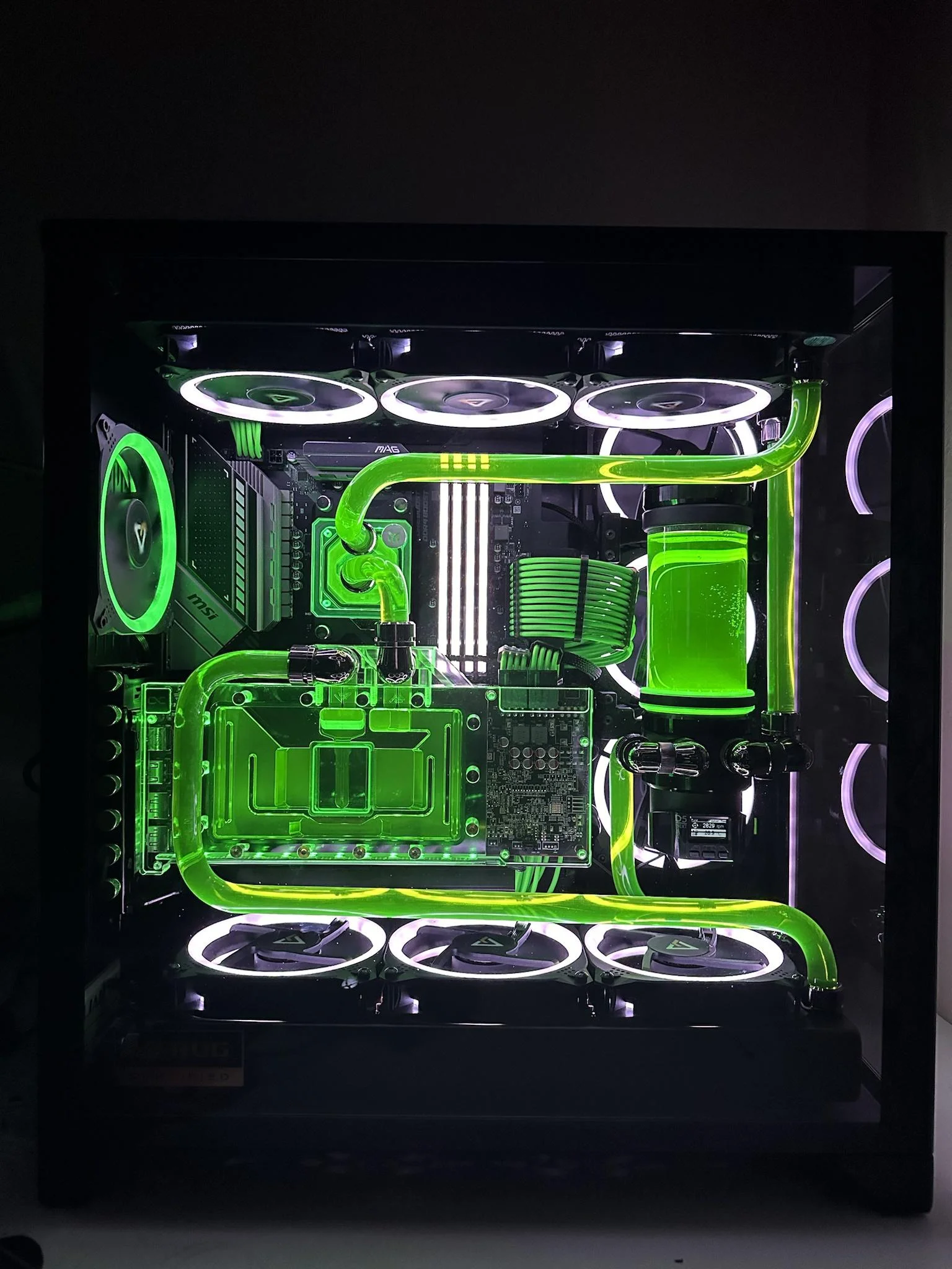

Here’s a photo showing how just playing around with the rgb can change the look. The green looks more accurate in this one.

You are correct in the XL being considerably larger than the standard O11D. It can be tricky to squeeze 2x360 rads and have a vertical gpu in the O11D, can be done but it is not straightforward. Have a look through the case gallery and see what others have achieved. I personally like distro plates and have one in my build but nothing wrong with a standard pump/res combo, Mike's version above with the water coolant readout is a very good idea and I would definitely recommend you have some sort of temp sensor in the loop.

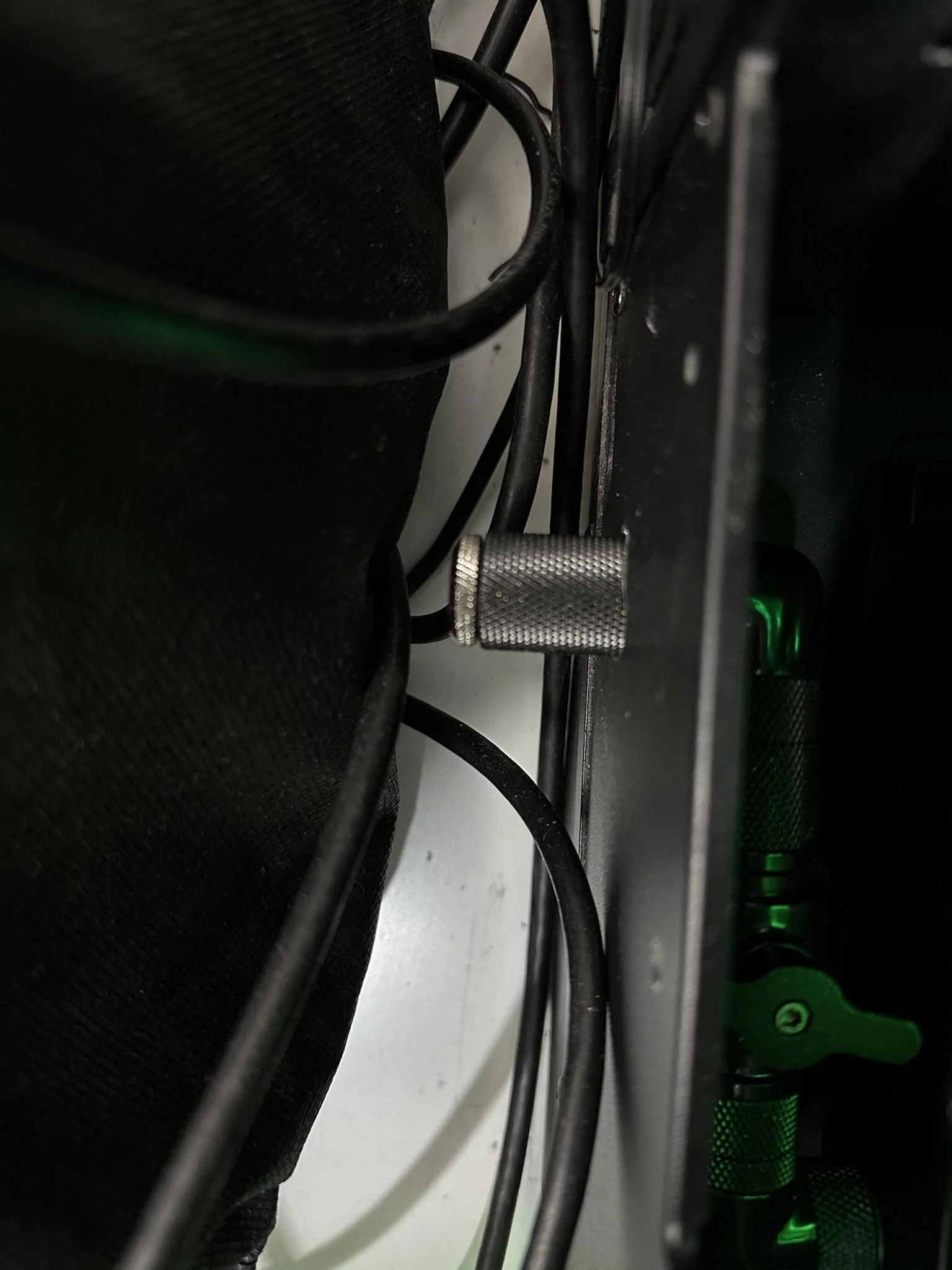

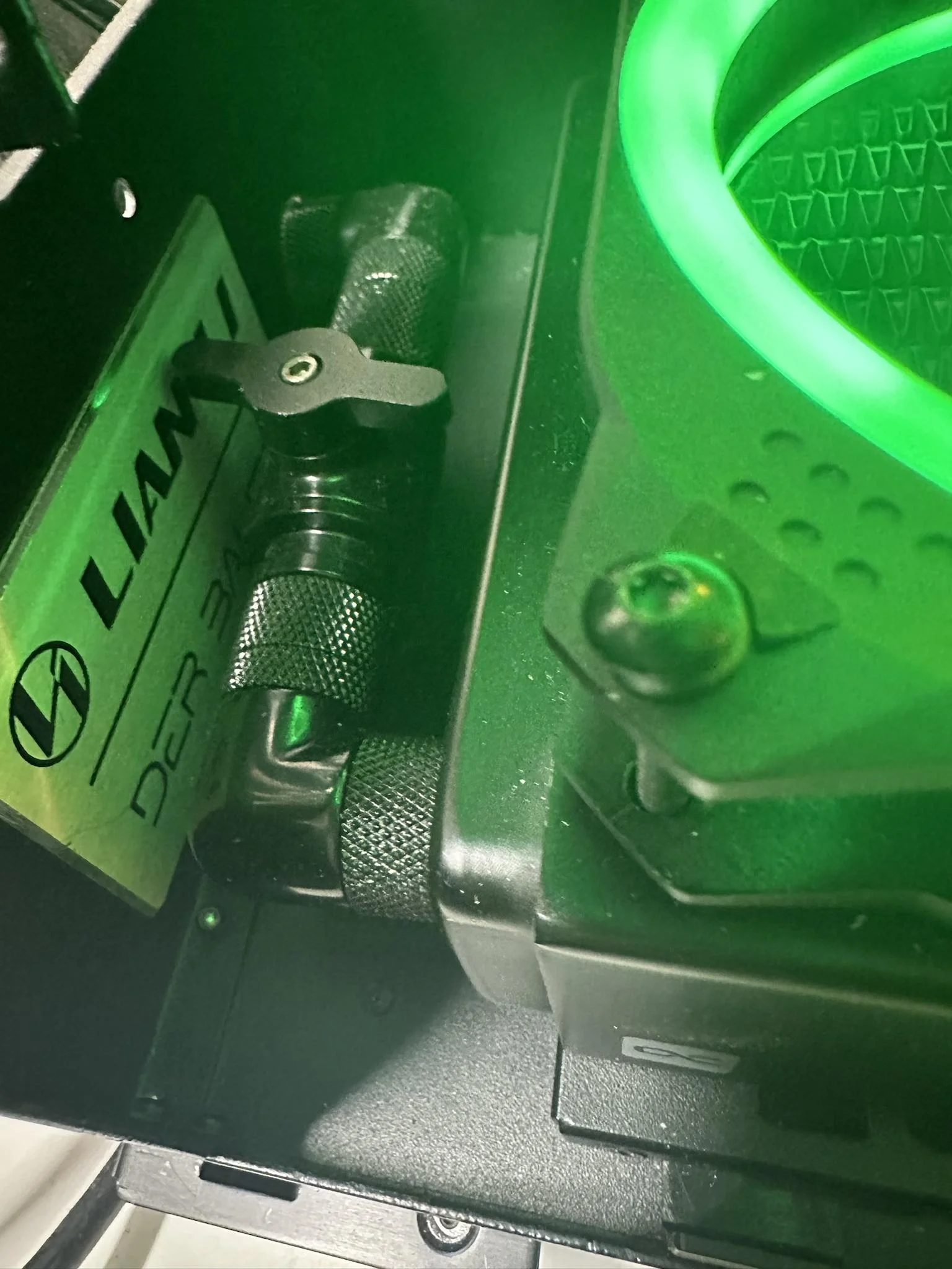

I can't see your fill point or drain point in your loop though, care to enlighten me? :confused:
The lots of other stuff comment made me laugh! Thanks Mike, that is very helpful and very much appreciated! :cool:
The fill point was easy, just through the top of the reservoir. I was worried at first that there was a rad higher than the res so maybe it would overfill during filling, but that wasn’t an issue.
The drain port was trickier as it should be at / near the lowest part and I wanted it to be out of the way. Luckily the alphacool rad has a port at the back end, so I put a valve on it and went out the back of the case. When I want to drain it, I have a barbed fitting I can screw in and run some flexible tubing to drain.
Cheers Mike. I would have thought the same, in that the rad is substantially higher than the top of the Res. Good to know.
I've just checked the rads I got for my son and they don't have the additional port so it will be a T-Junction off the bottom rad for him.
