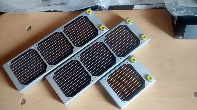

Some of the rads before the carbon wrapping:

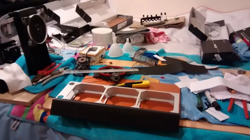

Wrapping rad + big mess:

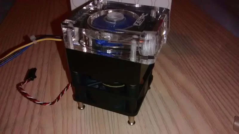

DDC Pump with top, heatsink and fan:

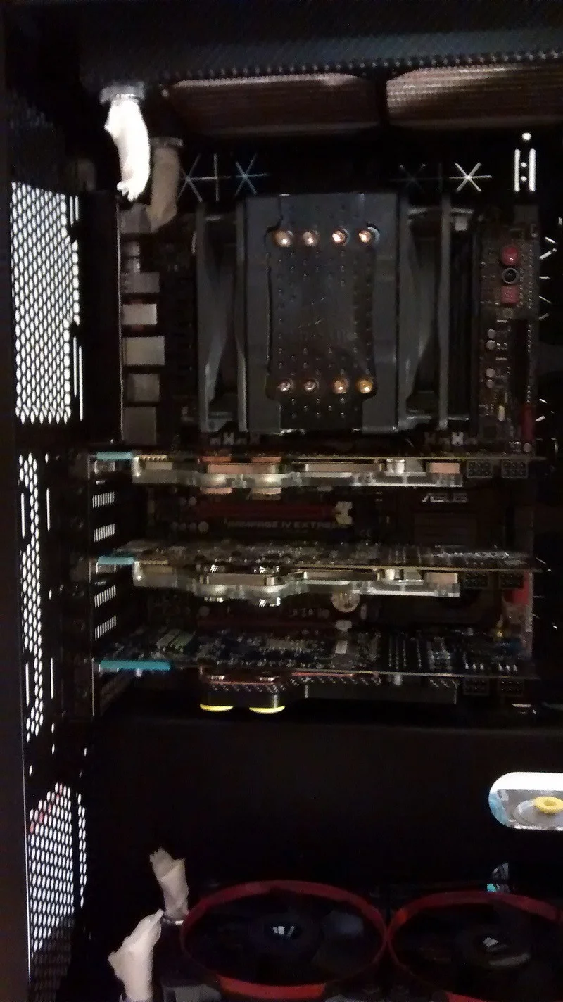

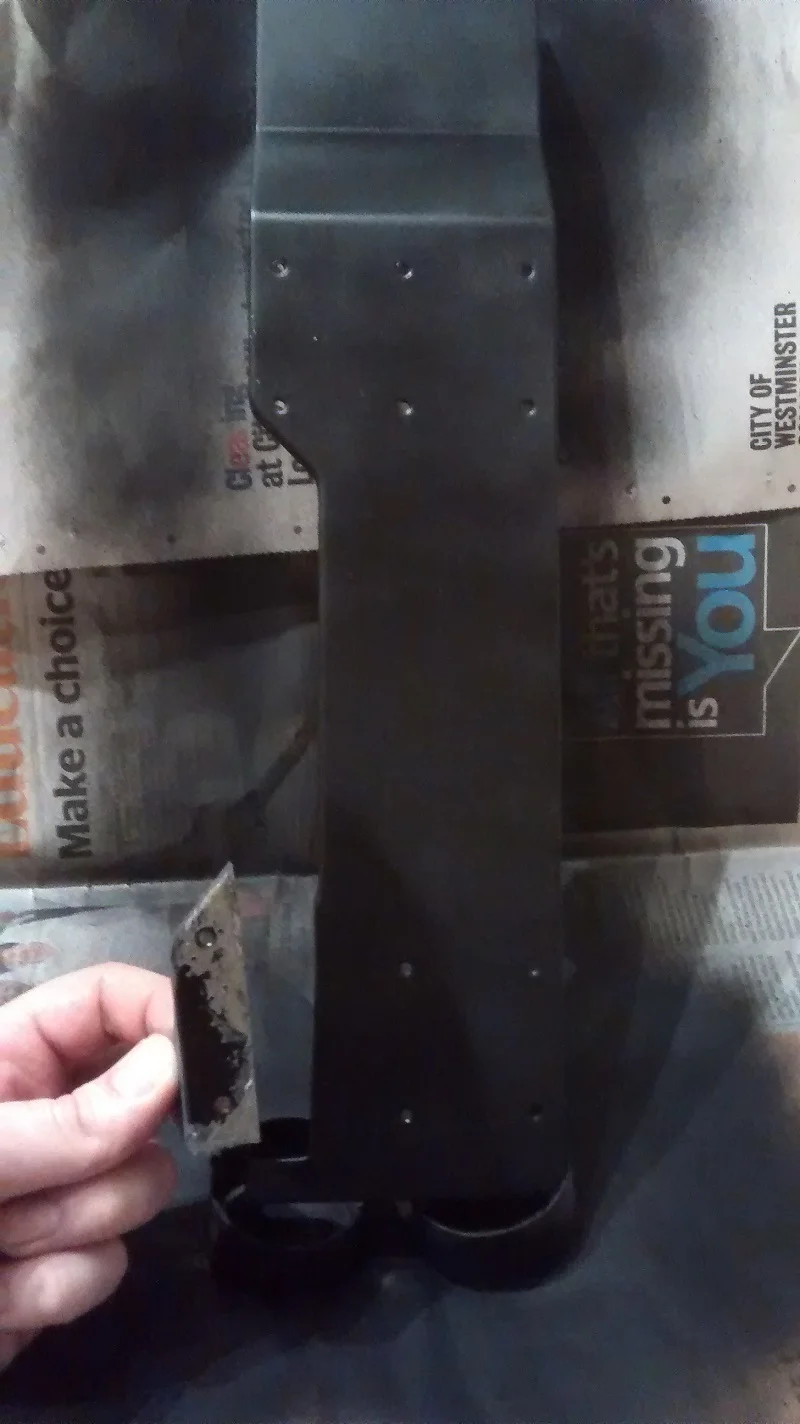

Had to cut the reservoir bracket to fit all 3 GPUs:

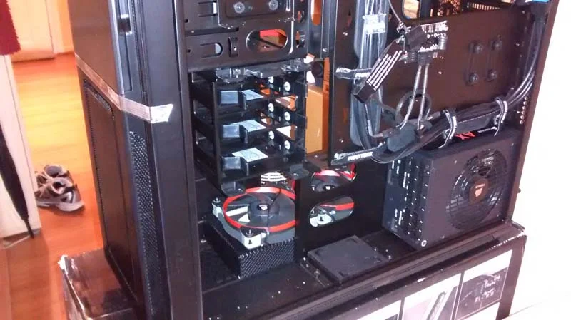

Enthoo Primo:
My old Corsair A70 that served me well for years:

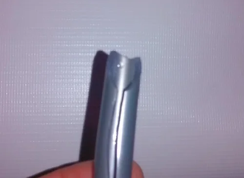

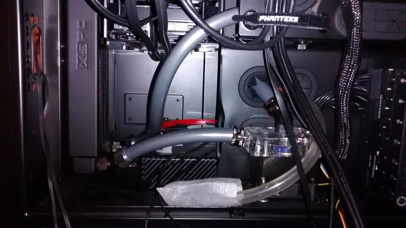

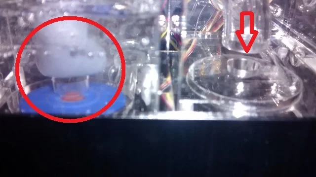

The XSPC Acrylic Dual 5.25” Reservoir for Two Laing DDC has a design flaw, that tube inside the reservoir goes straight to the pump intake and because of the speed of the pump any air that wants to come out is pulled by the pump, so I had to cut a tube and make a barrier, so the air would raise instead going back to the loop.
Tube:
Tube inside the reservoir, I removed the tube after all air was out.

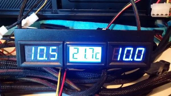

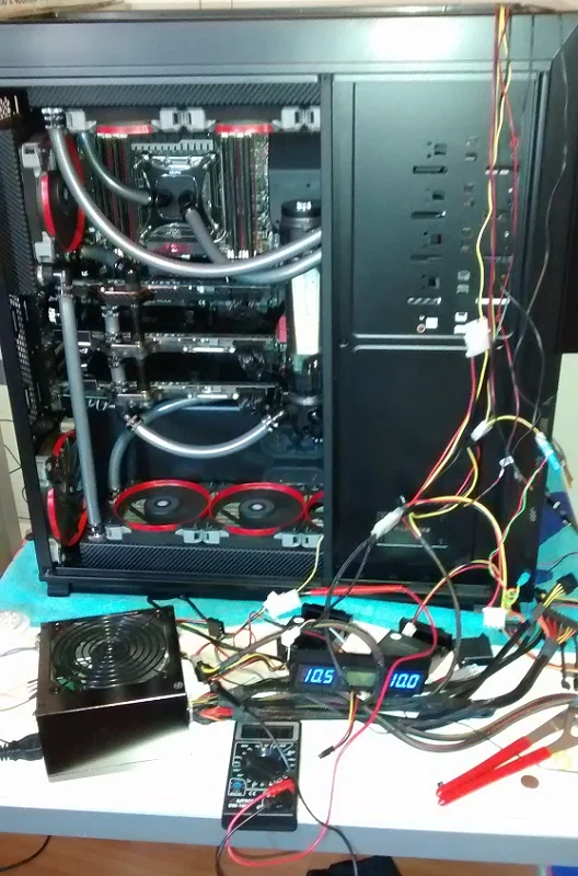

Testing my custom panel that shows the voltages going to each pump and one temperature sensor that I don't know where I will use it yet.
Panel in detail:

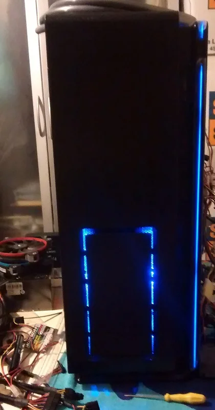

Since the Enthoo primo comes with a blue led strip, my front lights will be blue and my internal lights will be red to match the MB and Fans.

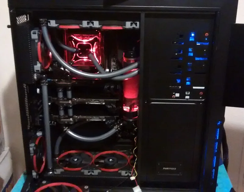

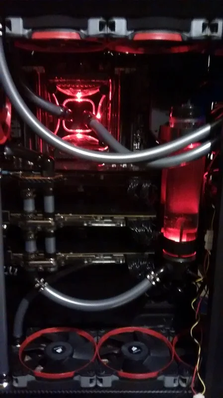

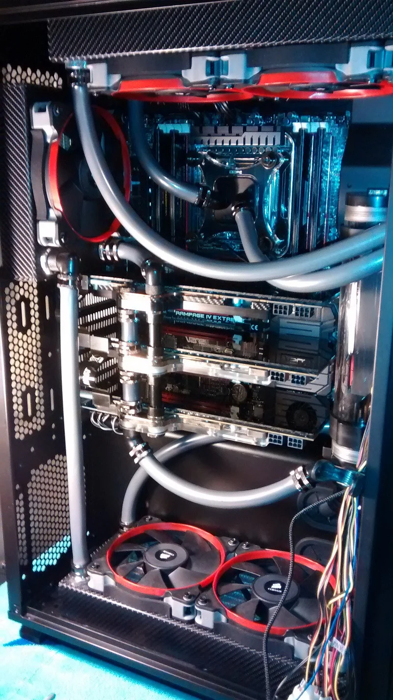

some updates:
Blue front lights are done:
Reservoir leds, pumps voltages and temp sensor are done as well:
Red internal lights on CPU block and Reservoir
Pump voltage controllers are hidden and can be found under the top mesh

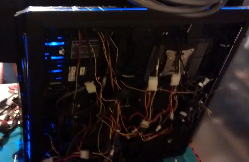

Now I need to sort out the wires, temperature sensors and fan controllers as I'm going to use 2:

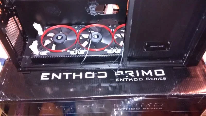

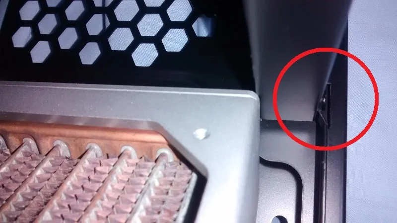

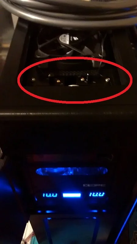

I got a e-mail from someone asking about the AX360 on the bottom of the case, as it actually doesn't fit.
If you see on this picture, you can see that it doesn't fit, but if you straighten that marked spot, the rad will fit.
