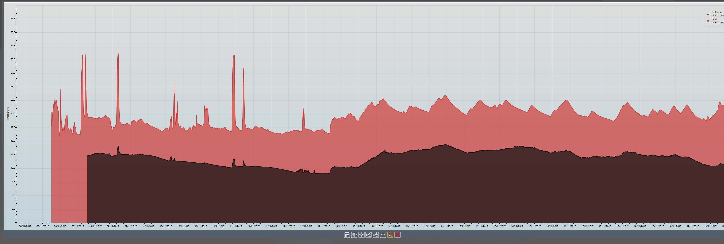

Small update, I'm continuing to monitor temperatures as I need to know how things work in reality before investing time in design and construction. My PC will idle for another two weeks as I'm at work for the next fortnight, so it's a good time to collate data. Idle temperatures are most interesting in winter because that's where all the risk is (freezing fluid). My wife has informed me that there's been frost the last few days and as you can see my fluid temperature has remained around 20C which is much higher than I would have expected.
Great for winter, but definitely not good for summer. I need to ensure my final build is versatile and able to adapt automatically to the external influences. :)
Click on image to enlarge.

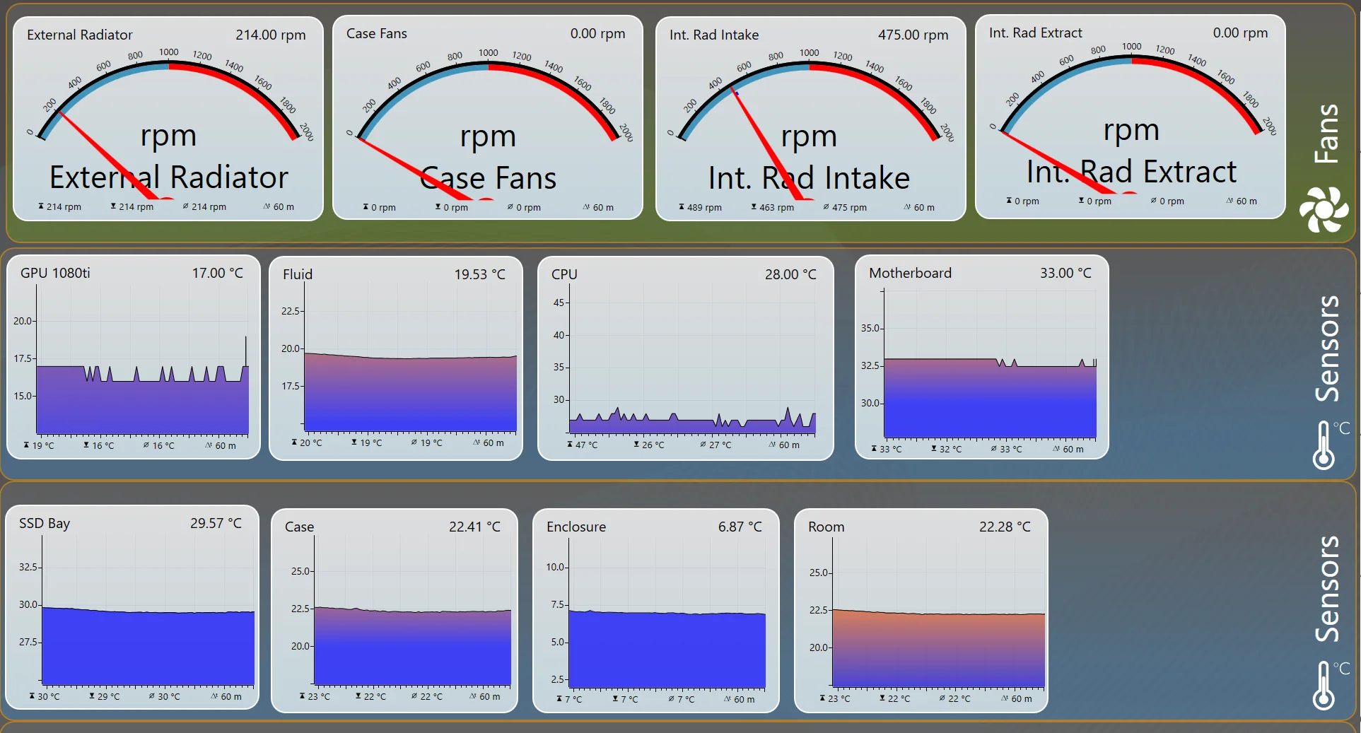

It looks like I'll have to modify my plans based on the testing to date. The temperature has plummeted to -7°C and this has meant my external enclosure temperature has lowered to around 6°C. I won't know until I get home whether the anti-con heater has been called into action (I've got a power meter on it) but I've got a sneaky feeling that it has as it's set to kick in at 5°C.
What's interesting is the fluid temperature, it's still hovering around 20°C. That's pretty much mission accomplished right there as it proves that even with external sub zero temperatures, the enclosure is keeping itself above 5°C and amazingly the fluid temperature is staying at room temperature - so no chance of freezing.
The only way fluid can be so much warmer than the enclosure it's in has got to be down to the internal radiator in the case pulling the warm air from the office through into the case. It's not only keeping the fluid warm but it's also keeping the components in the case cool.
I need to cancel my plans to move all my cooling gear to the external enclosure, it's just not going to work when temperatures are sub-zero. So, this system has been idle for 4 weeks which has been a great test in terms of freezing fluid risk, however it's now time to pound some gaming and see how that's working out in these freezing conditions.
Here's a graphic of what's been discussed in this post.

Anyway, it's a moot point. My plans have been classic over engineering. The Mercury has hit -5 this winter and my fluid stays above 20C. It's just not going to freeze due to the amount of time the fluid spends in the office side of the loop which is always around 25C. I leave the external fans at 200rpm and the fluid is 20C+ no matter what the garage temperature is. As soon as the GPU goes under load the external fans ramp up to 2000rpm.
The result is a GPU temperature of 20C on idle and 27C under full load. It's well and truly mission accomplished. :)
