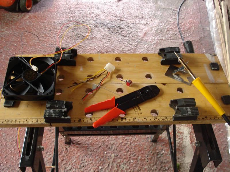

Next we decided to make the fan controllers. These were going to be simple: a flick switch that lets you choose whether the fans are run at 12v or 5v. There was going to a switch for the 120mm fans at the front and back of the case. We got yate loons so they were going to be quiet anyway, but since the computer was going to be living about four feet from the bed in my friend's uni room, we decided having the option to turn them down even more overnight would be useful.
It's really simple to make: the red and black wire from the fan (12v and ground) are soldered to the middle two pins, then yellow and black from a molex connector go one way and red and black from a molex connector go the other way. We tested it in my computer again, and they worked fine.
