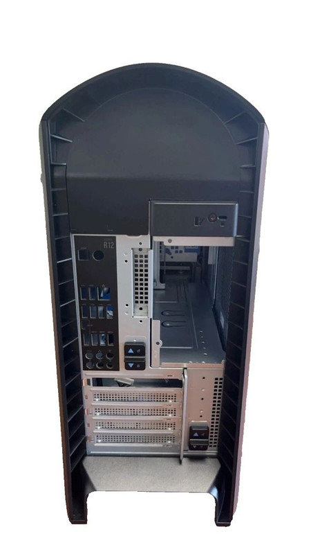

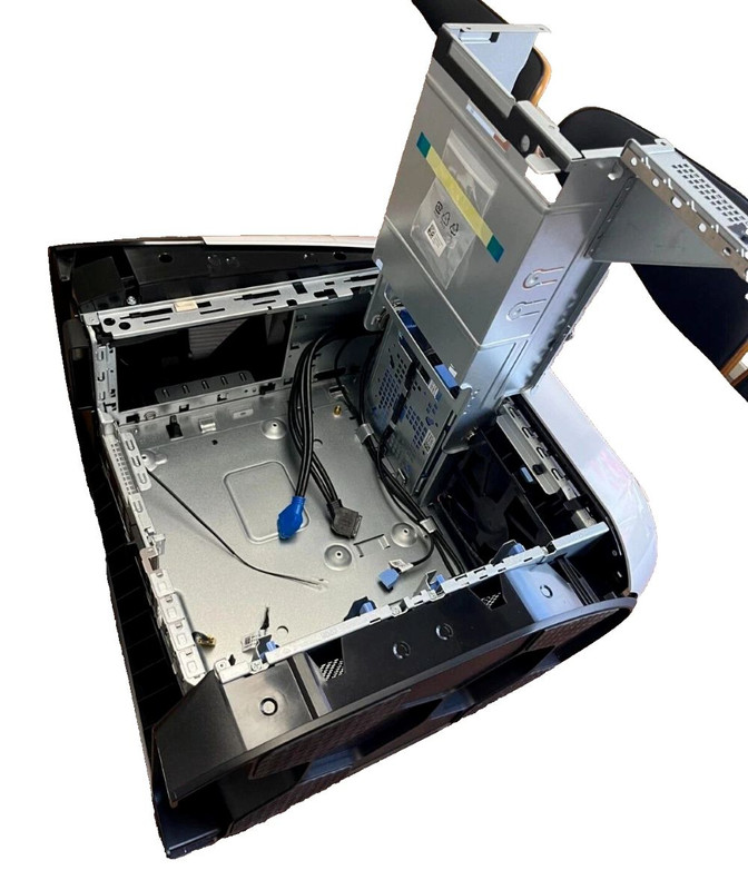

Any way, given how "nice" Dell had been for many years I figured this would be a simple case swap. Seems I was completely wrong ! The first thing I realised is that the IO shield is not removable.
Which is kinda Apple like but look we can deal with that. They even left us a nice template to cut out. However, this was when I started to notice oddities. First up there are two USB 3 connectors.
OK not a problem I can get around that by using this.
Then, however, I spotted this.

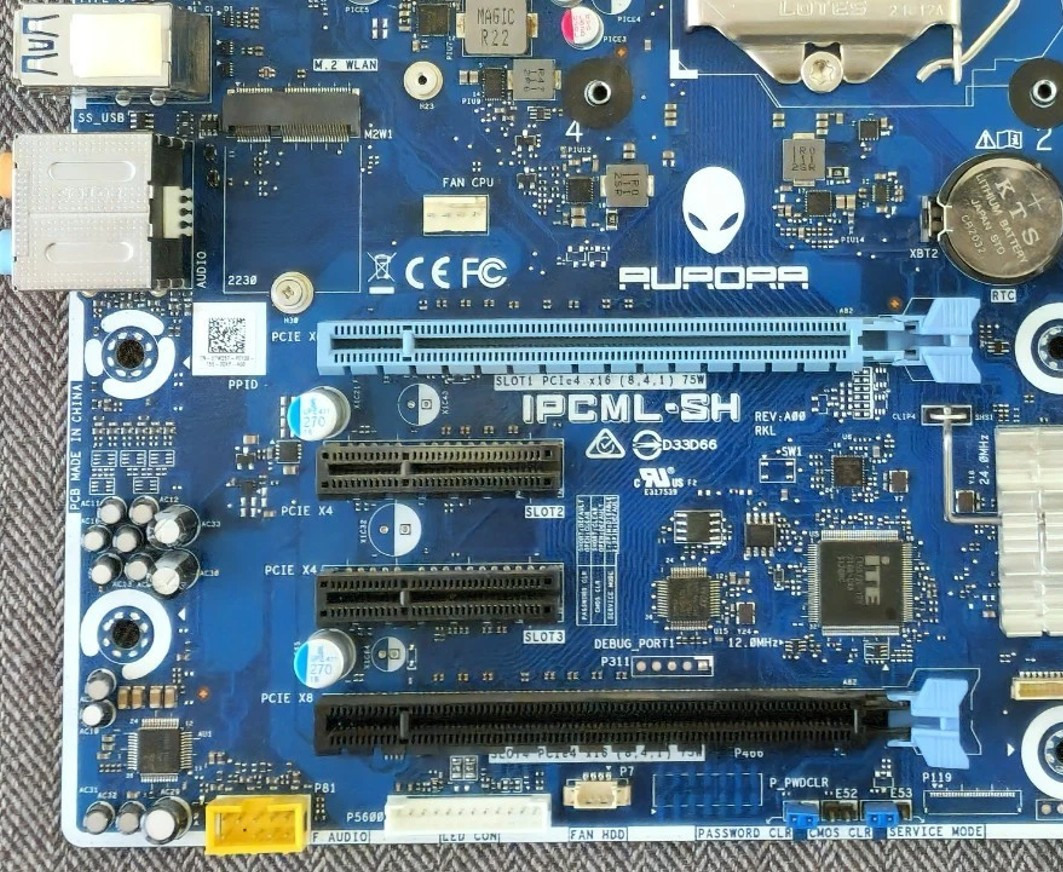

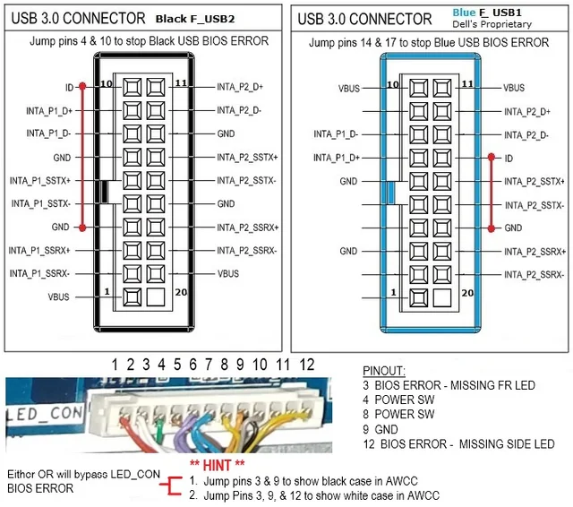

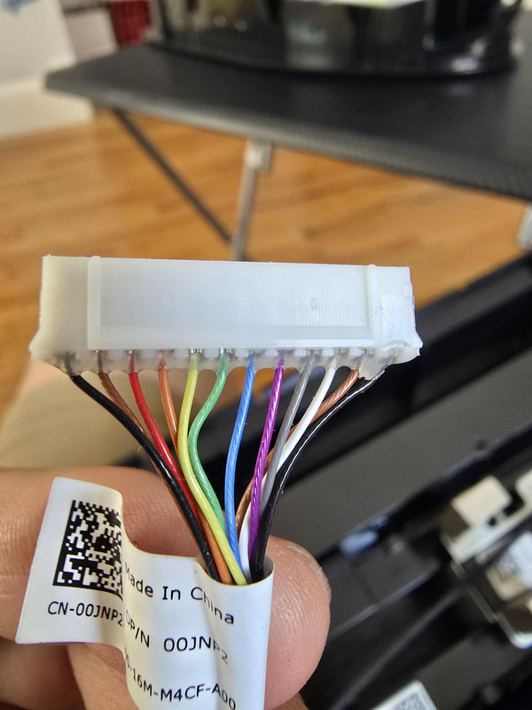

And was like "WTF is that?". I soon got my answer when I downloaded a pic of the board that comes in the case.
See it? LED con. You'll never guess what? no one has decoded that block into a pinout. Nobody. In fact, when users have a board failure (which is very common on the boards Alienware did not fit any VRM coolers to) they naturally swap out of this case not back in. Hence the irony. Some complete wally wants to swap stuff INTO this case, not out.
Thing is if you knew me you would know this is like a red flag to a bull. You know? challenge foogin accepted you aholes.

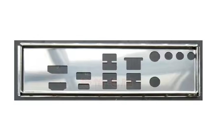

Any way so the devolution of Alienware aside.... I have never had an IO shield on my X570i Strix. I bought it as a bare board only customer return for about 1/3 the RRP at the time. I finally found the IO I need on Ali, years later.
Which is awesome. I can also use the reverse flow fans I bought and never used when doing the 5090 build.. The rest of the fans? I have two carrier bags heaving with the sodding things.

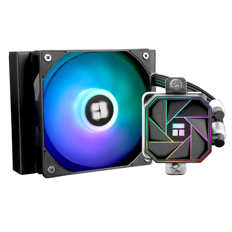

I have bought a cooler BTW. It was £30. I think the 5700X3d will be fine with it.

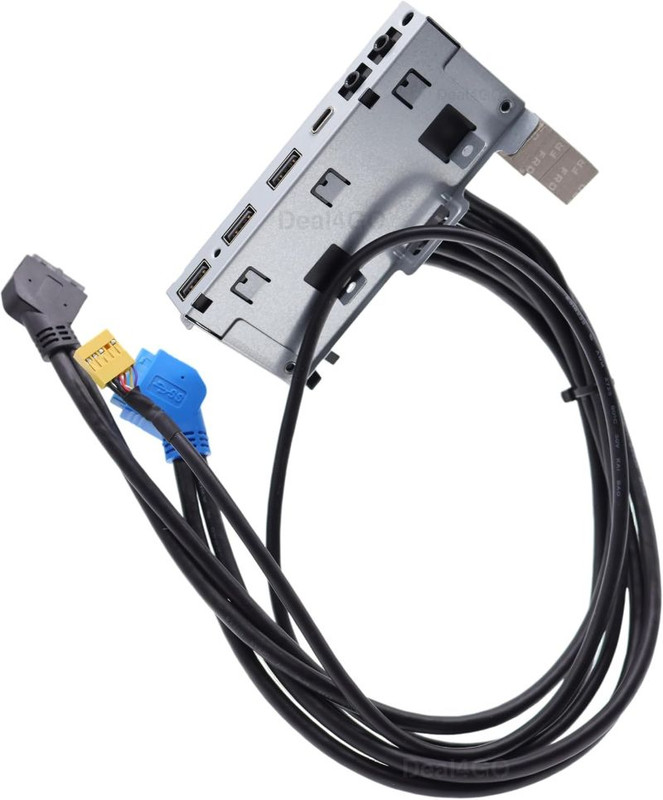

That is the main block in the front panel. And, it all looks completely normal tbh.

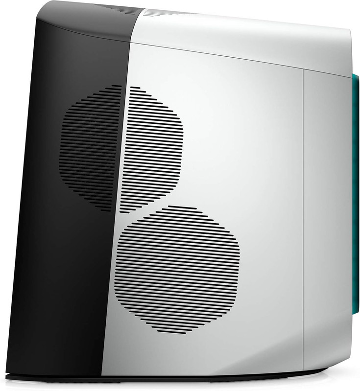

I've also been doing some research on the lighting. It seems the main lighting is in two areas.. The front, and this side (the entire name lights up)

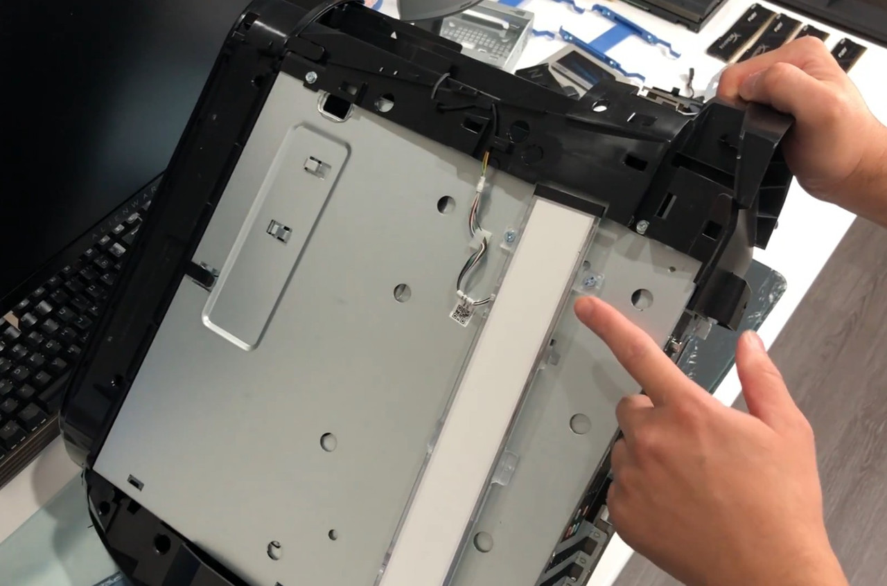

When poking around however I discovered this video.
That is it there. To me? that looks like some sort of light panel. And, I reckon the milky white part is just a cover. I reckon I can mod that and put two RGB strips under it. Well, if I don't blow it up first lol.

That side panel, BTW, looks like it might be EL. Those tubes if they light up pale blue are probably the same. If I remember correctly the Electro Luminescence needs a much higher voltage and the transformer can whine a bit...which always put me off when I was aiming for quiet.

I assume you've come across this:
As you point out Alienware tend to have way more non-standard proprietary connectors/layouts than you'd expect for a PC chassis with mostly standard components! Nice to see you making the effort to modify one and work around it though :cool:
See above - the Blue USB3.0 connector may be wired differently
Yup I clocked that last night. The black one is standard. The blue one isn’t.
I found some spares last night. So It’ll probably be a graft job of sorts. I only need one really to plug my phone into.

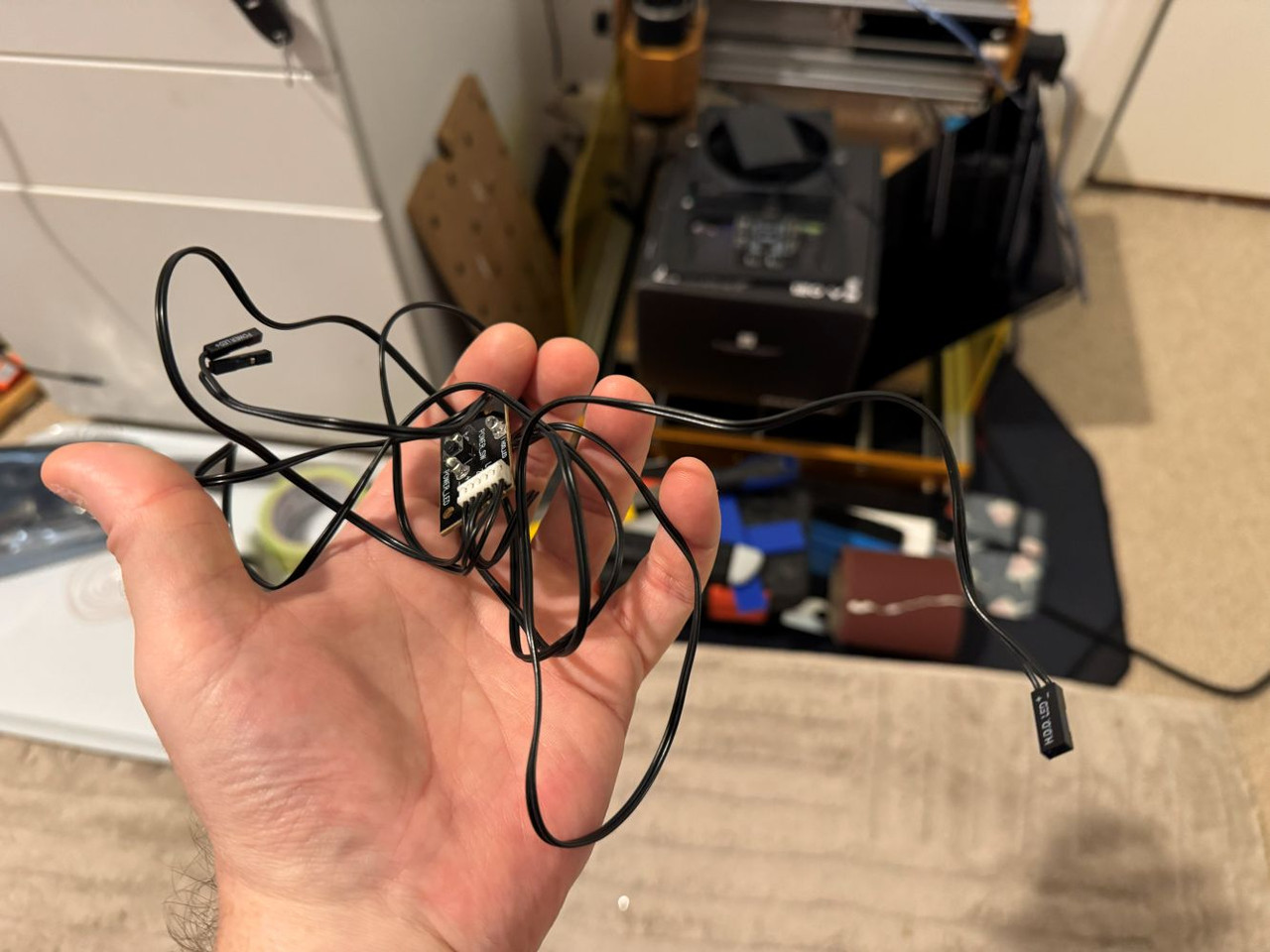

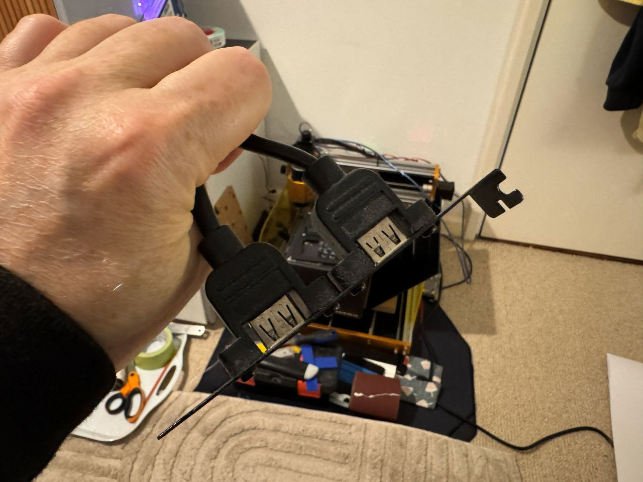

OK so yeah, I think that the job will be to take apart that metal USB box and do some JB weld grafting inside. I did a womble hunt last night and found this.
Like I said, good thing I bought that rotary tool lmao. I also found this one.
So aye, plenty. I found this too. Looks like I ripped this from a case now long gone.
No power I have nicked that already but the HDD LED and PWR LED are there. Talking of LEDs... I want the head button on the case to be lit white. No point in RGB it just makes it harder to see. OK and here is the pile of also somewhat wombled parts.

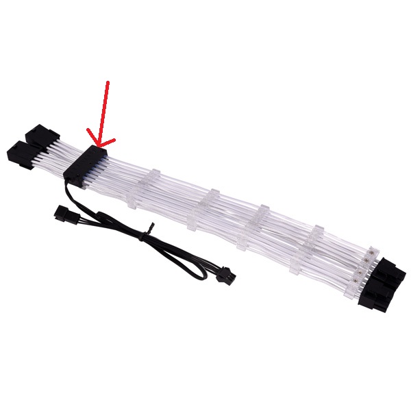

They are not EL. Inside those little things (black) are single LEDs. The tube? is just clear plastic. Think Lian Li Strimer. V1..
With those there are 8 LEDs in the black block polnted to here.
They then project along the plastic. So the reason Alienware have used two? is because the light won't project far enough so they have done it in two halves. I can better that for sure. I have not seen inside the channel in the front yet, but if I can slide a RGB strip in sideways (like thin ways) I will just do that.

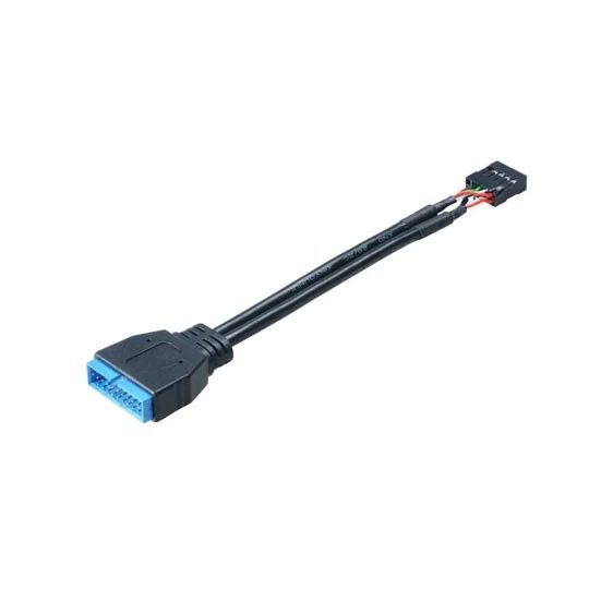

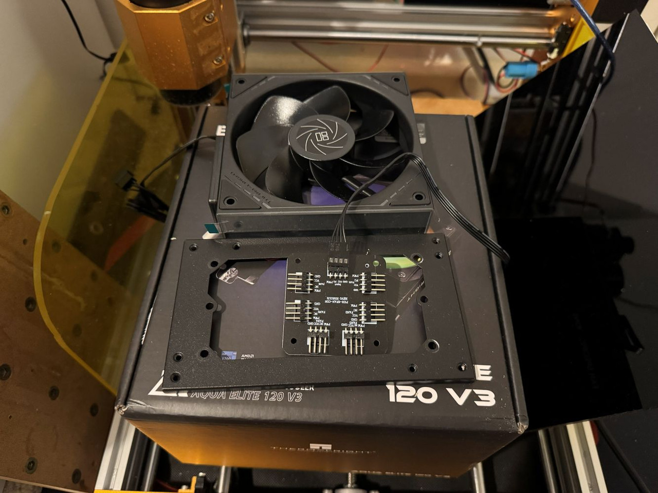

OK so I also ordered one of these. As I mentioned I would like to machine a board that this and the fan hub reside on. Kinda like my MSI case I was using.

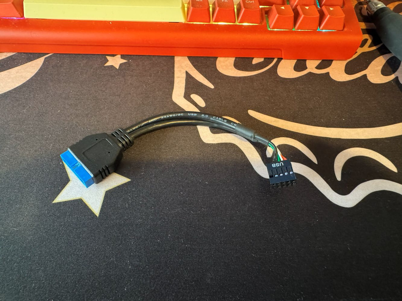

It also dawned on me that the black "USB 3" header is actually not one. It is USB2. So the adapter I bought should deal with that. Which only leaves one USB3 and one USB C. Obviously the latter is not possible but that only leaves me with one port to sort out. I only ever use one port on the front of any PC and that is to transfer pics from my phone. So yeah, the C can be blocked off or what not. I think you can buy like rubber things that press into them and cover them up.
Edit. Well blimey, that was easy eh.
I got a gold one because I think I am going to theme it on "Aurora R12 ROG Edition".
Edit again. More good info if you are tempted to take this on yourself.
The front audio port is wired up "normally". I have just cross referenced it with the Strix motherboard manual (and the Strix is normal wiring). It also seems to be in an agreeable place to reach into a normal board.
The BLACK USB "3" header port is also wired up normally as a stock connector would be. So you can go ahead and use something like I got to make that work.
