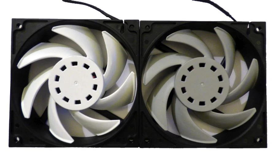

Today I have been looking at the fans. The EK Vardar fans have been highly recommended by a lot friends and I can see why. I hooked some up to test and they are virtually silent and appear to move a lot of air compared to some old Silverstone fans I tested them against. They are however best described as ugly ducklings in the standard black and grey and would be more at home in an industrial factory or warship than a computer case.
As I have some time whilst I wait for the case to arrive from Parvum I have decided to spray the fan blades white so that they better match the White/Black theme of the project. Whilst it is possible to buy all white or all black as stock I really wanted to have a 50/50 mix to match the rest of the case. I suppose I could have bought 15 all white ones and 15 all black and swapped the blades but that would have got needlessly expensive. I have attached a photo of the freshly sprayed white blades next to the stock grey so that you can compare.
Personally I think it makes them look a lot better so will continue and spray the other 14 tomorrow...

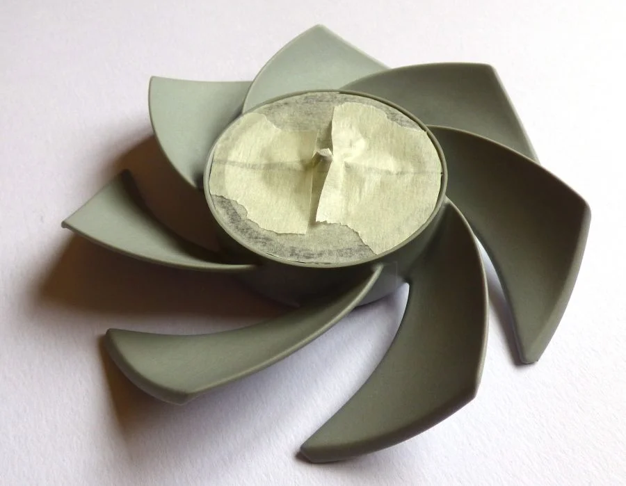

They would be very difficult to spray with the blades on thanks to the cooling holes etc, so I took them off first.
The label on the back peels off relatively easily and comes off in one piece. The C-Clip is pretty easy to pop off with a very small precision screw driver. Be careful when you do as the spring under the ball bearing is pretty strong on these. Most times everything has still been held in place after removing the c-clip by the plastic o-ring that is located under the c-clip on top of the ball bearing and still holds everything in place by slightly fitting under the groove at the top of the fan shaft. Its easy to remove by slightly pushing it around until it pops out of the retaining groove on the shaft but have your hand above in case it all flys off at this point. The rear ball bearing and spring should now either fall out or pop out and then you can simply push the blades forward and they will come off. You need to mask the vent holes from the inside so nothing gets inside during spraying then seal the middle of the fan with masking tape as in the above photo. The blades are actually pretty rough, slightly pitted plastic so sanding them before spraying has made little difference and the primer held happily without doing so. 2 Coats of Halfords white plastic primer followed by 2 coats of Halfords Gloss white appliance spray did the job nicely.
Assembly is a bit fiddly thanks to a relatively powerful spring. The trick is to compress the rear ball bearing against the spring and then use the plastic o-ring to engage with the retaining groove on the fan shaft. This will hold everything in place whilst you then get the c-clip back on. You need to then align the o-ring and ensure that it is central to the ball bearing and not too far in to the retaining groove or the fan will have excess resistance when turning. A little bit of sewing machine oil dropped on to the o-ring finished things up.
In summary the Vardar fans are a bit fiddly to strip but entirely possible.
