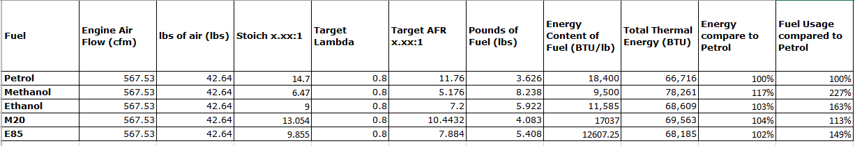

E85 vs M20 + Vpower very similar Octane rating (E85 ranges between 102-105 depending on what the actual ethanol content is as it varies quite at bit at the pump)
E85 will need a bigger fuel system due to a stoich value of 9.8:1 compared to 13.06:1 with an M20 blend (Assuming the E85 is actually 85% ethanol)
Final two things to consider are latent heat of vaporization and BTU/lbs of both blends which I can work out properly later if you want me to go that in depth.

Just knocked together a couple of tables that illustrates the energy and latent heat differences between fuels
In short, more energy in the methanol mix, it needs less ignition advance than E85 to reach MBT and less fuel is consumed. E85 will remove more heat from the cylinder though
