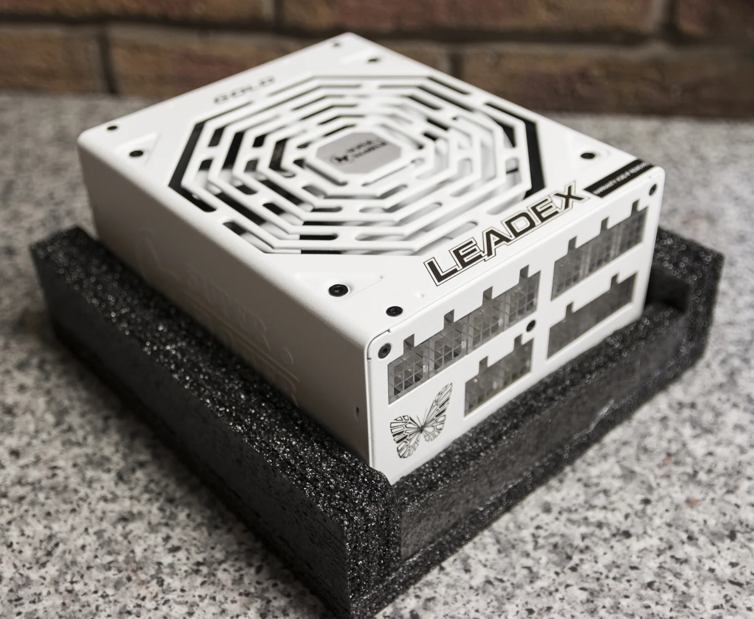

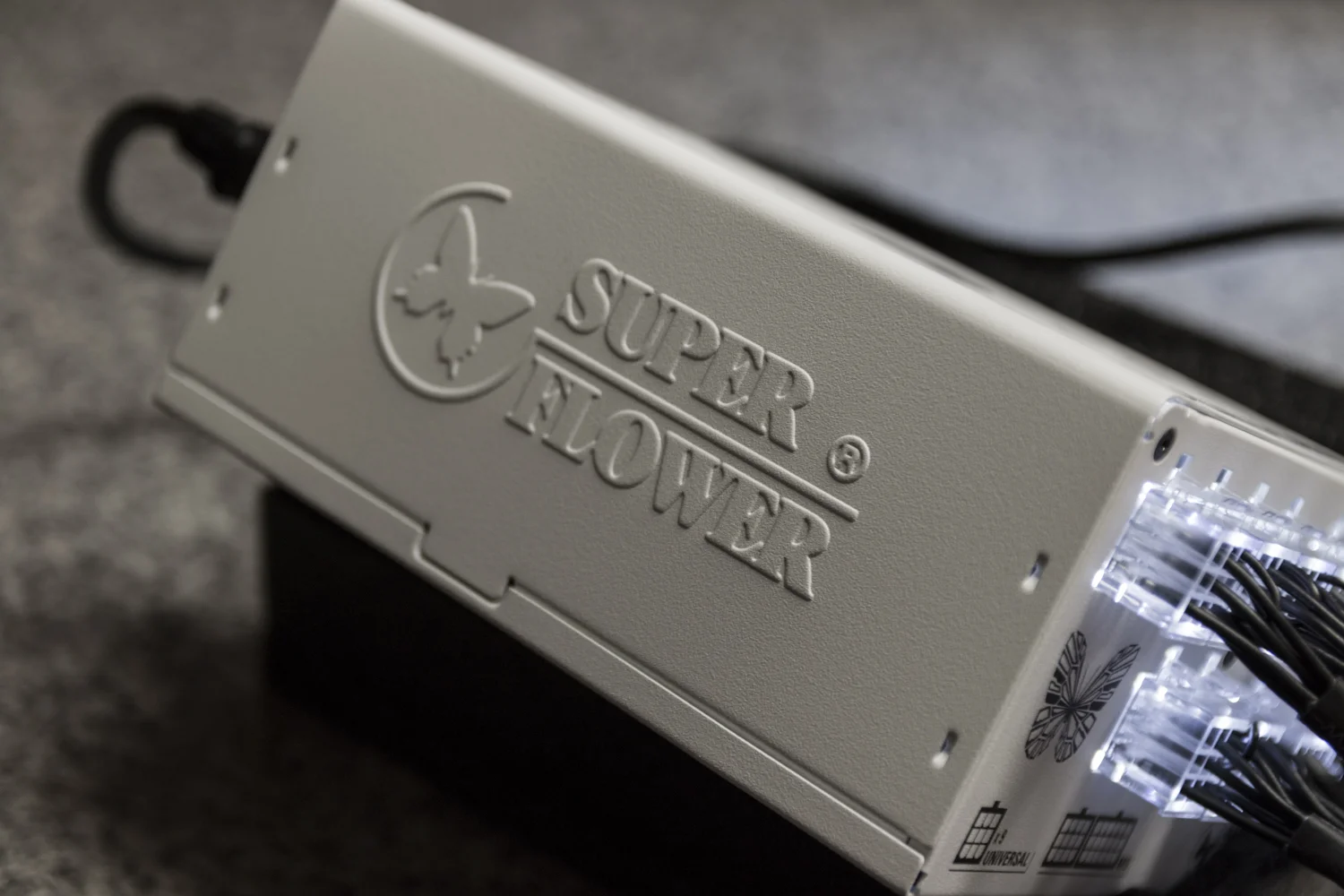

Thank you to OVERCLOCKERS and SuperFlower for providing another PSU. This time around we have a white (sex) 750W GOLD rated LEADEX unit

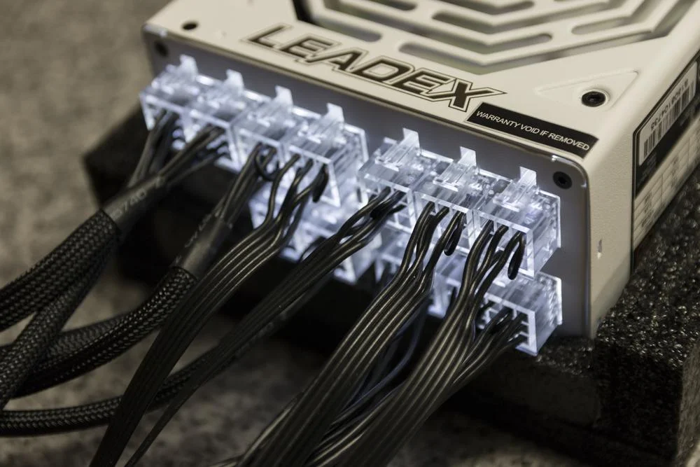

Obvious reason for the LEADEX is for the 9x universal connectors. As I am only using 1 gpu and 1 cpu cable, I have 7 other connectors left for periperhals/ LEDs/ pumps etc and they will be directly wired into the PSU.

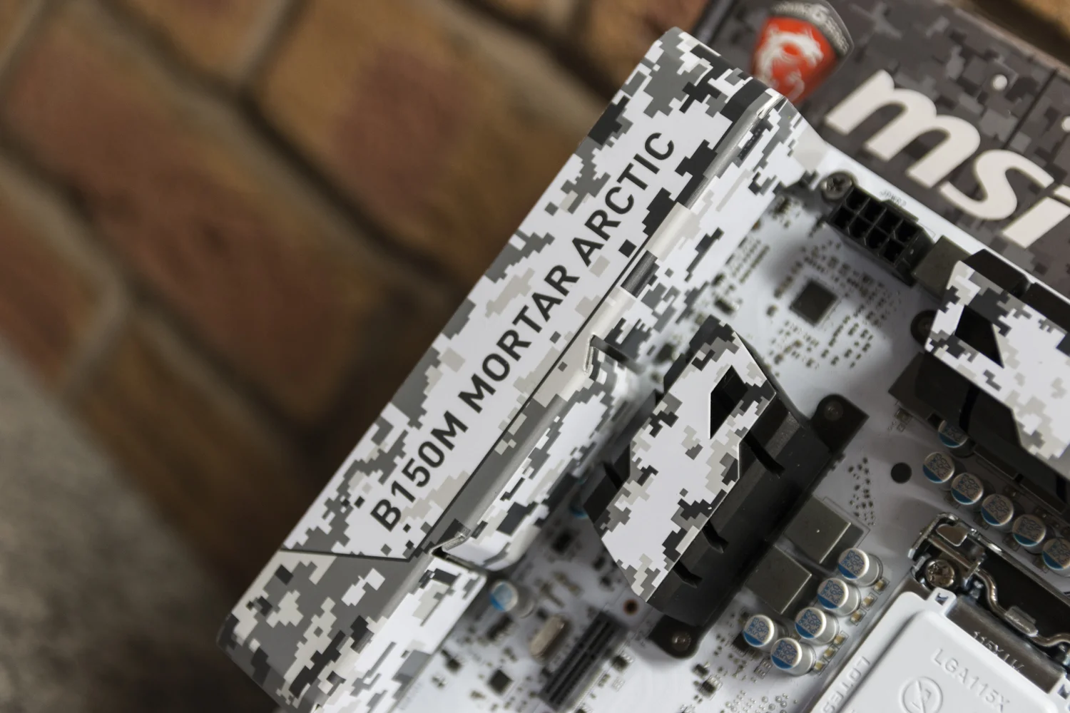

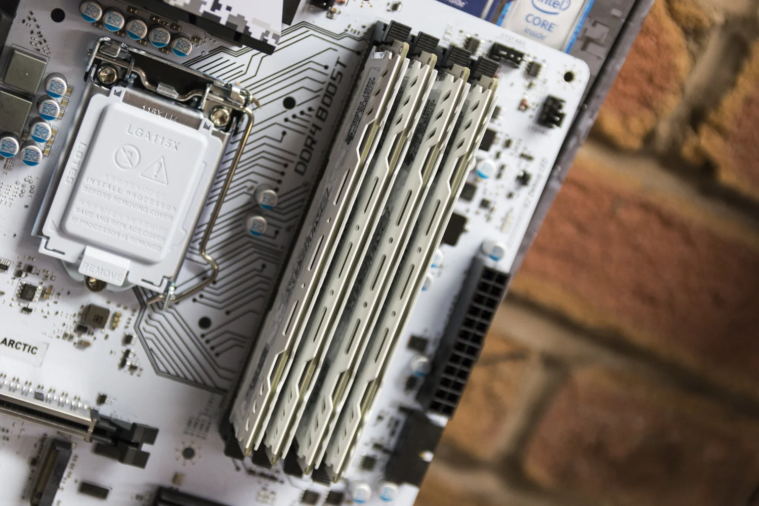

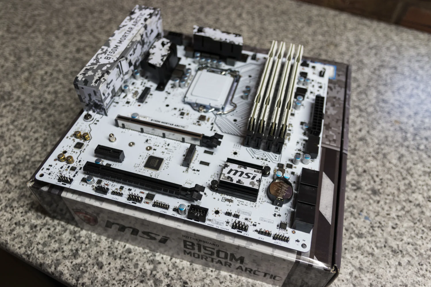

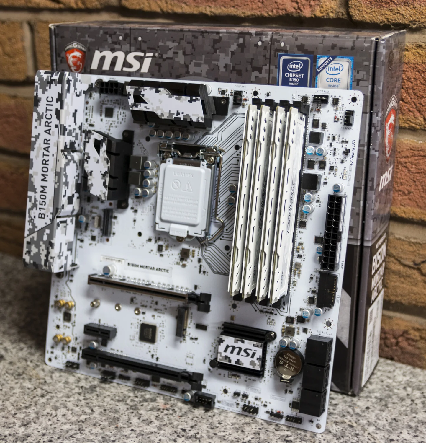

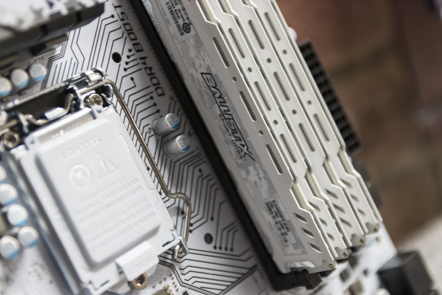

Thank you to MSI for supplying the rock solid B150M Mortar motherboard, as featured in the Fallout 4 build, but this time around we have it in an amazing white// camo styling
RAM used is Crucial Ballistix Sport to go with the white theme. 16GB kit in 4x4gb for a full bank.

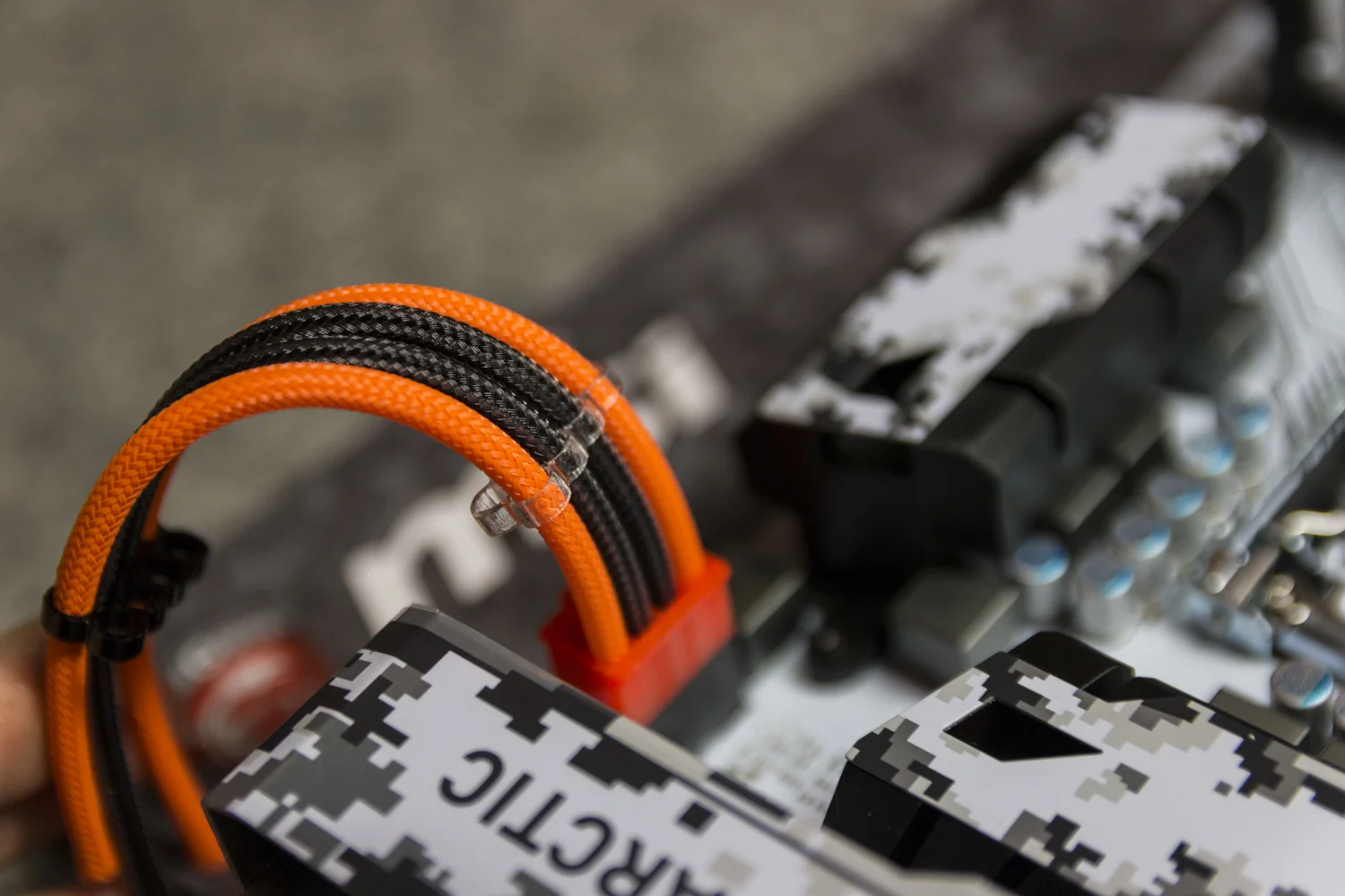

Cabling will be done in Teleios Orange and Fusion Carbon (clear // black) sleeving with orange connectors and white cable combs from E22

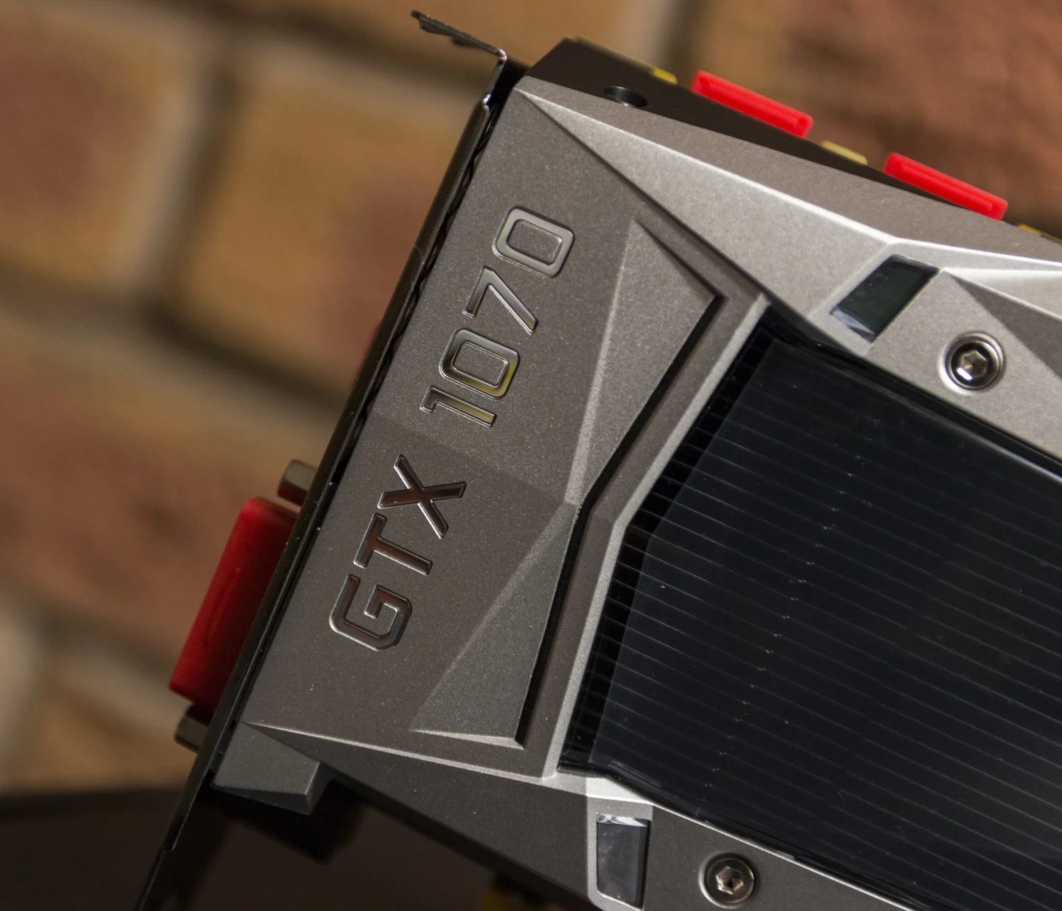

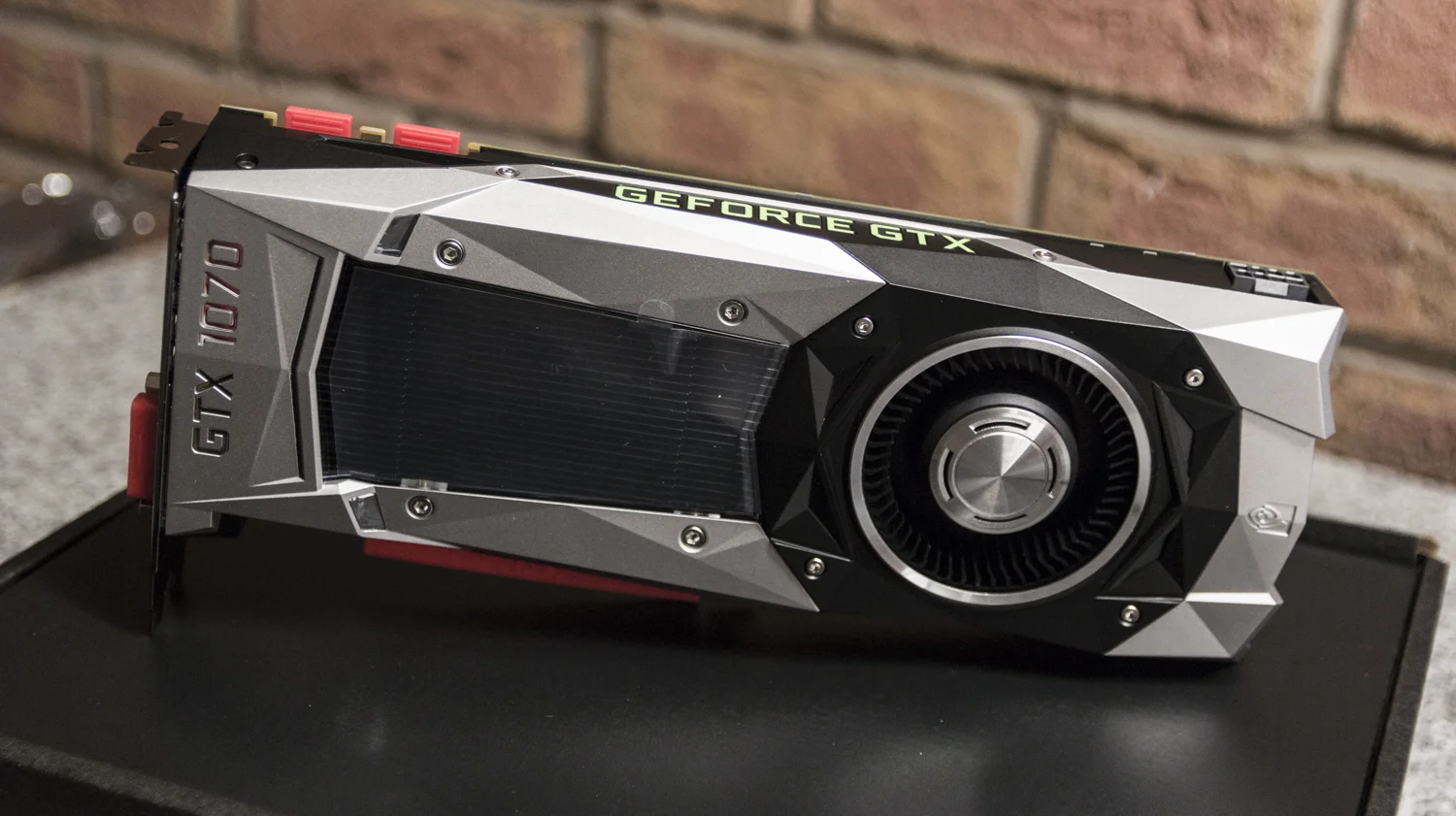

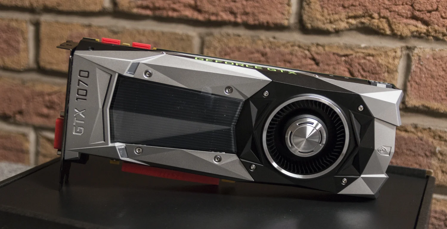

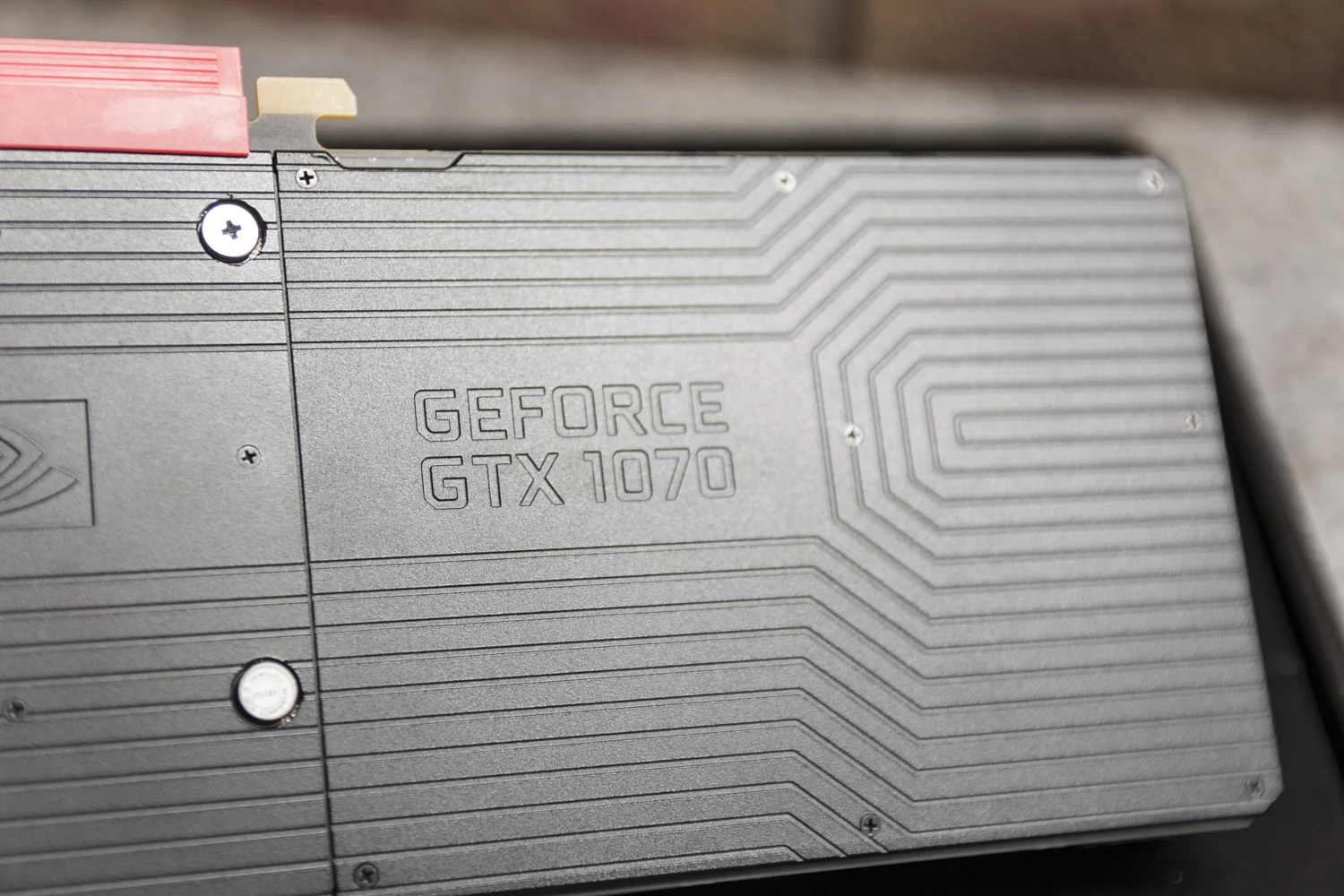

GPU will be an MSI GTX 1070 FE
Its a shame to be watercooling the GPU, that stock cooler is gorgeous

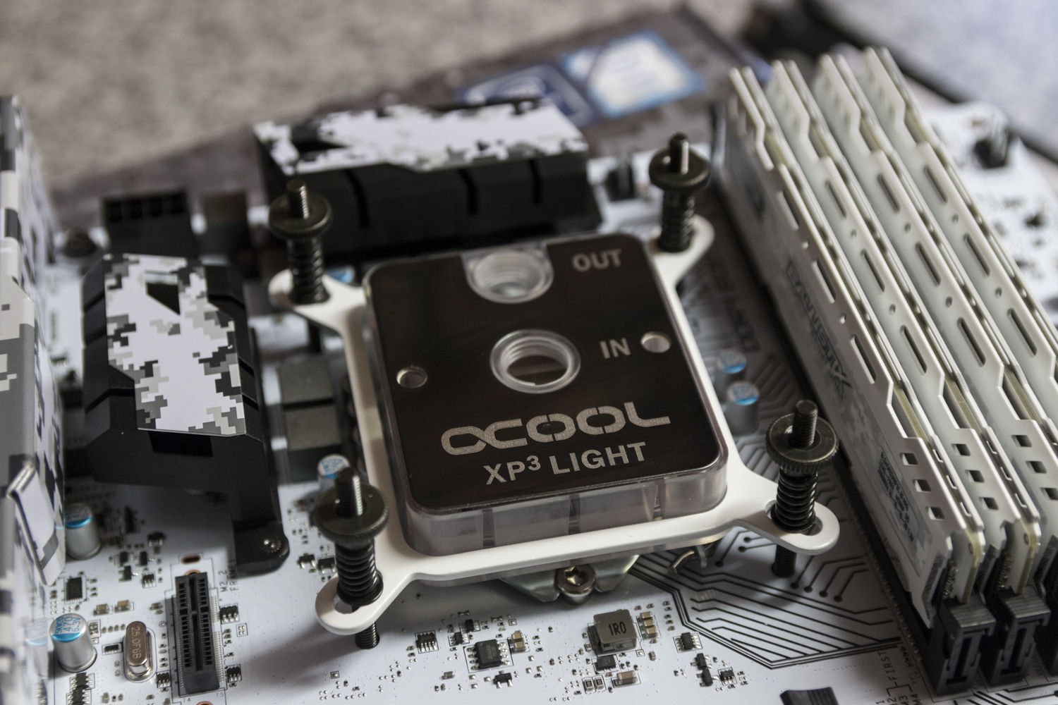

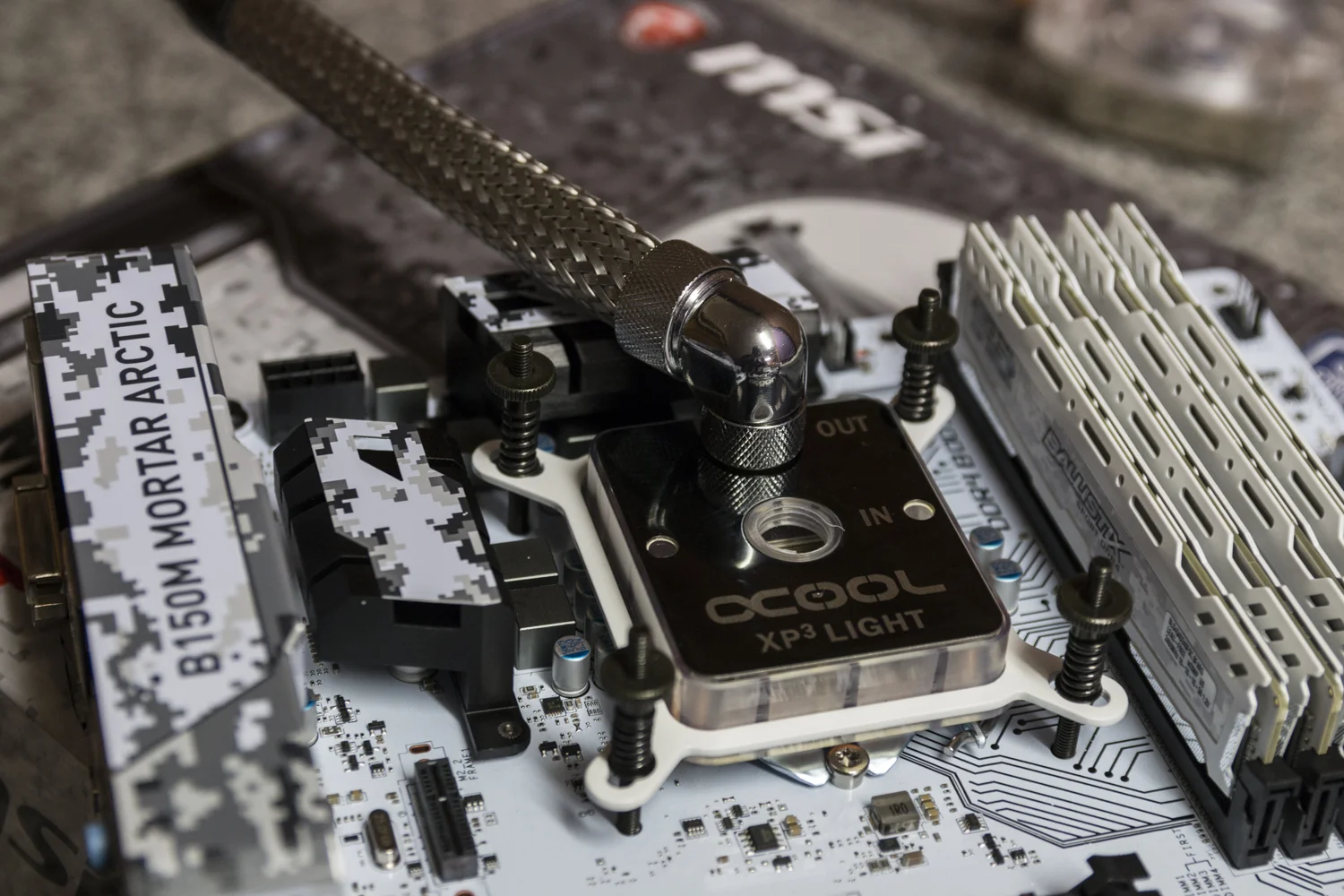

Sprayed up the CPU mounting block with Montana GOLD white spray after sanding off all the powder coating, degreasing and priming
Whats this gonna be then?

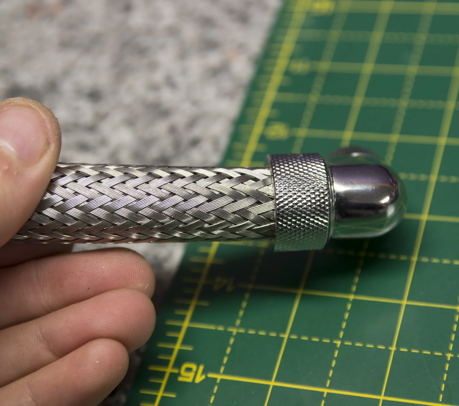

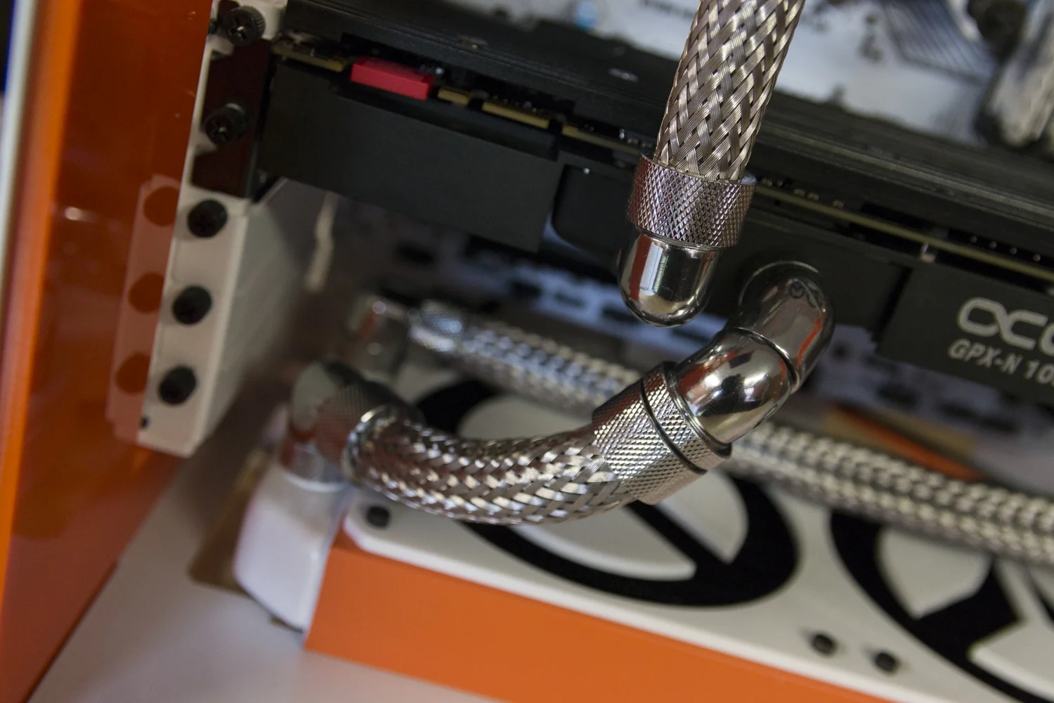

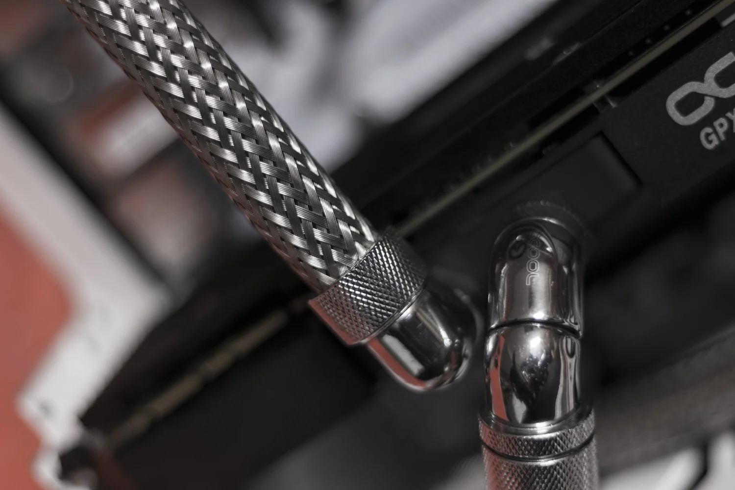

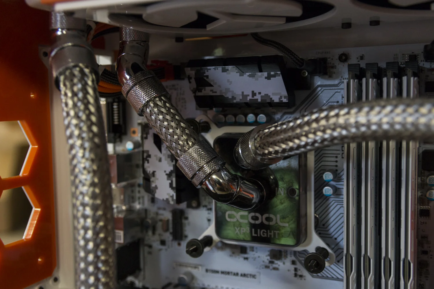

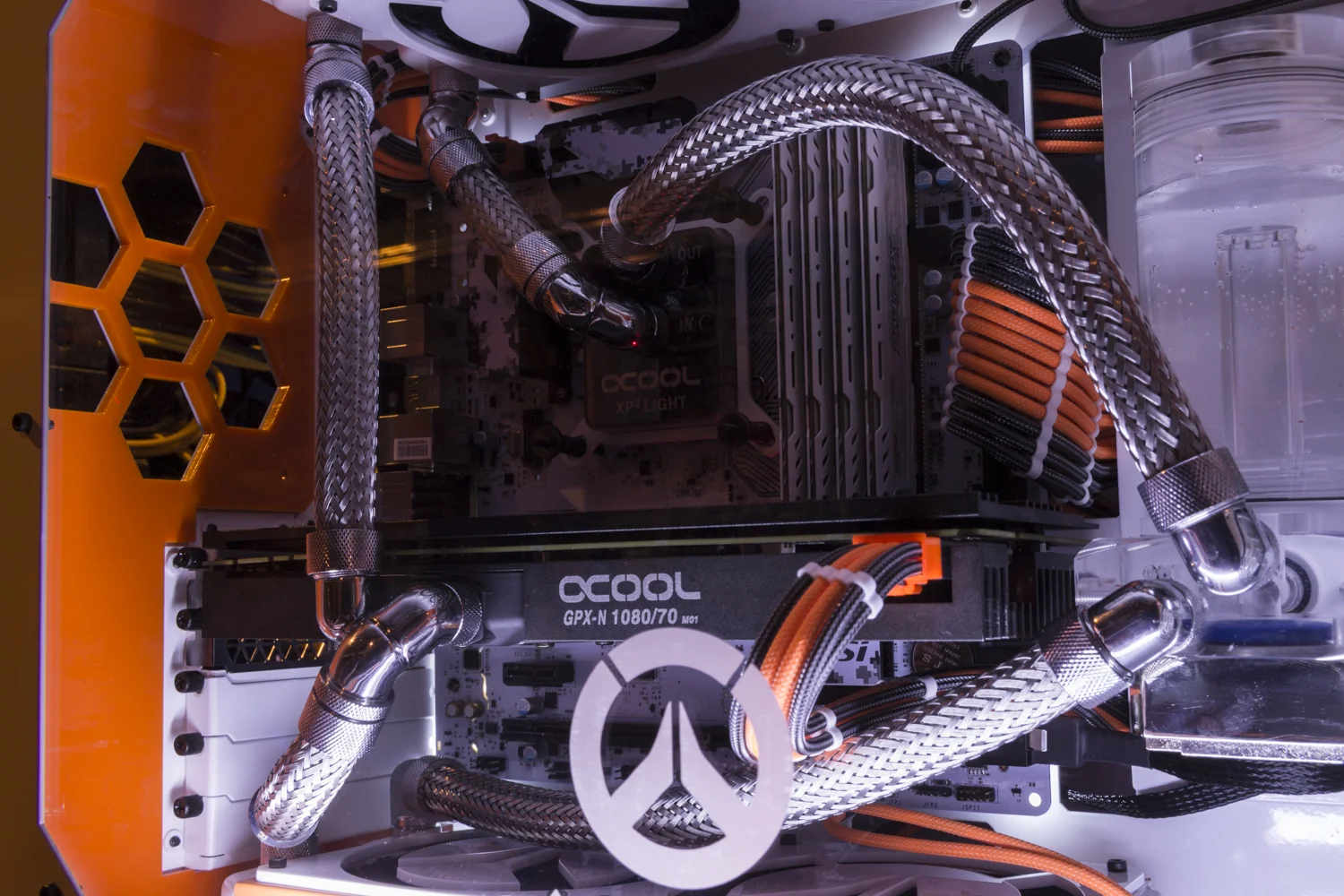

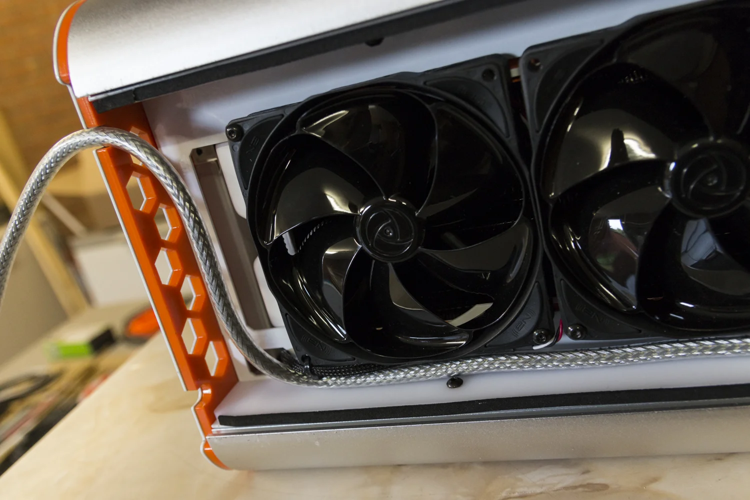

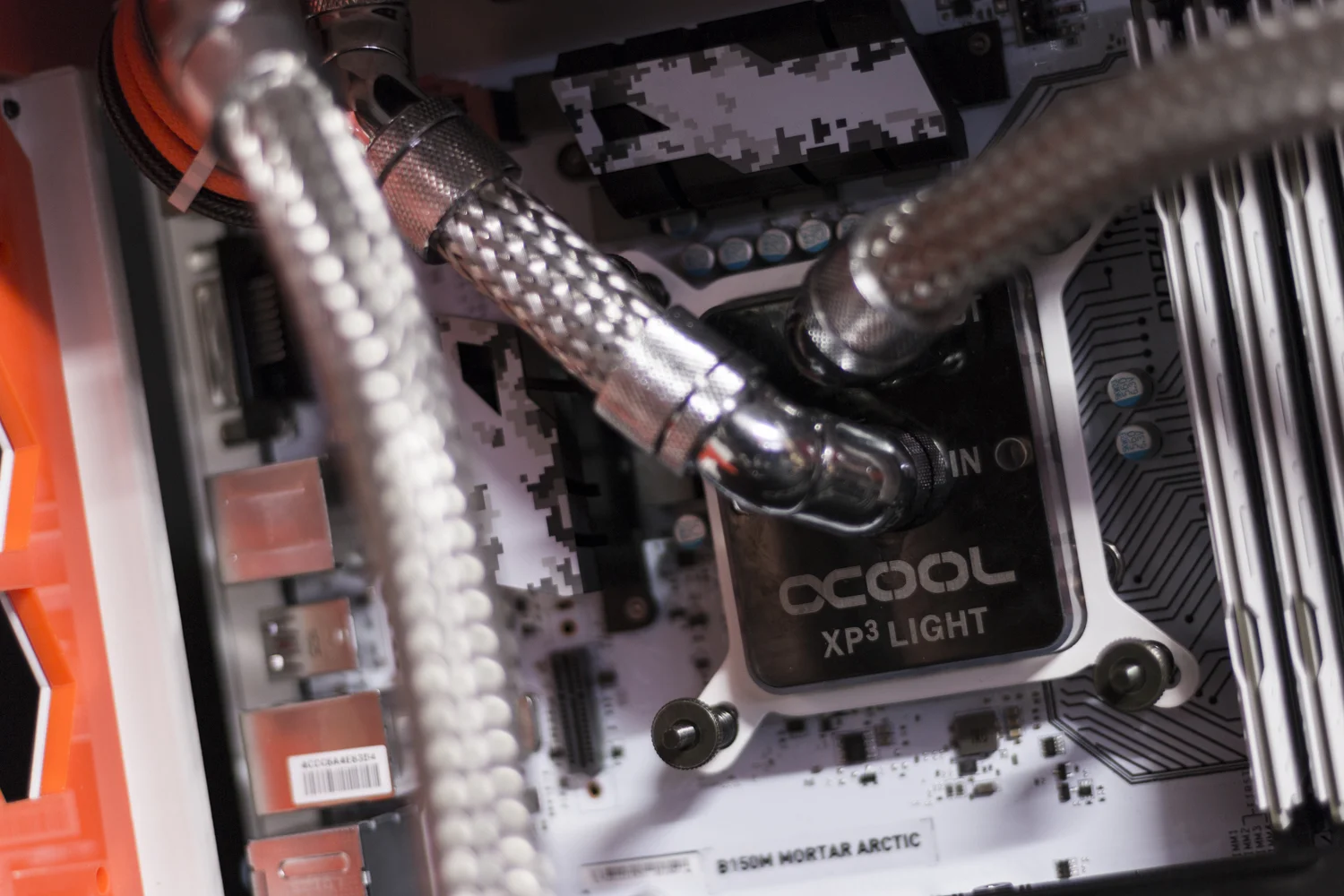

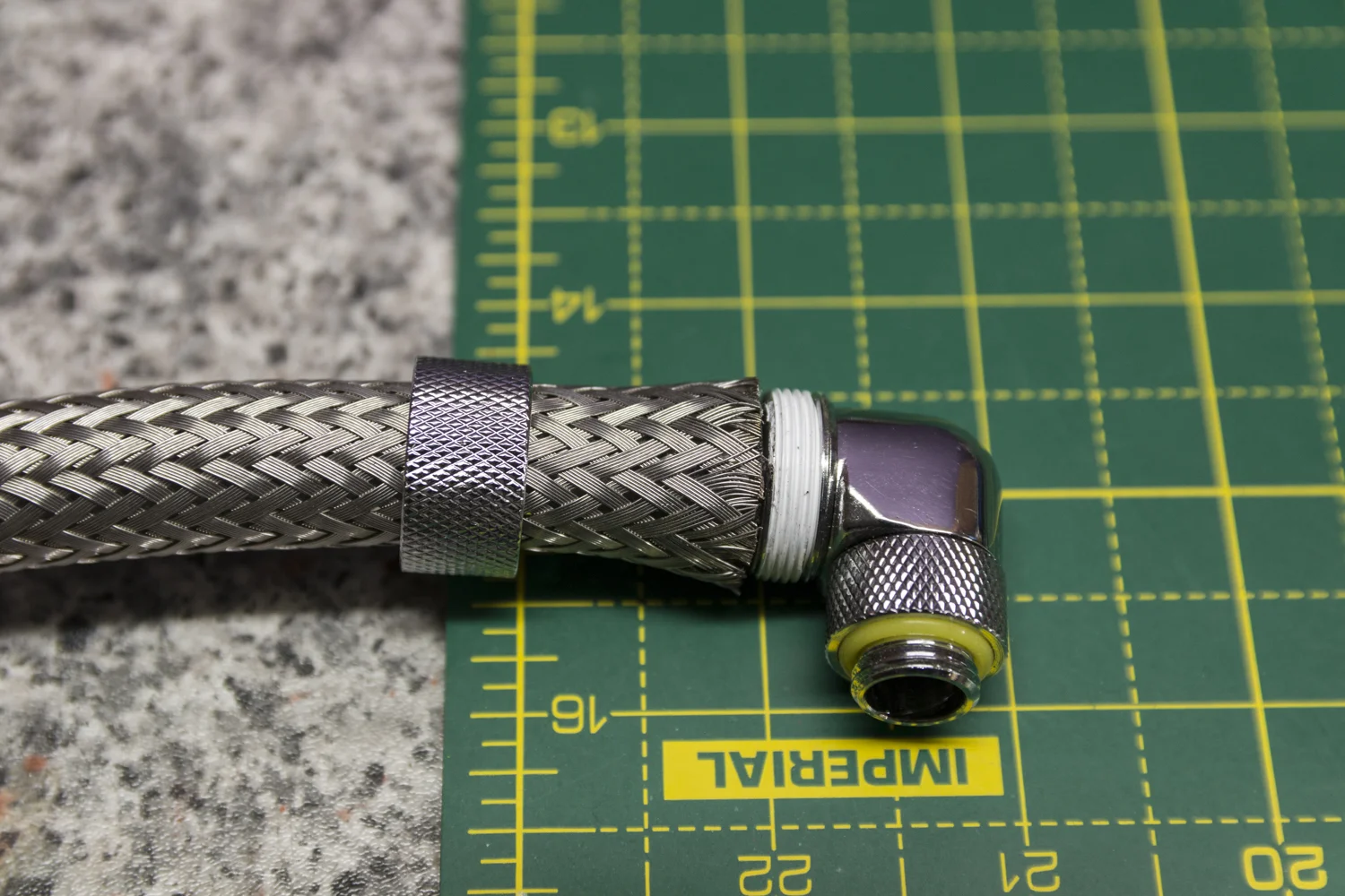

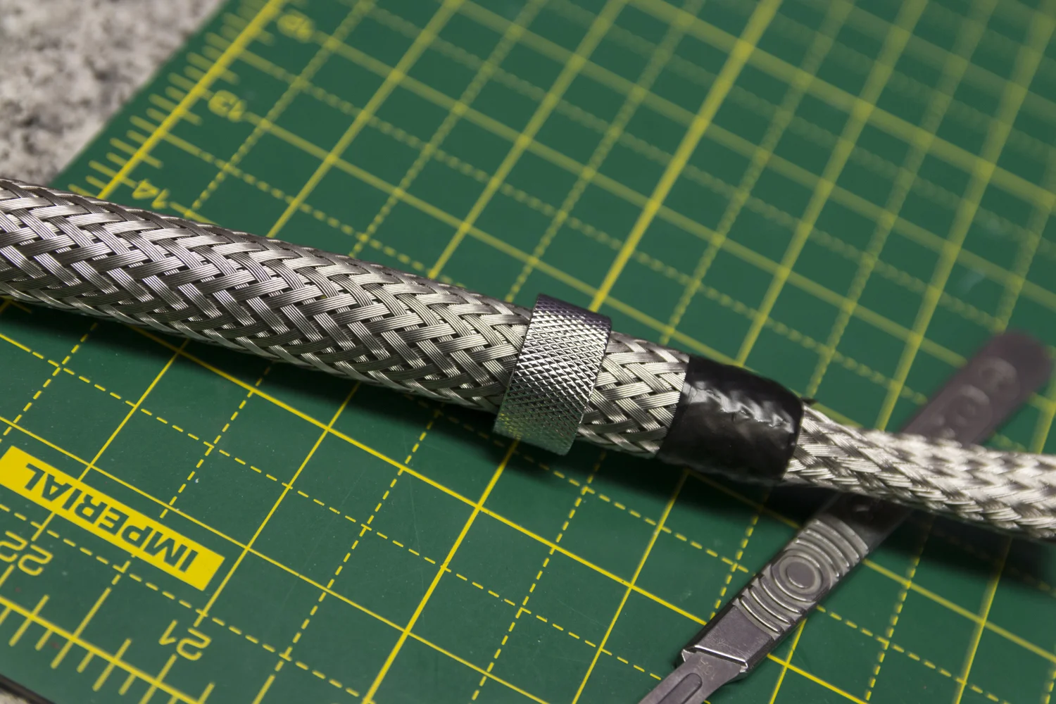

Stainless overbraid on the 16mm x 10mmm tubing; something different as hardline just doesn't do it for me, sorry! :P

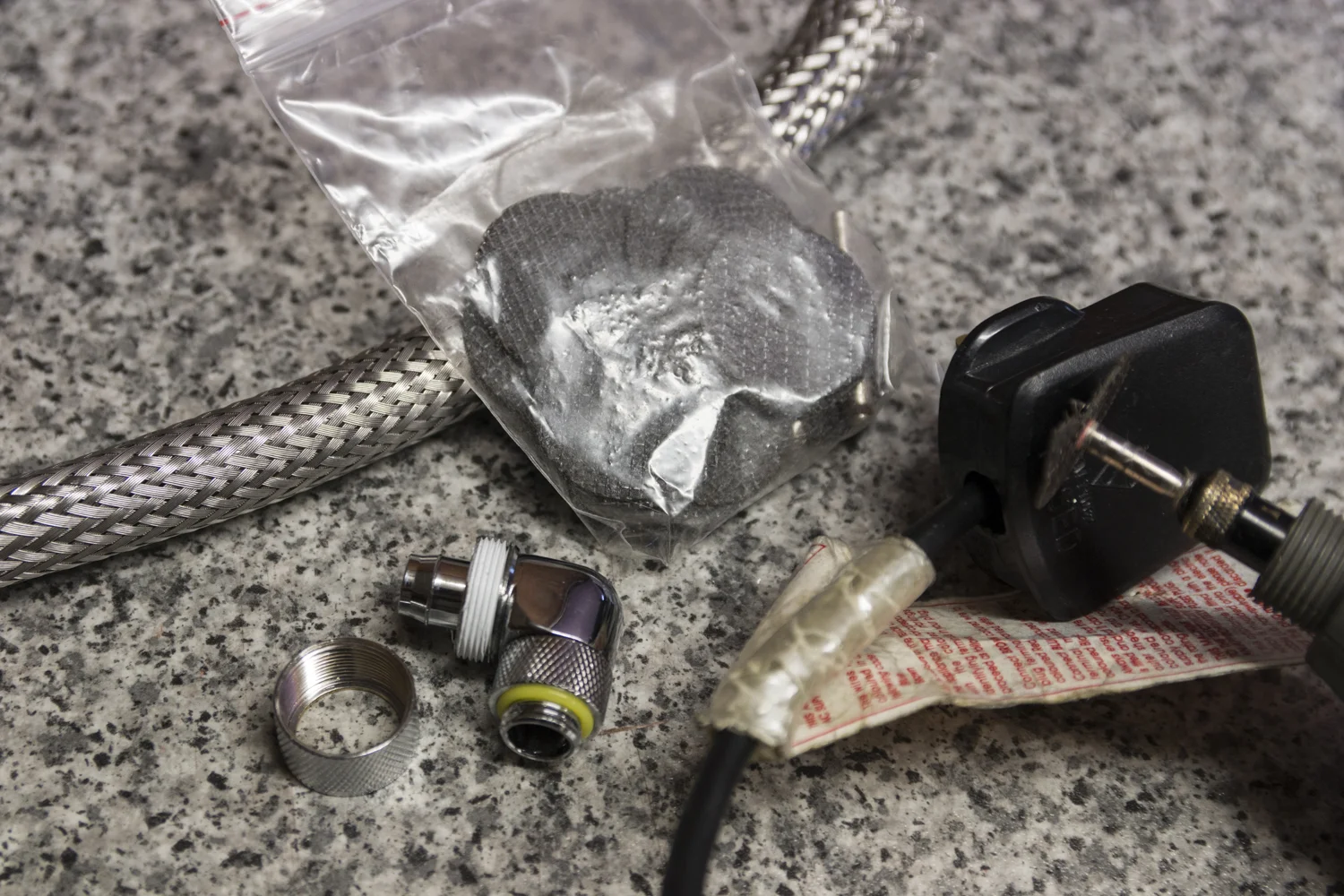

Now. I thought this was going to be a breeze. Oh how wrong I was. Stainless is a PITA to work with. I've welded it before, its a pain. Cutting it with a chop saw takes ages, its a pig to work with but it looks balla. The tubing is cut to size, the stainless overbraid is threaded on to the tubing. Now, you need to cut excess. ànd apply tape to the ends. The collars// compression rings must be applied before cutting as seen later. I found that using a deburring tool on the collar helps so much. I use a 'shaviv
branded tool and it works a treat.
The stainless steel overbraid is cut with dremel cut off wheel. Slow speed, patience and good quality blades are a must.
PTFE tape on the thread stops anything gunking up, the braid fouling or flash getting stuck.
Prepare for GNARLY fingers and no finger prints trying to get the braid on without stabbing yourself. Again, taking my time helped, patience is a virtue. You HAVE to hold the fitting and not the tubing, if you move the tubing, you will get pulls, frays and the tubing will slip and cause bumpy bits and just look narstie with crossed braid.

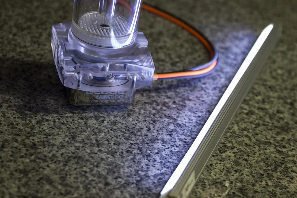

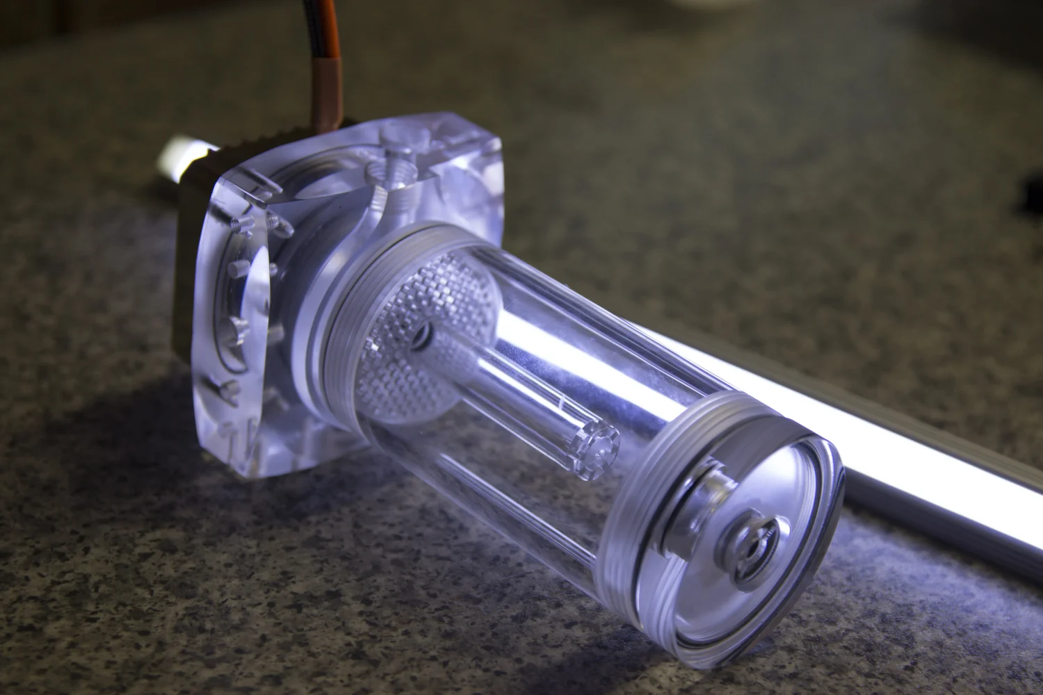

Also made up a nifty little LED strip with some extruded aluminium profile and clear// trans diffuser. Cool white LEDs are going to suit this best. Orange will bleach too much.

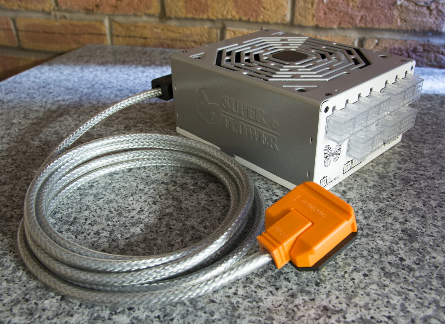

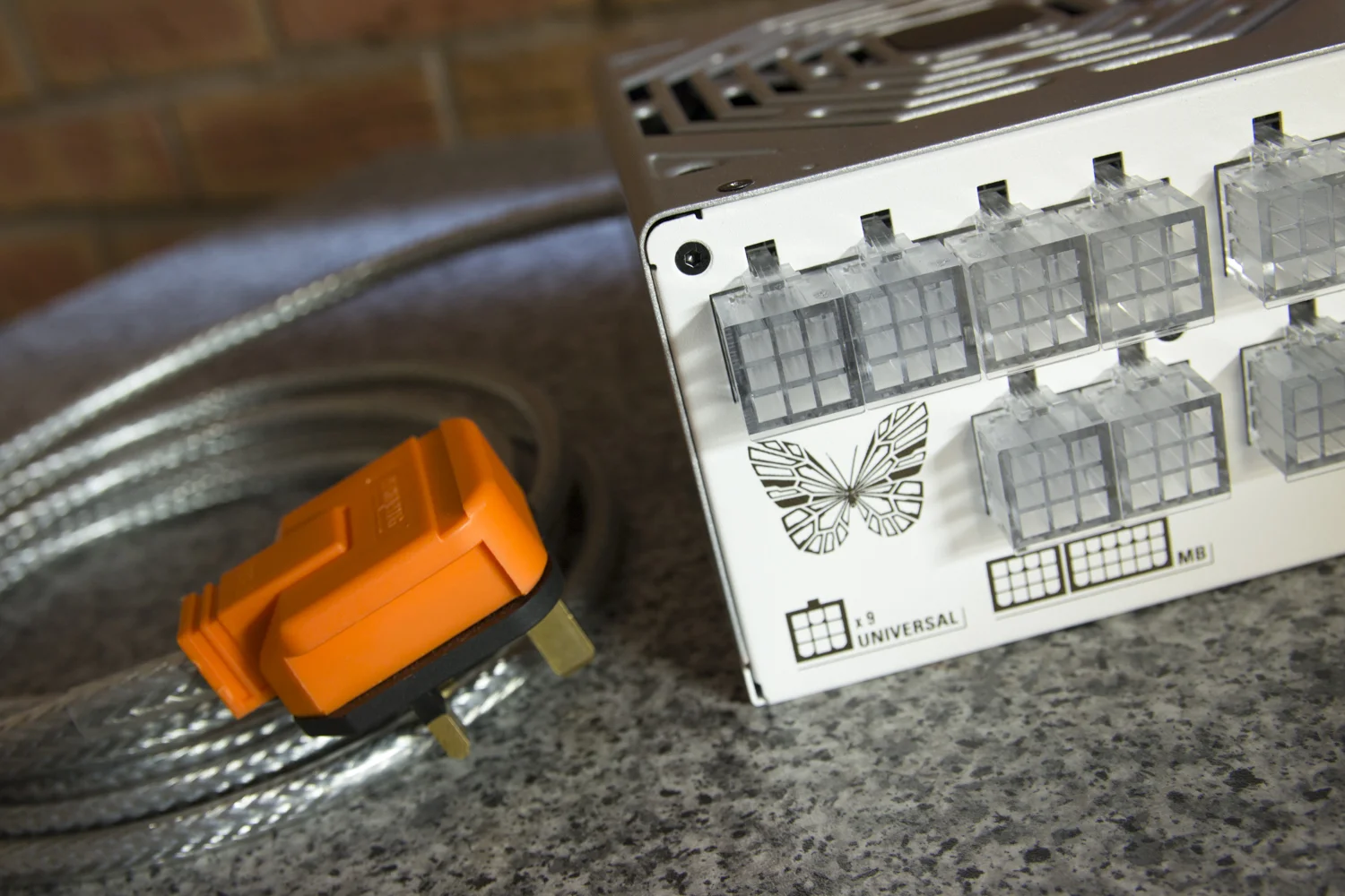

I also knocked up a lovely IEC C13 cable with a sturdy 3 pin orange plug and Arctic Grade 1mm SY cable (3 core).

That stainless steel overbraid :eek: made me think of a criss-cross stainless steel backplate over the GPU waterblock, to match it. Don't know what you think of the idea.

the Alphacool res-block looks amazing when all 4 LED ports are used! only used one side and gutted i didnt do both sides. shows off the path a treat and can quite happily turn off all the lights and just have that lit up !

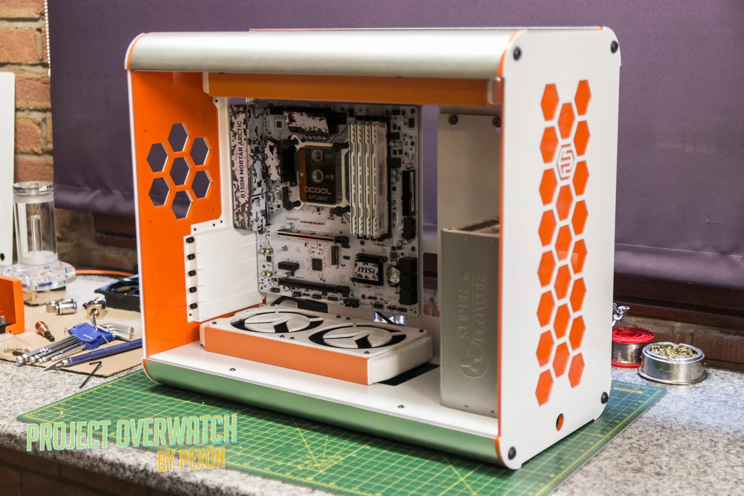

Bit of a jump forward, but, it has to be done before LAN, so here goes...

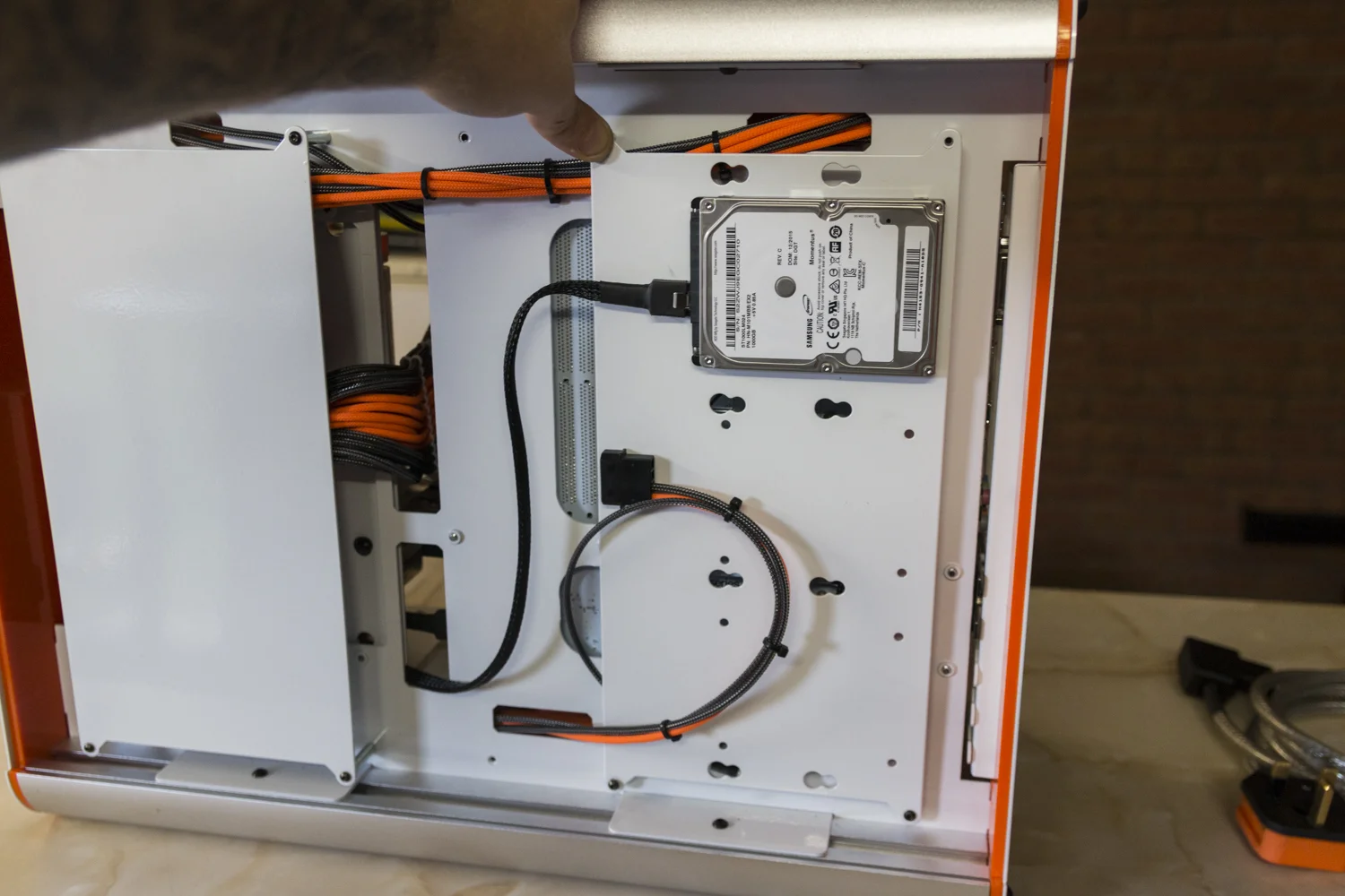

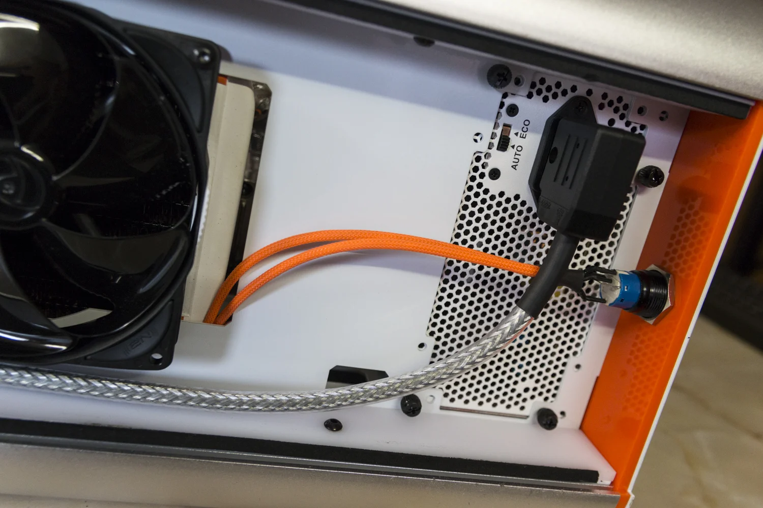

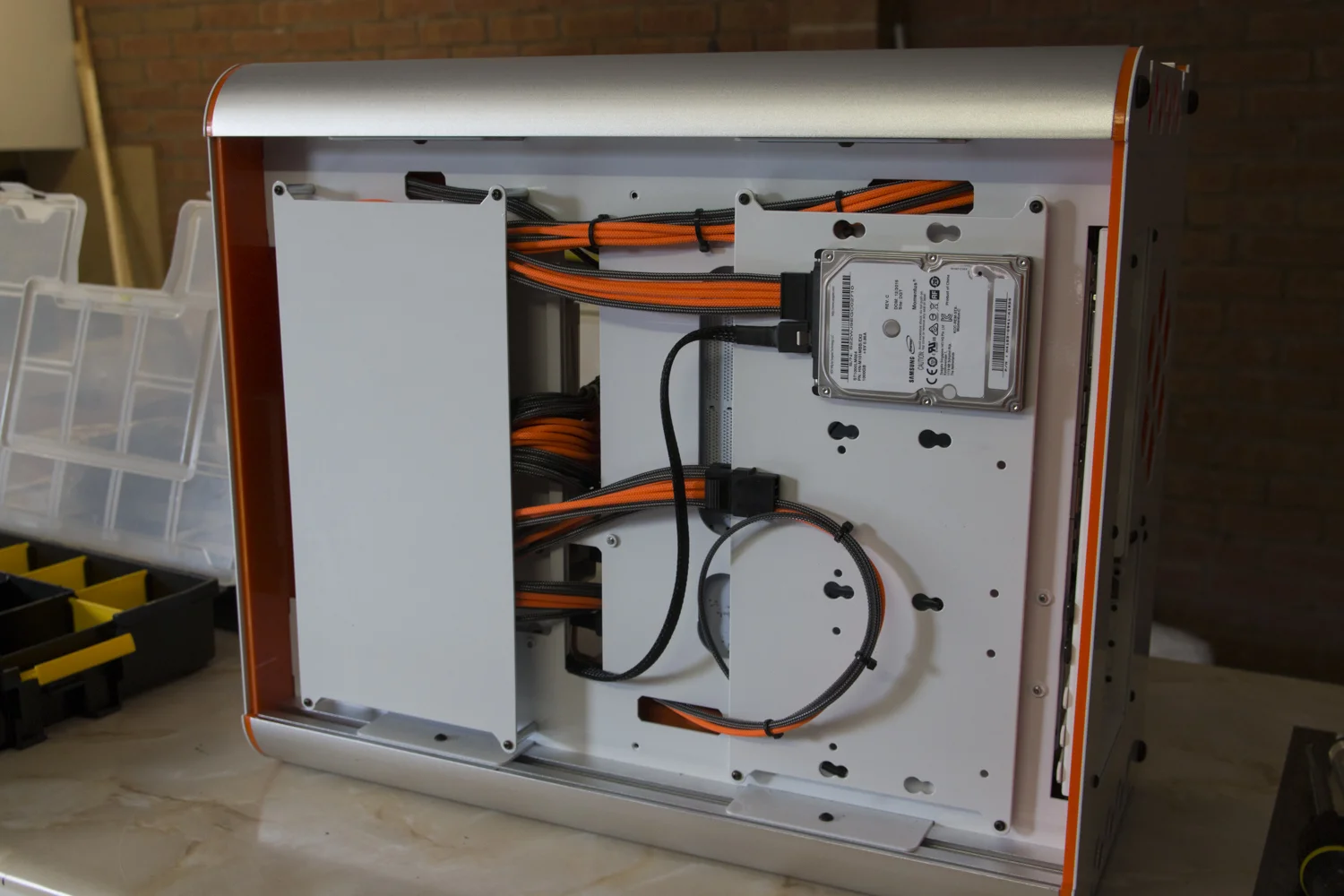

The rear panel is finished, bar 2 molex cables and 1 SATA power cable that I will be making up tomorrow, nice and clean

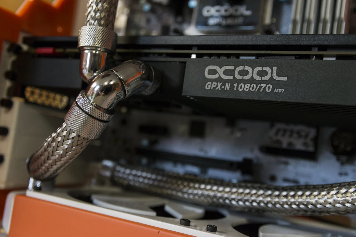

Waterblock and backplate fitted and installed, look pretty good actually. If I had time, I would have done them orange, silver or white, but times against us
Shhh... dont tell. I ordered a right angled IEC connector, not a left, so I had to remake it :3

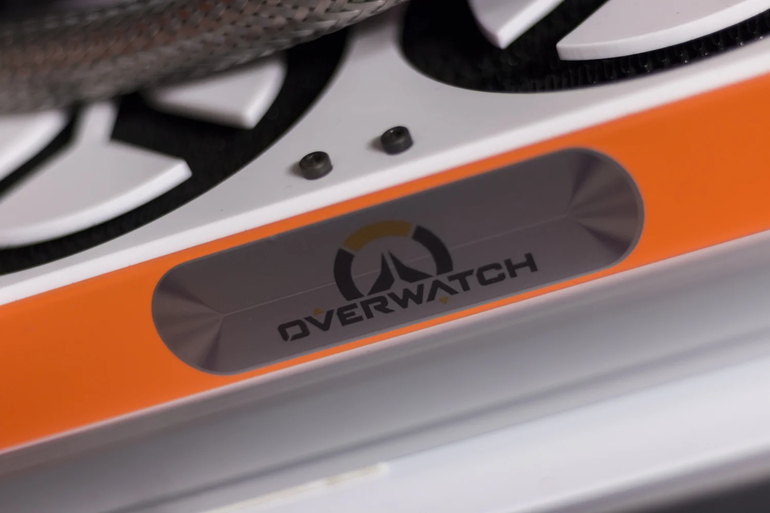

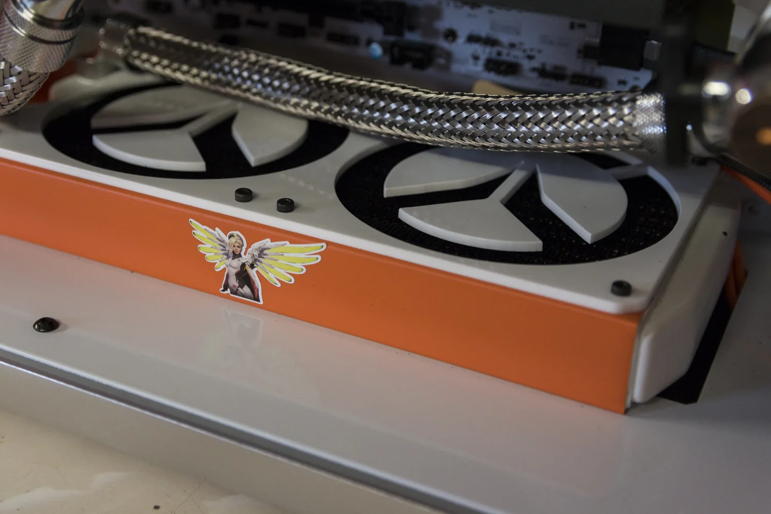

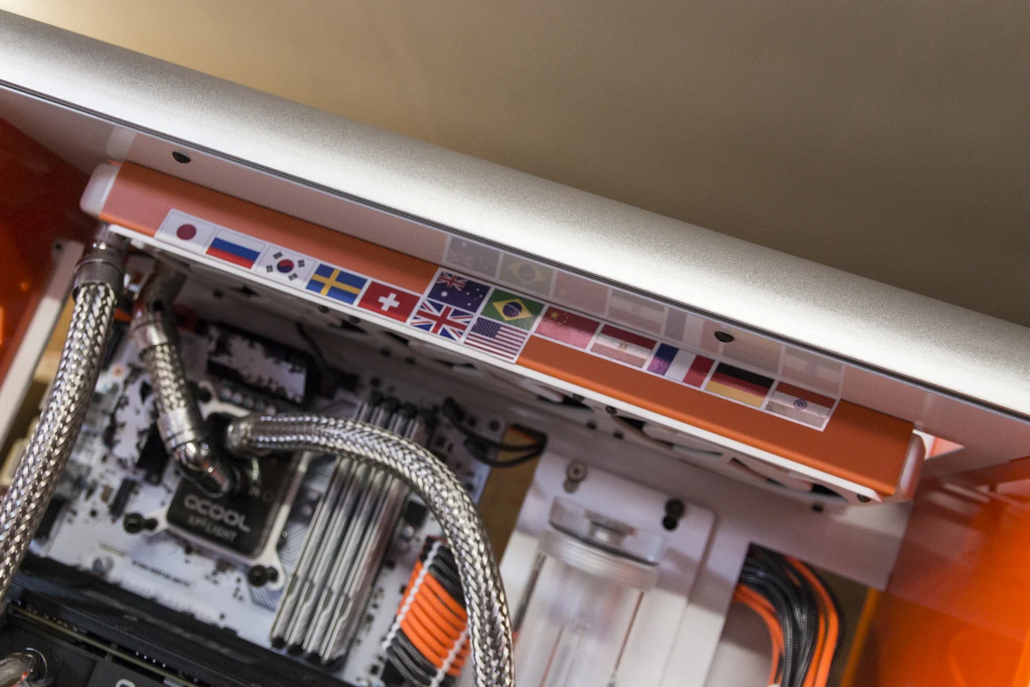

Also, have a little logo sticker on silver vinyl schemed up . Mercy outline in chrome effect with the overwatch logo. Same goes for the top rad sticker, with all the champ related origin flags. White will be swapped for silver on the background, I think that is going to look sweet!

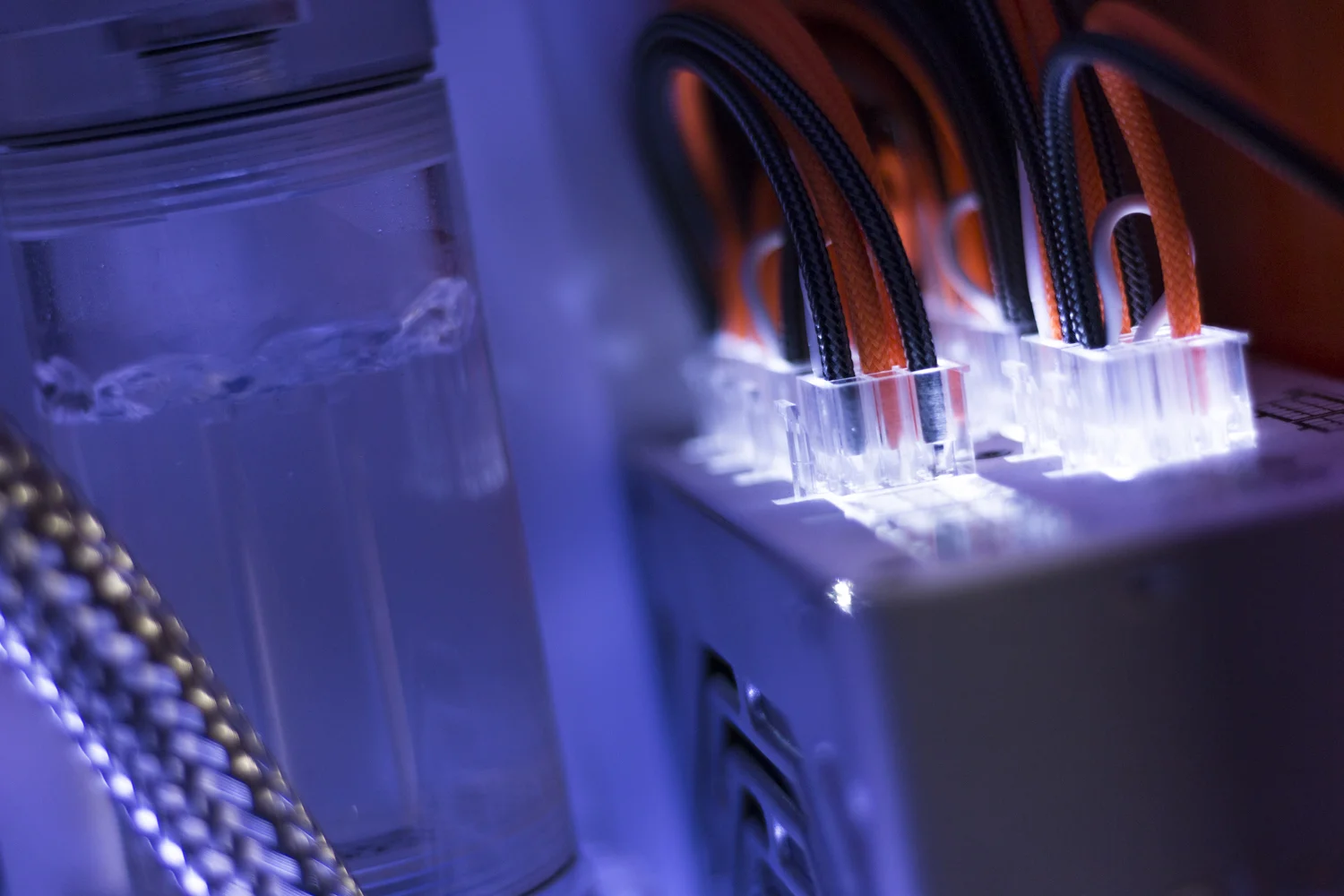

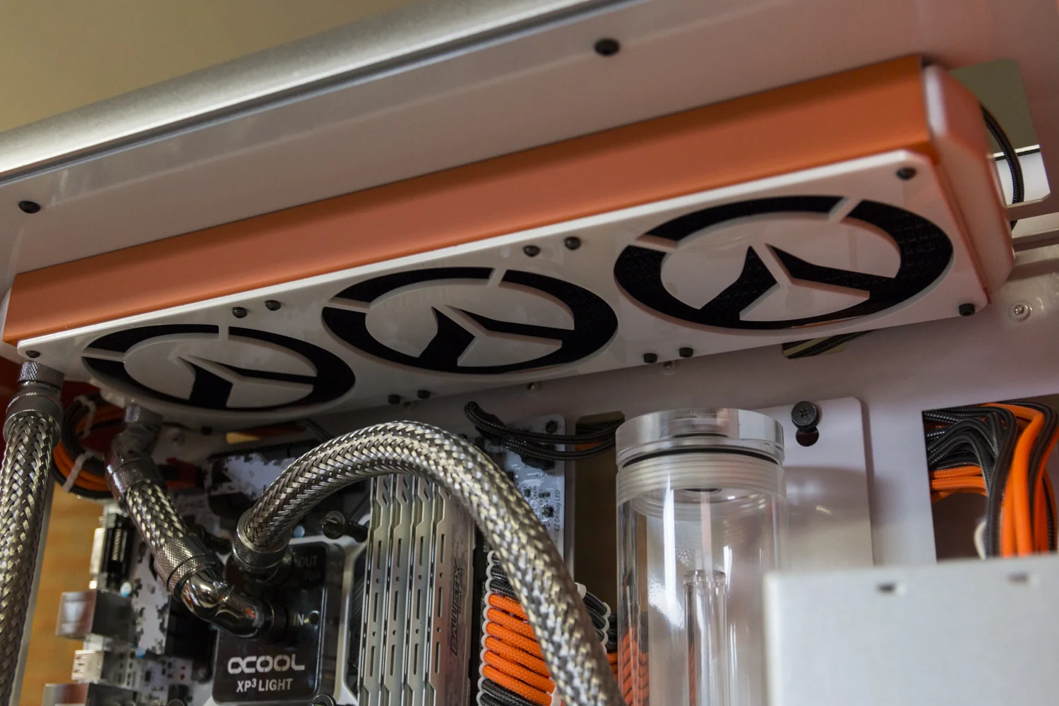

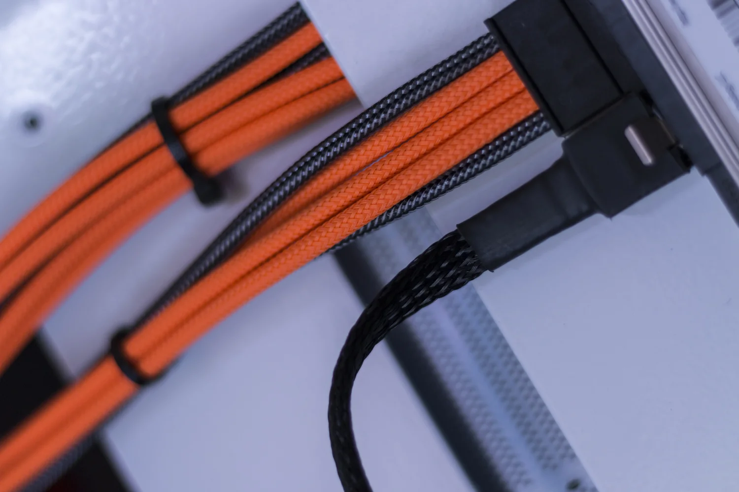

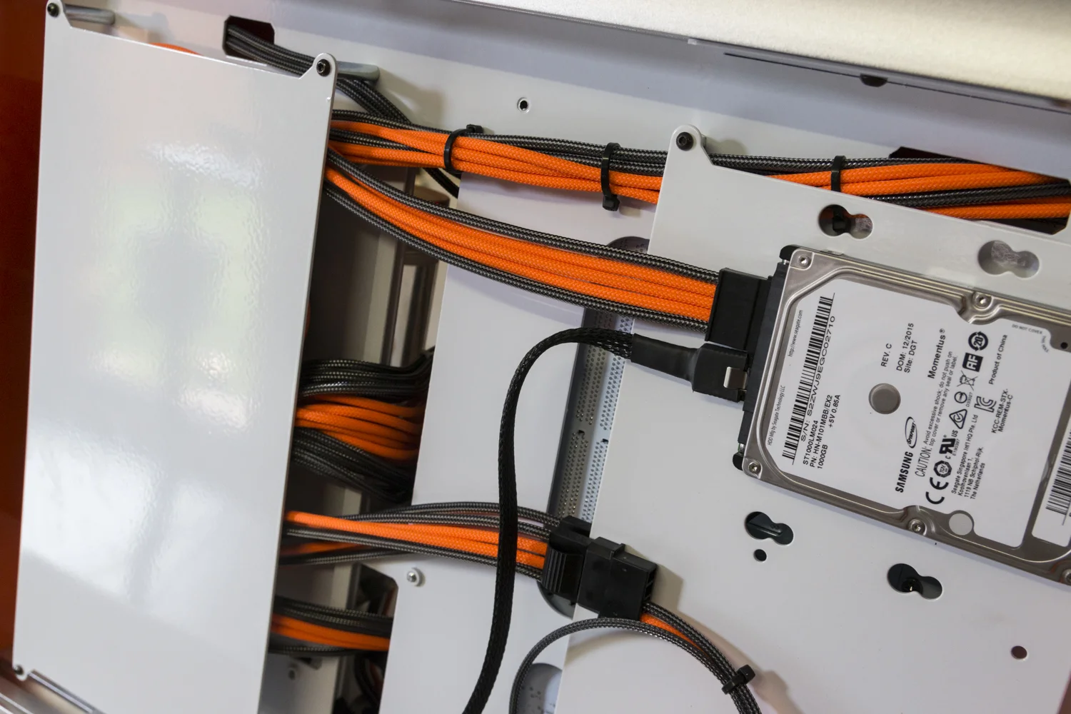

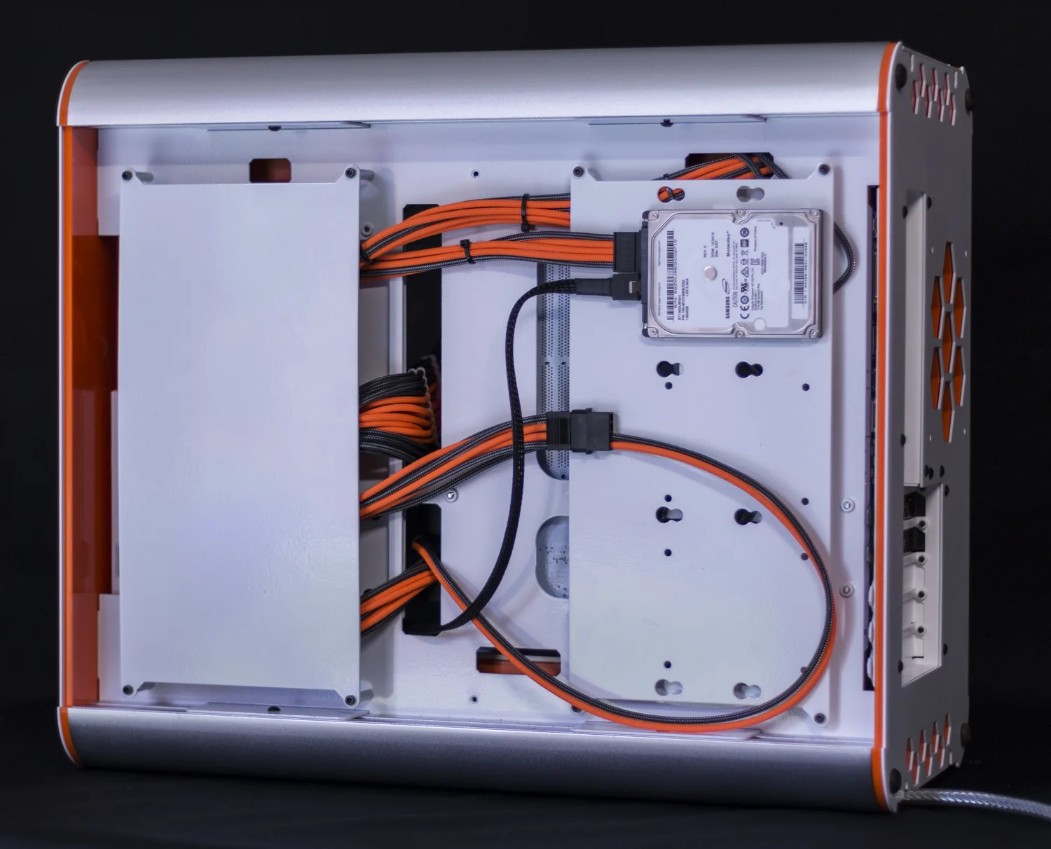

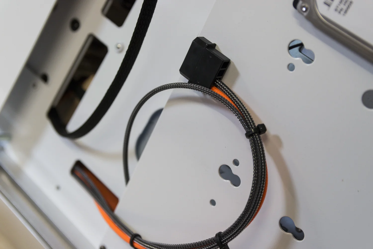

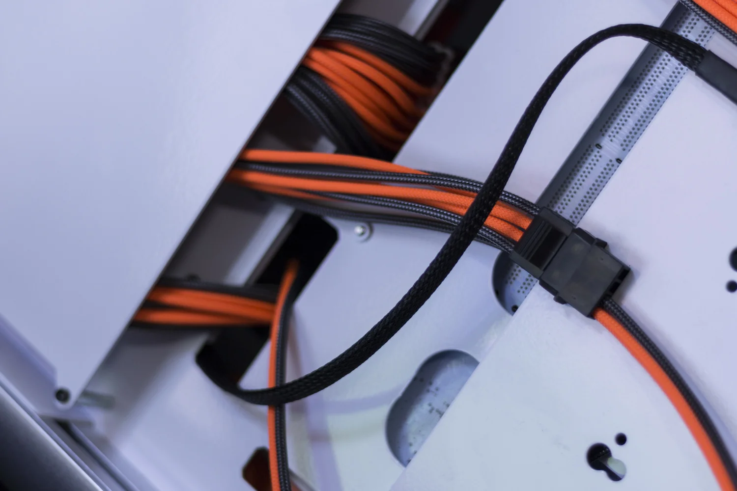

The builds cables all finished up in orange and carbon fusion Teleios. As there weren't many fans, I decided to knock up some splitters and pop them behind the blanking panels
Some black cable ties blended in well, so I didn't use the stainless steel ones, perhaps another time....

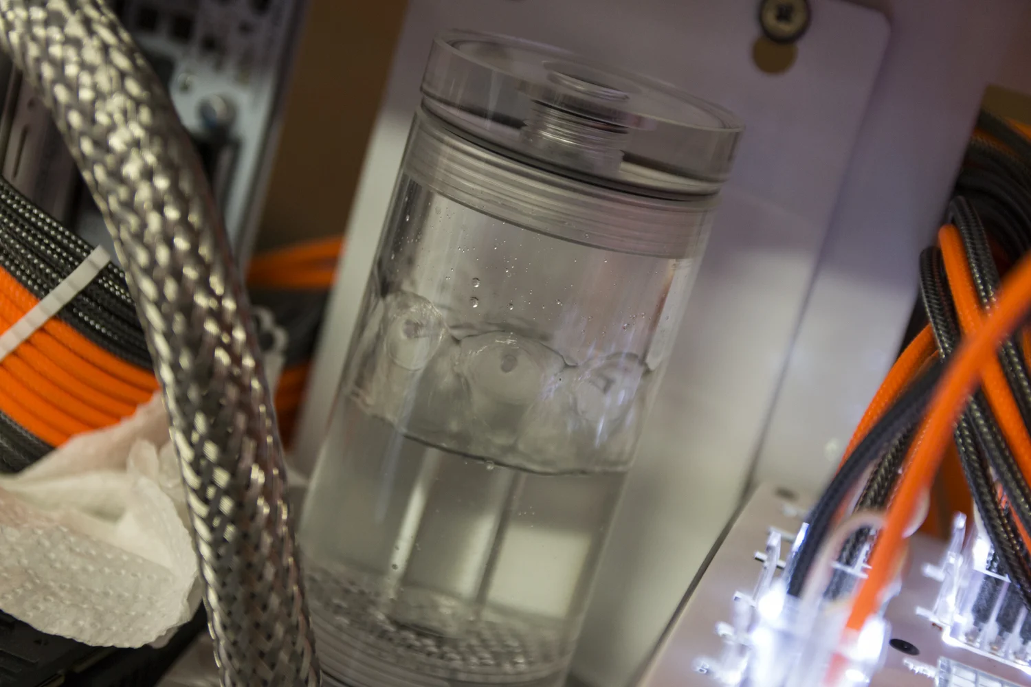

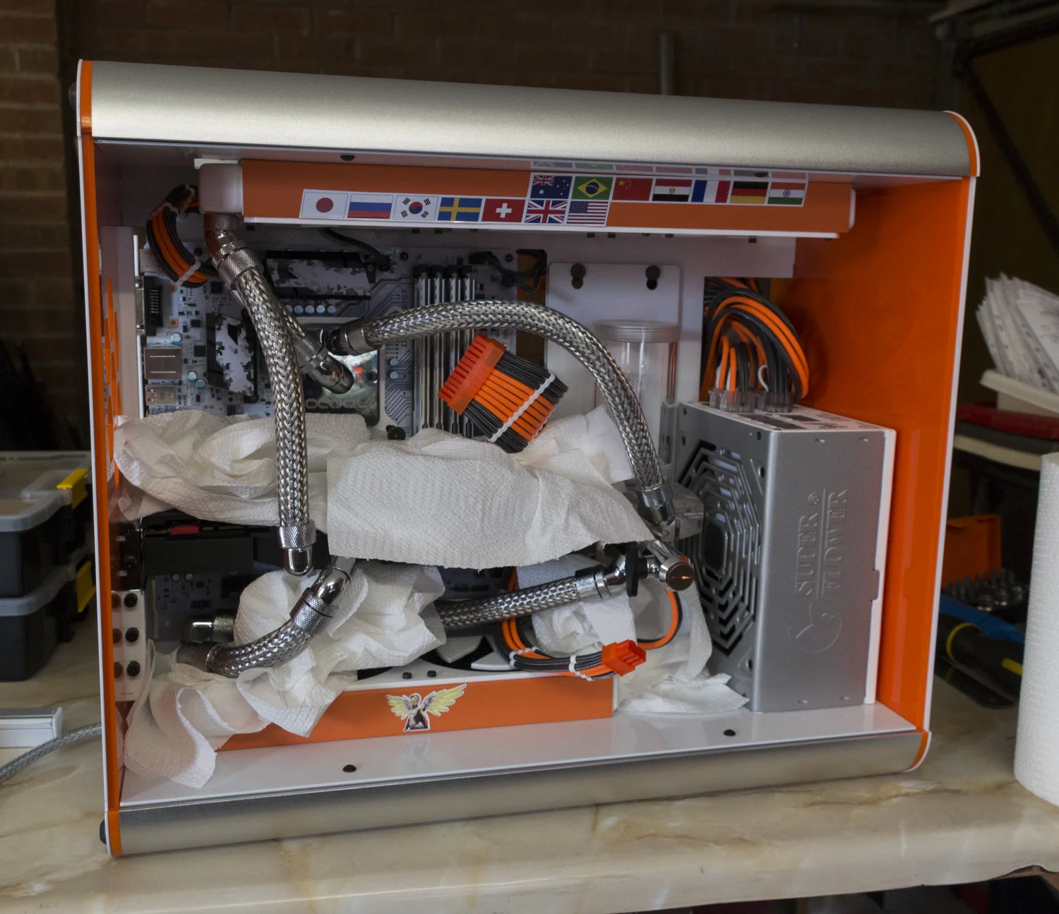

It DIDNT leak! :D
But you have to be sure

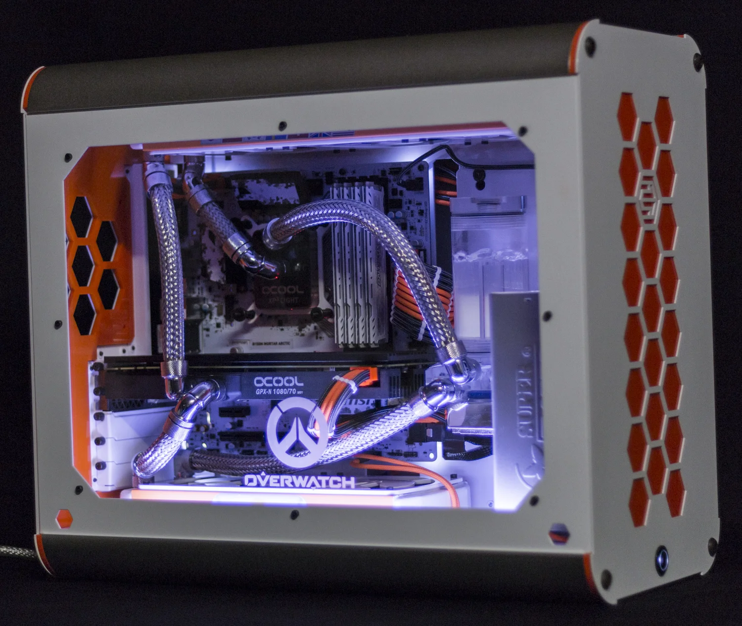

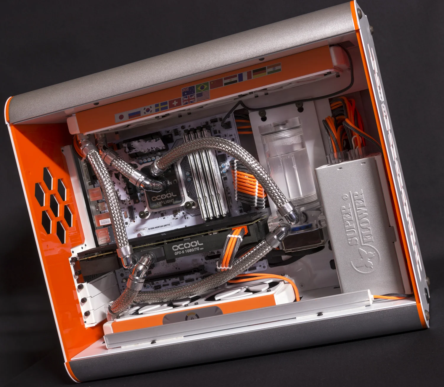

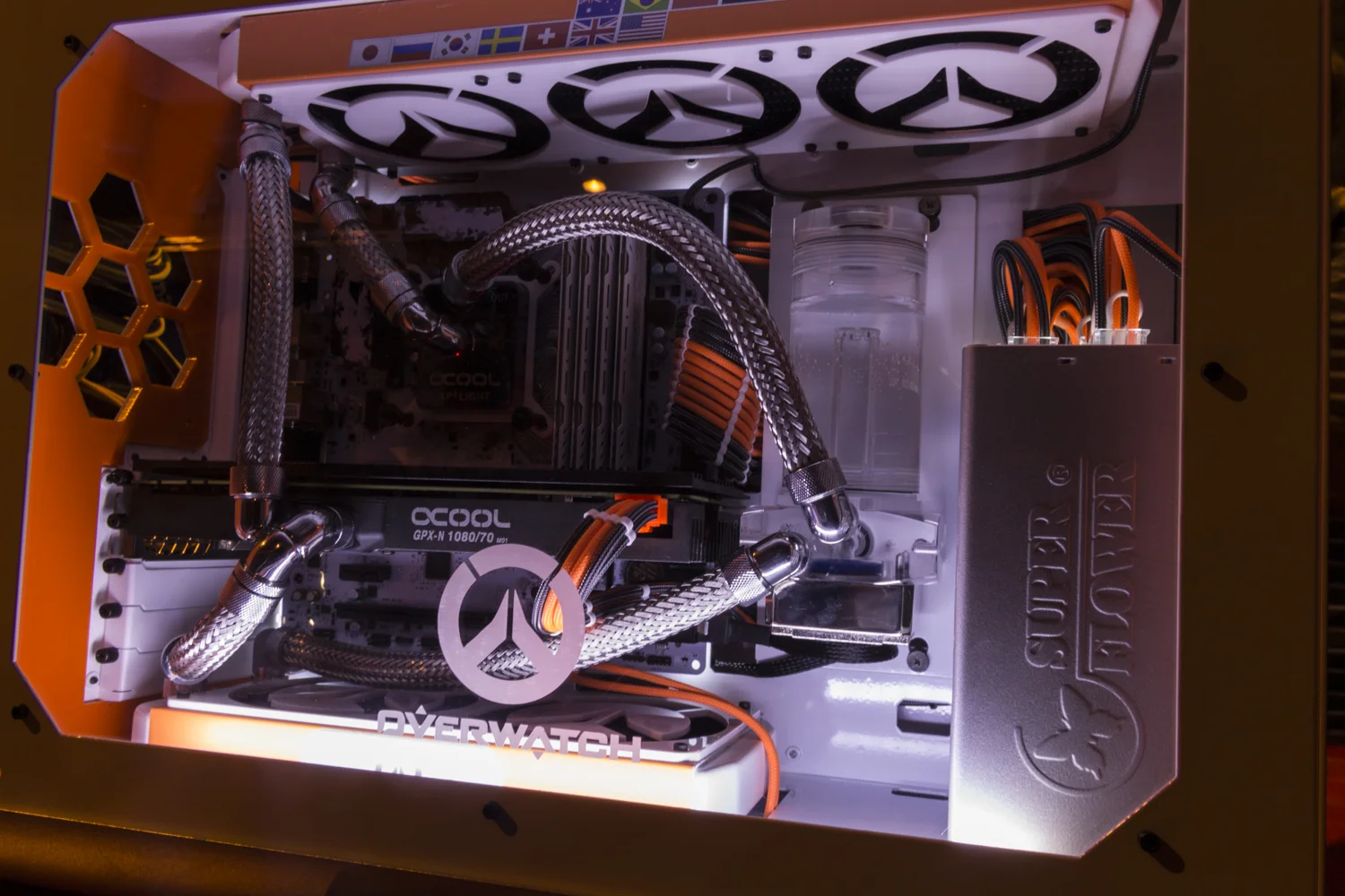

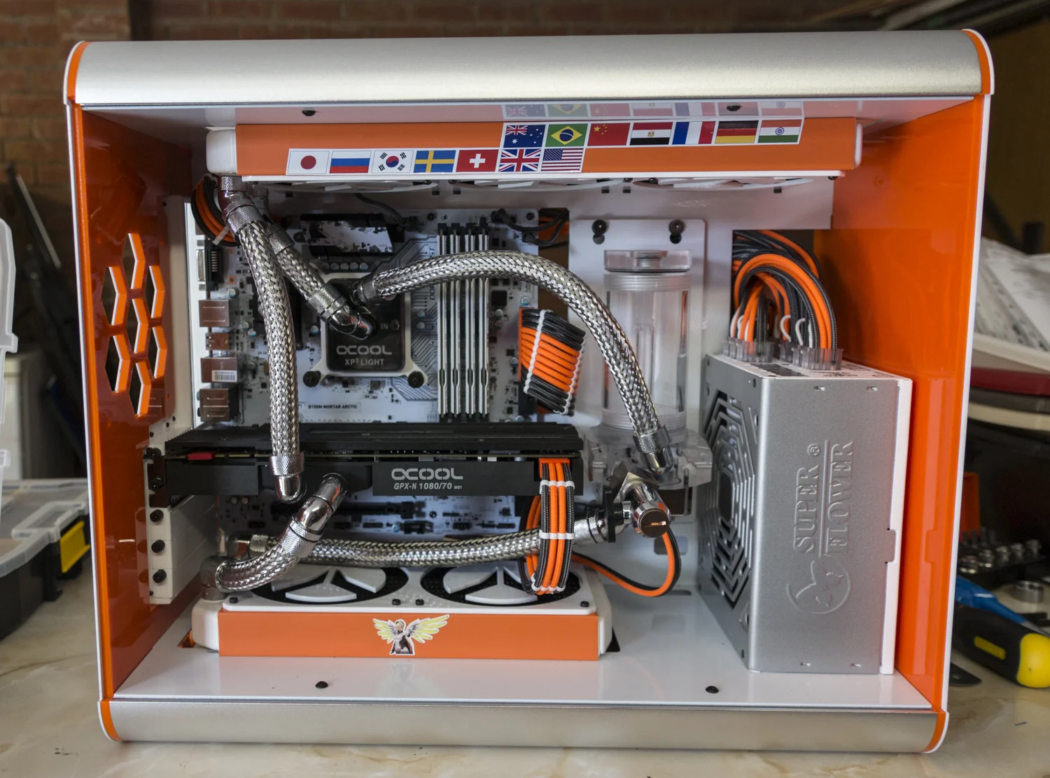

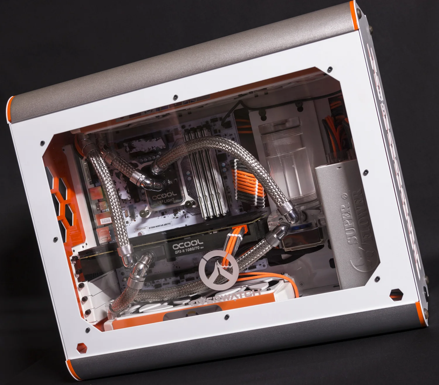

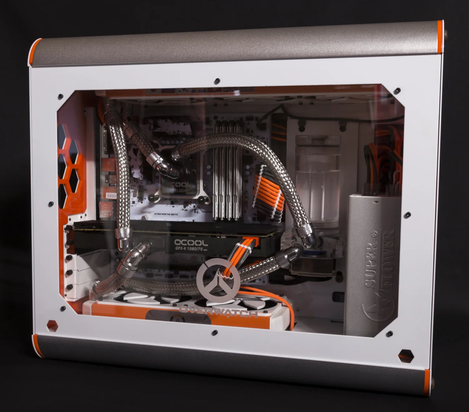

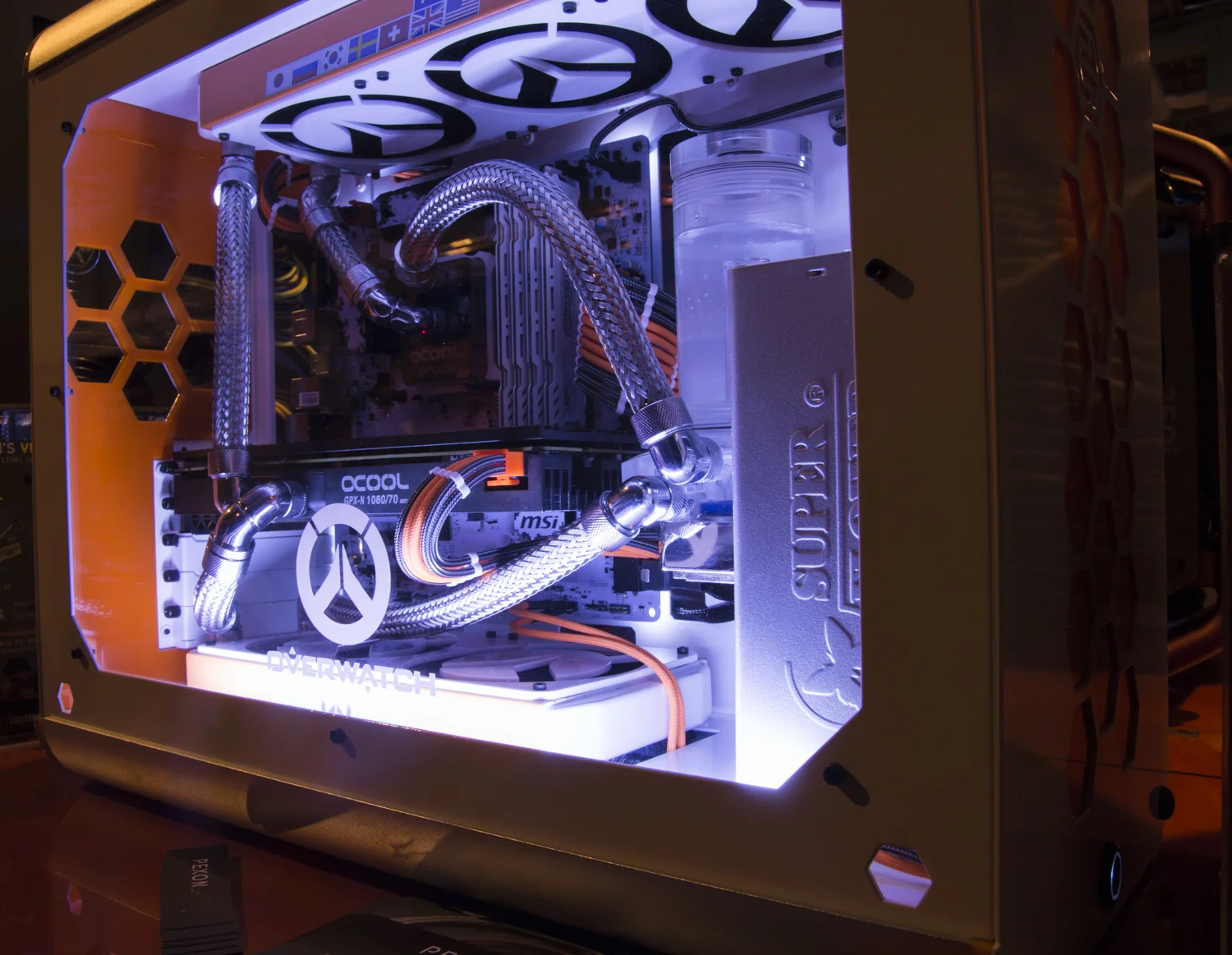

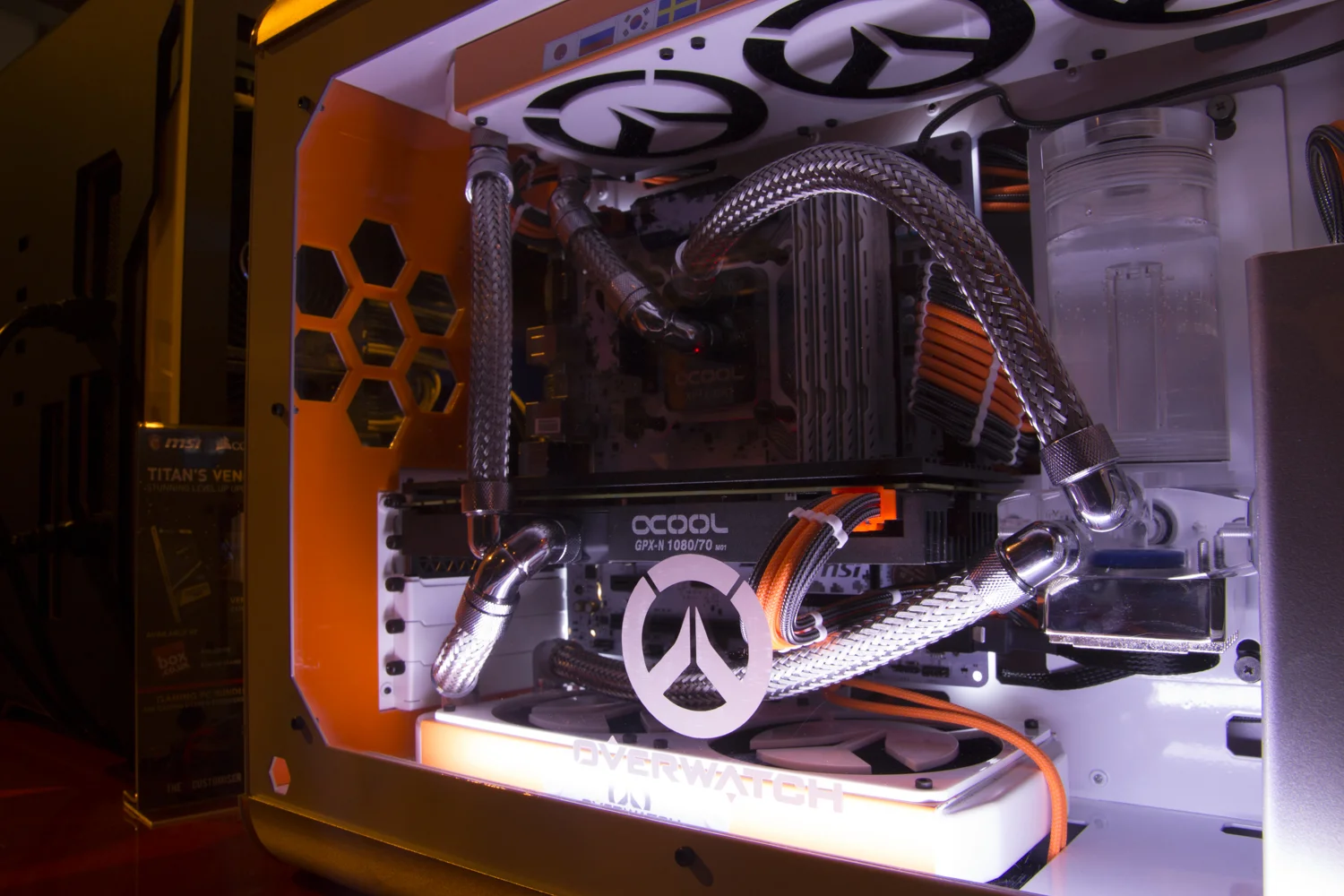

All tubed up and working

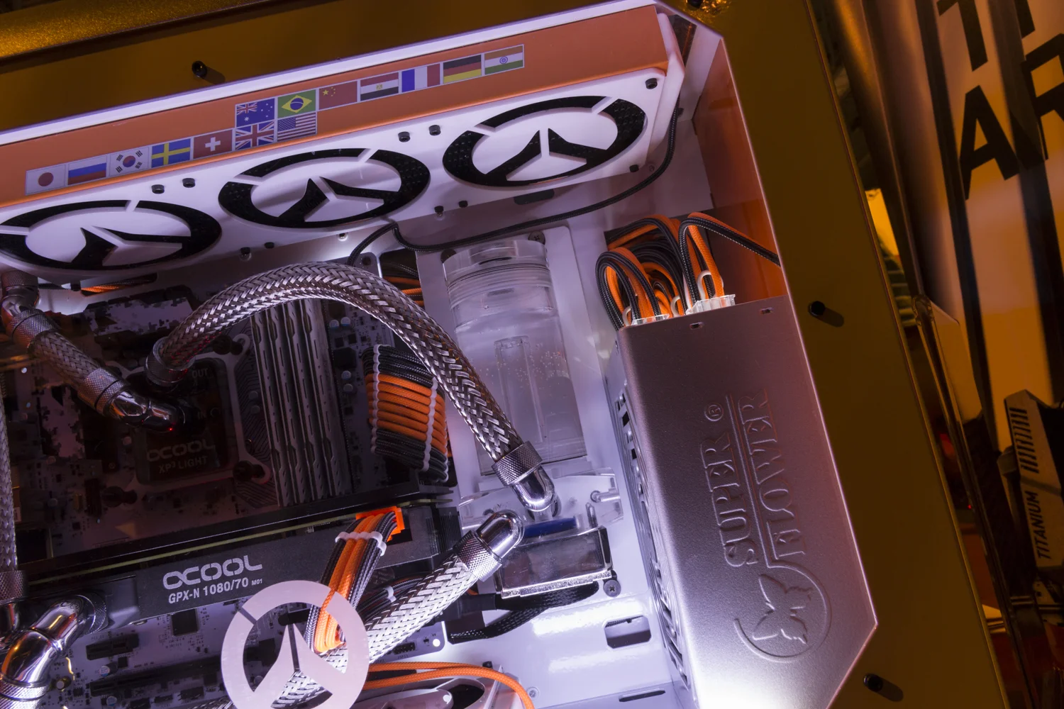

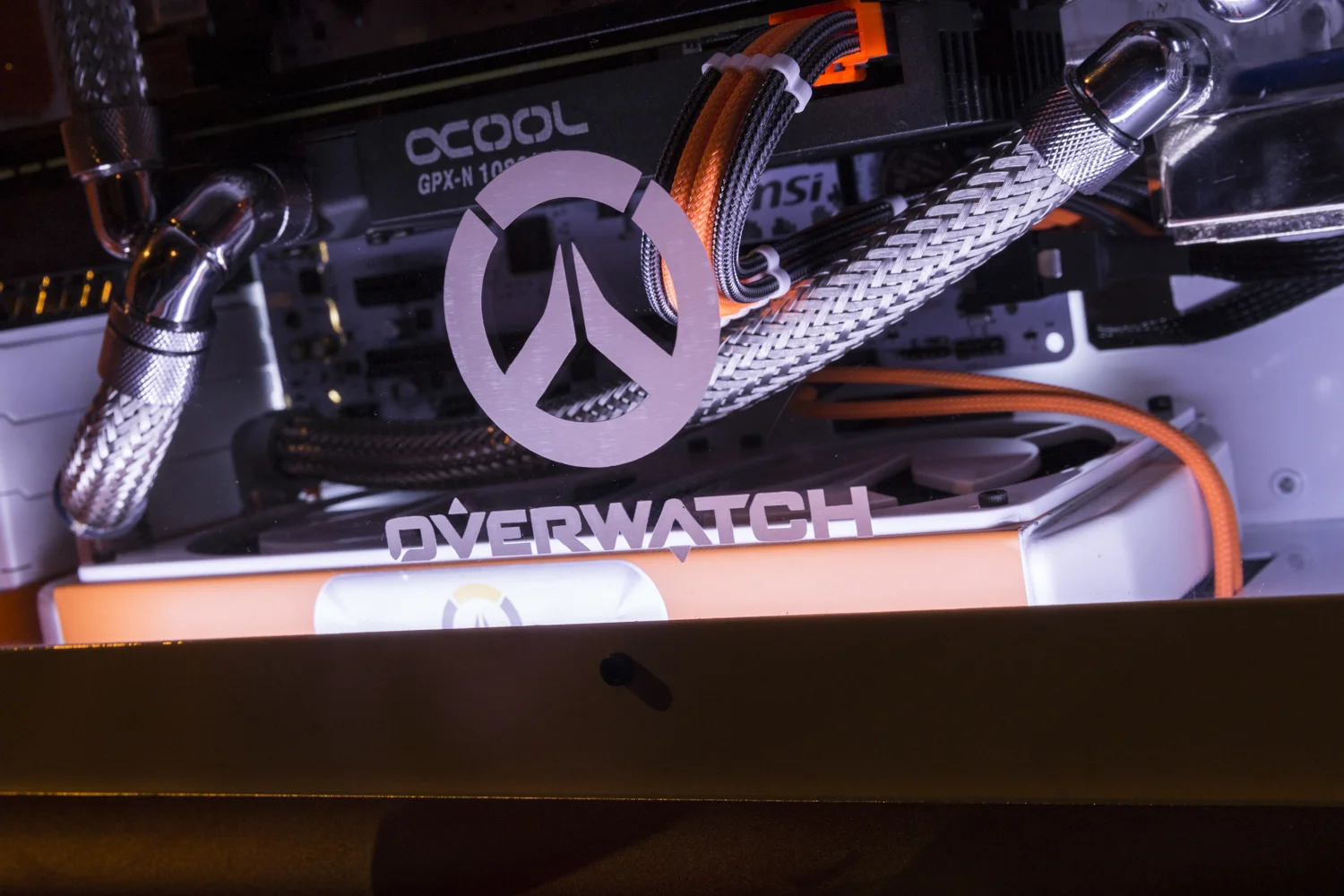

The underglow from the bottom LED strip actually worked well, I was dubious, but the lack of light from the top allows you to see the flags on the top rad and is just enough without being to OTT

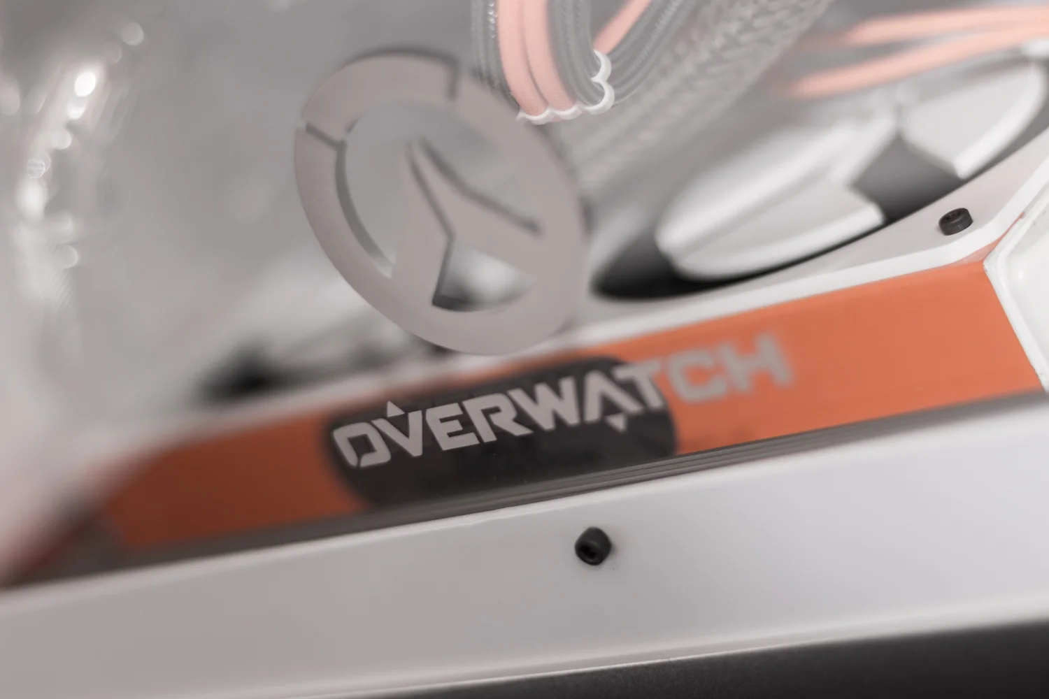

Overwatch logo looks epic on the window panel

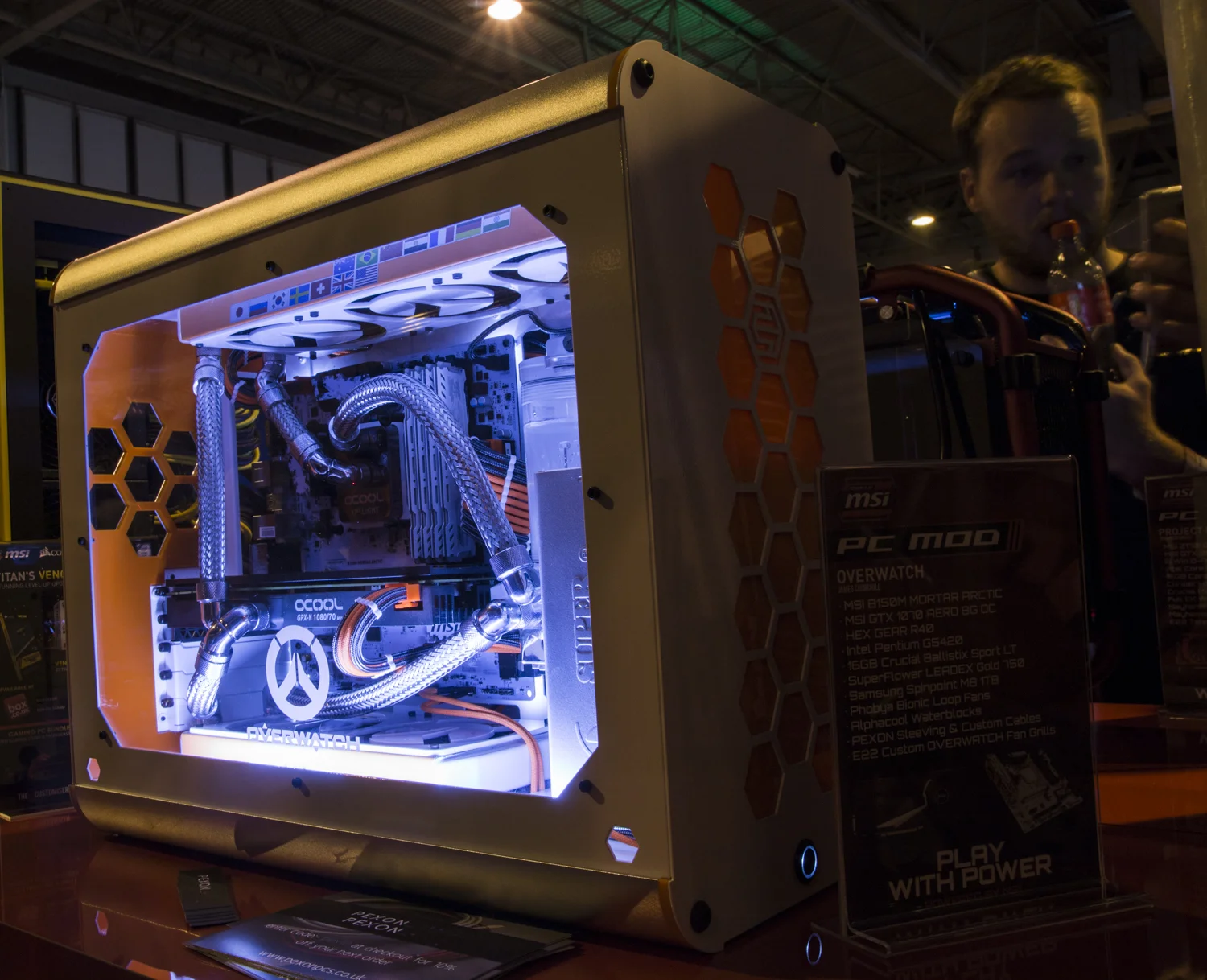

Now... they are quick and dirty pics from LAN (I was trying to take photos whilst people were playing VR on the MSI stand, better pics soon)!
Thanks for looking :)

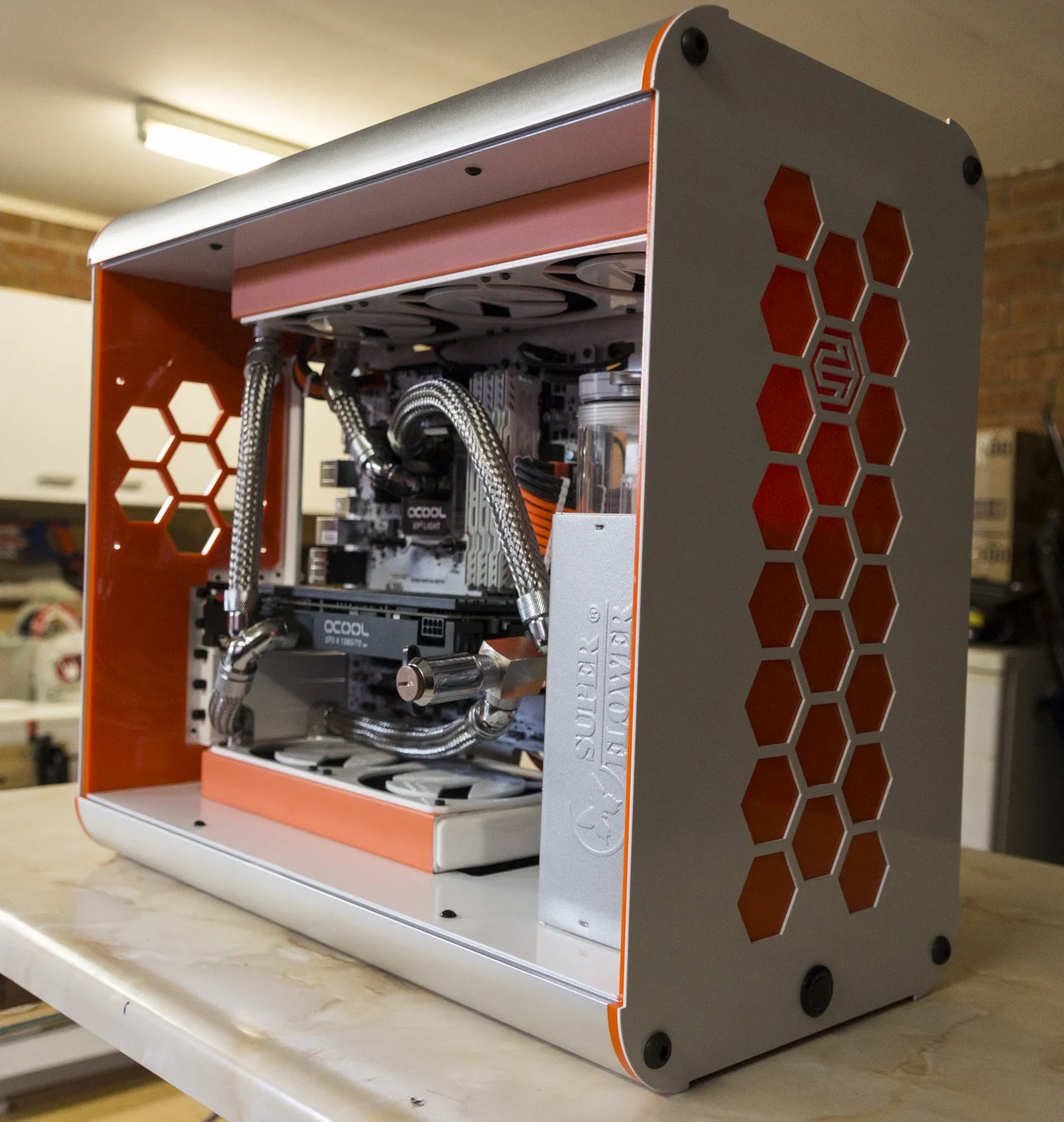

And thank you all for looking, I hope to be back with a new build log in the next month or so. This time, not as hectic as this!
<3 James/ pex
Another fantastic build! As much as the steel braid looks a pita to work with, the end result is awesome, my fav part of the whole build!
