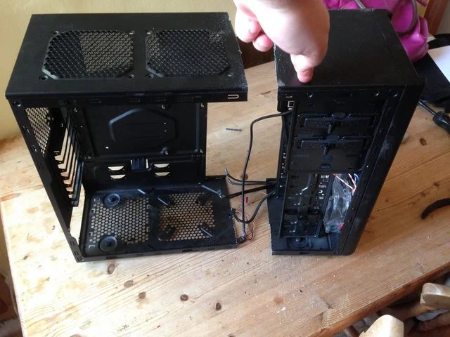

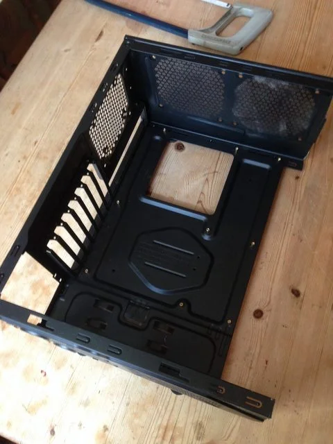

I spent most of this afternoon fashioning a a case to put the mine in. It was fine just resting on the desk, but I wouldn't want to have it like that long term. The GPU's needed some support too as they were leaning under their own weight which I'm sure over time will put huge strain on the ports. To do this, I took a saw to an old case I had in the cellar and decided to cut in in half!

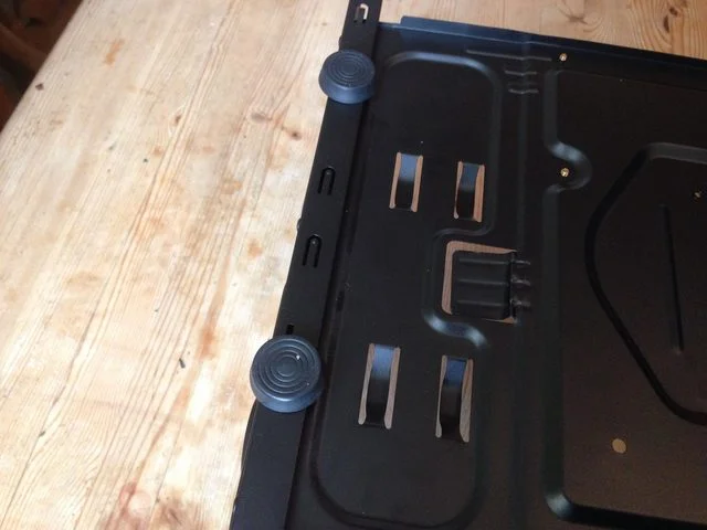

This left me with the half that I was going to use. Where there are no sides, that's where my desk fan will go to blow air into the case and over the GPUs. I also fashioned some rubber feet for it.
