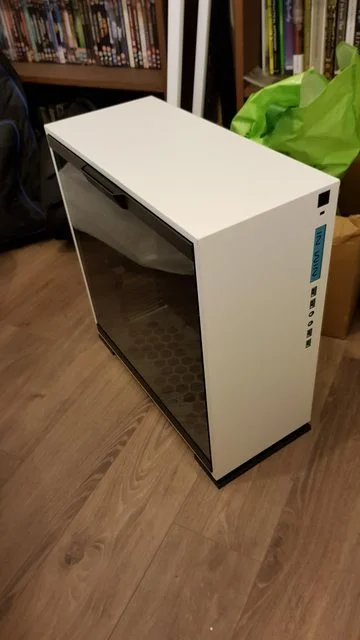

Fast forward a few months and the urge to tinker with the PC was strong. That coupled with not being 100% happy with the Phanteks resulted in me purchasing this gorgeous chunk of sexiness.
In-Win 303
I only realised after ordering it that the new stock has a white interior, making this the last of the old stock. However I quite like the contrasting interior and it should work nicely with the black/white theme I'm going for.

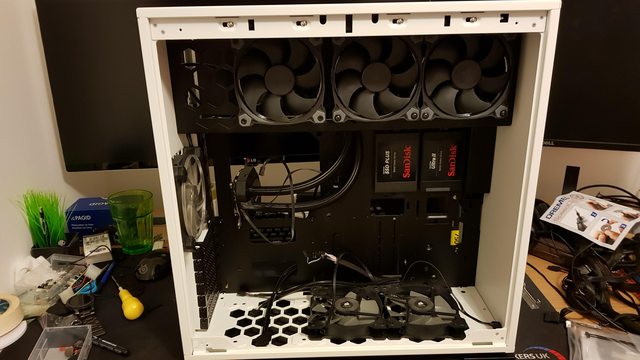

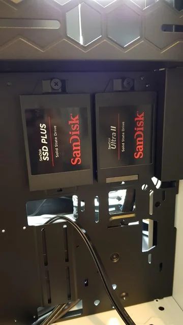

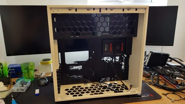

Got cracking with the case earlier on. Stripped down both sides them popped the SSD's into the case. At first glance It's nice to see matching drives alongside each other being shown off.
However on closer inspection, OCD!! They don't look the same.
Whilst it really shouldn't be anything to worry or care about I might consider getting vinyl wrap of some sort to sort them both out. Haven't decided yet.

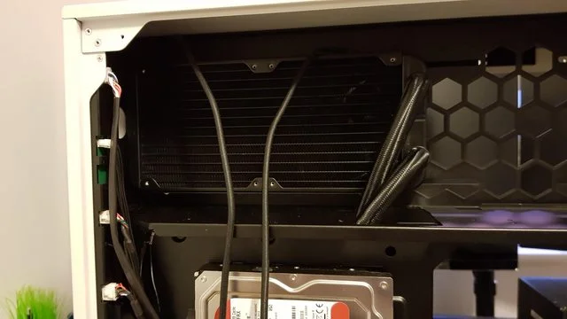

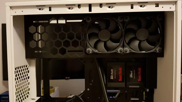

I then moved on to the subject of installing my watercooling. I looked at a lot of other 303 build logs and came to the conclusion there's to ways to properly mount the radiator. Option 1 is to mount it at the top on the front of the honeycomb grill, with the fans then on top of that. Whilst easy the problem with that is the tubes on the H100i are so rigid they'd push hard onto the glass case when closed. Which leads to option 2.

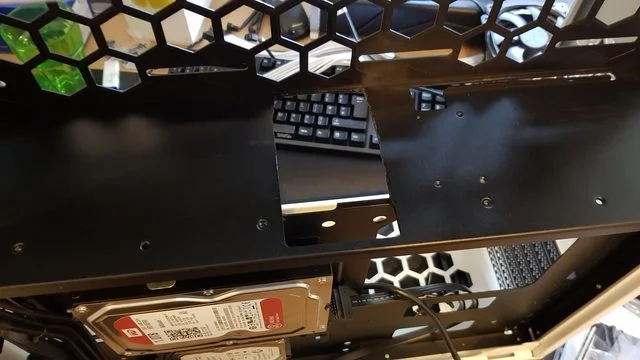

POWERTOOLS!
There's a convenient hole on the back side of the honeycomb grill perfect for putting the CPU block through. The only problem is that it's not wide enough. Cue one Dremel tool and newly purchased cutting disc and...
I don't think I did too bad a job enlarging the hole. Thankfully you won't see the inside of the case from the back, and from the front you can't see the hole anyway.
Radiator slots into place as snug as a bug, with tubes going down ready for fastening the block on toward the end of the build.
From the front it looks very neat indeed. I think it was the better option mounting the radiator behind the grill out of the way.
I added two of the three Thermaltake Riing 120mm fans that I ordered. They produce lovely white halos which will sit nicely with the theme I'm going for.
I added the third Thermaltake fan to the top. I'm annoyingly triggered by the fact I cannot get it to sit flush up against the middle fan. I can't screw it in closer with the radiator being in the way, the holes also sadly just don't line up properly to make it possible. I tried using bluetac to stick it on but with the honeycomb grill it's just not getting enough surface area to stick properly. I've also trial fitted an Antec fan to the rear of the case, along with the old Corsair fans that came with the AIO cooler to the bottom for some much needed air intake. I'll fit a third fan to the bottom if it doesn't interfere with the case and USB headers after the motherboard goes in. No LED's for the bottom.

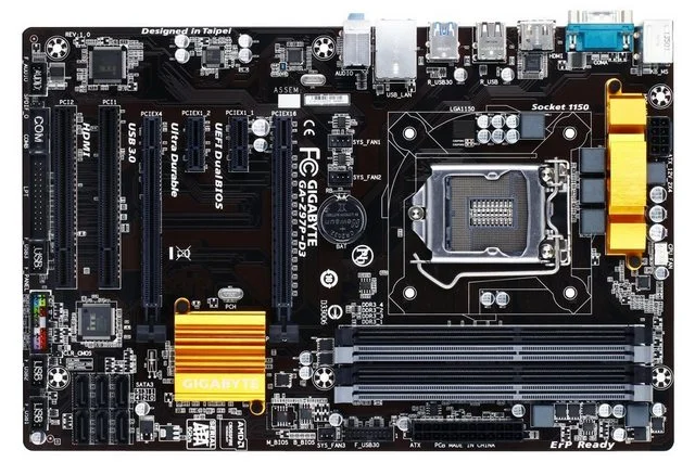

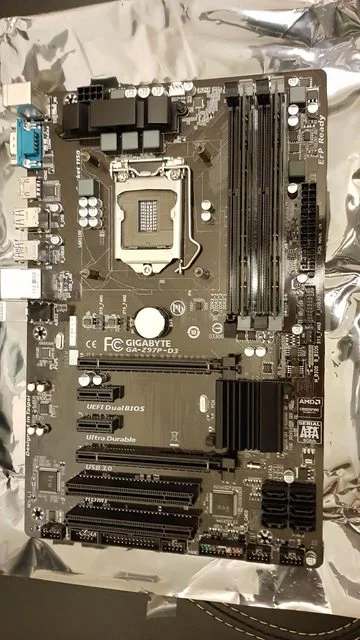

For anyone familiar with the motherboard I've got, you'll be aware that the heatsinks are completely unacceptable.
Did a bit of work on them and am really pleased with how they turned out!

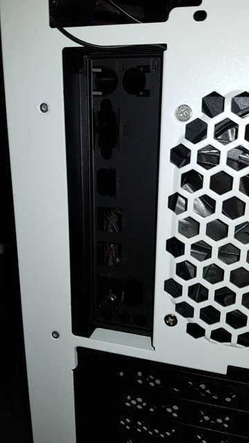

Bonus IO shield also colour corrected.

Made a cracking start to this, I see what you mean about the gap between the fans is there a possibility of even elongating the whole a little and it can slide/screw over a little? I think you are on to a winner with that case and the motherboard looks stealthy now the heat sinks are colour coded.

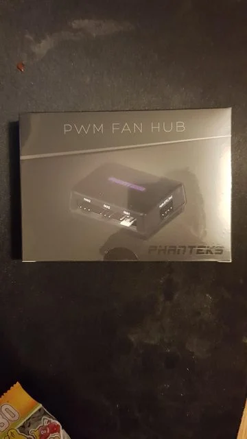

Hit a bit of a stumbling block unfortunately. The CPU block has a cable that comes off of it to power/control the included Corsair fans. I switched them for Thermaltake Riing fans, but didn't realise until now that they're 3 pin without PWM, so the Corsair block/Link software can't control the fans, they just blast out at 100% all of the time.
Just ordered a PWM fan controller. Hopefully I can connect the input of it to the CPU block, then all the fans I require to the controller. then use the Link software to reinstate my custom fan curve.

Thank you! She's almost finished. Just waiting on the fan controller then I can tidy up a few of the cables as well. Also could do with one extra fan for continuity.

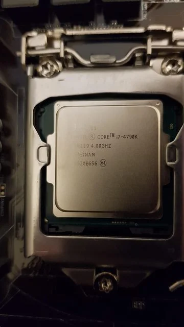

4790k is rock solid 4.6GHz @ 1.3v. When I have some time will push the clock a little higher, see what else it's capable of. Nice 25% CPU increase, should tide me over for a year or two until I decide where to go next.

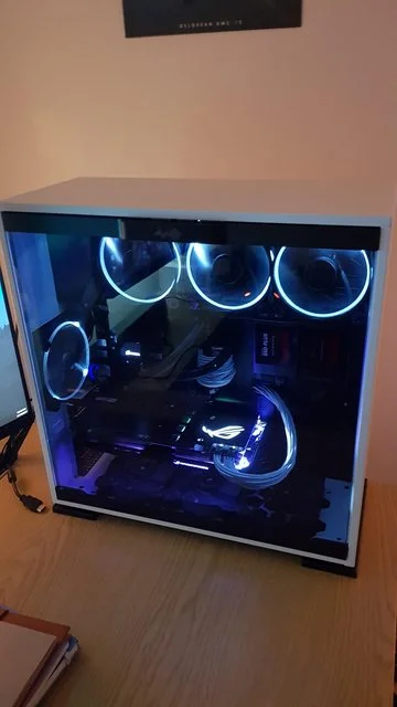

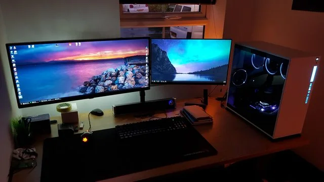

Finally she's almost finished!
So pleased with how the system looks, nice classy white. I just need to get some cable comes to neaten up the white extensions. Then waiting for my fan controller to arrive so it doesn't sound like a 747 on take off.
Overall it's a nice case to work with. If you plan to watercool then I'd definitely recommend taking a Dremel to it like I did. Cable management is also quite difficult with this case, I definitely recommend planning everything before screwing it down. I routed a lot of cables underneath the motherboard. That said, it's spacious inside which is great.
Airflow is interesting. My average temperature is higher than inside my old case (Phanteks P400), but maximum temperature is lower! I get around 33c average when browsing the internet etc, just under 60c when playing games, and it peaks at 75c when running benchmarks. Not sure if that means anything. GPU wise when benchmarking, if I have the fans on 100% is peaks at around 58c with the core overclocked to 2050MHz.
Pleased with the overall look of everything. A friend commented it's a bit too flash (he's a Mac lover), however I think the opposite. To me it seems pretty sophisticated and understated.
I just need to install the fan controller and do a little more on cable management. then might replace the bottom fans at some point.
