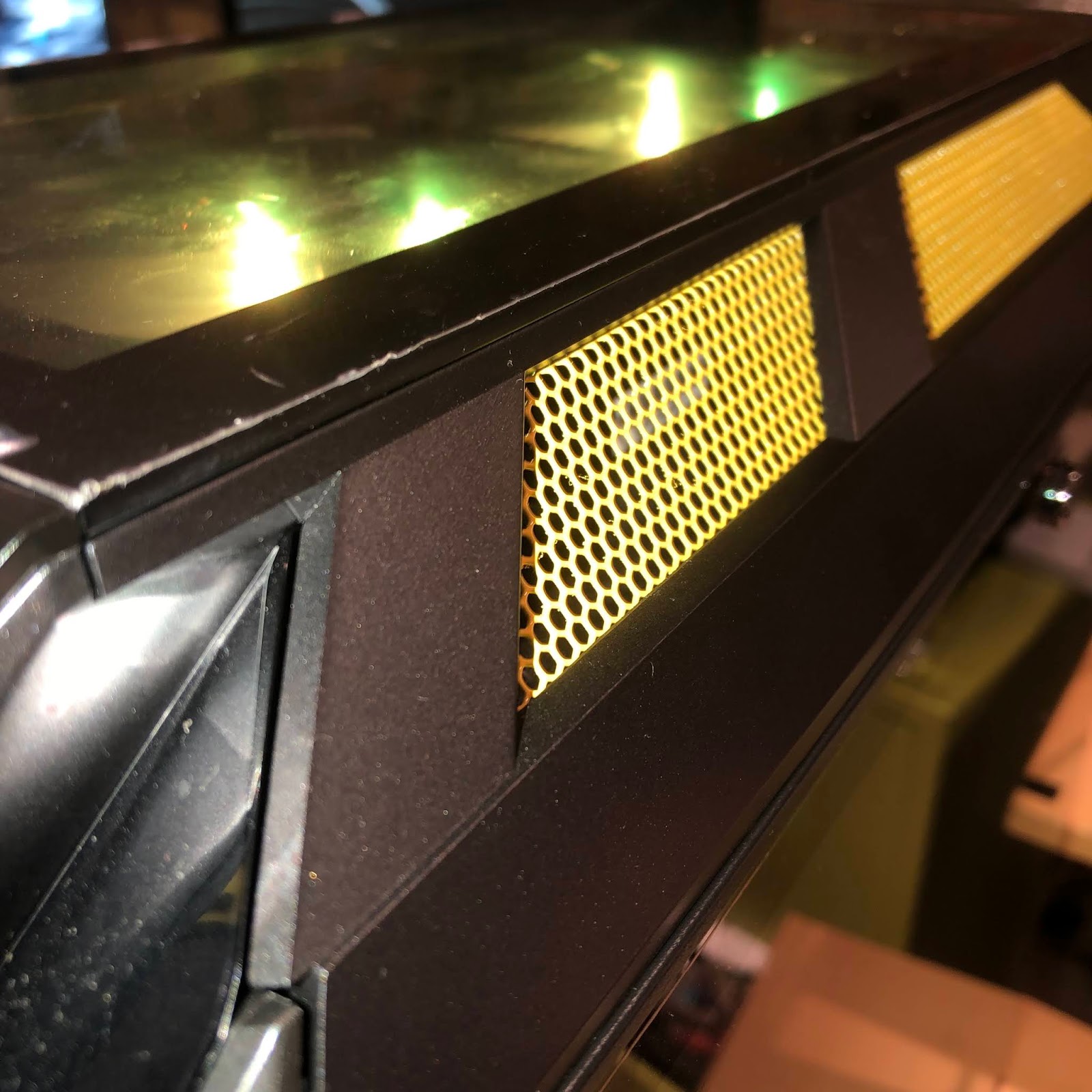

Right since I'm waiting for the PSU to come I thought I would crack on with the painting I've been meaning to do.
Have no idea how this primer is like but ferk it, lets get it on. not like I'm doing a really big stuff and needs to me perfect tbh either
yeah fudged it up a tiny bit there but should be able to just remove with a sharp knife or something if i I really have to.

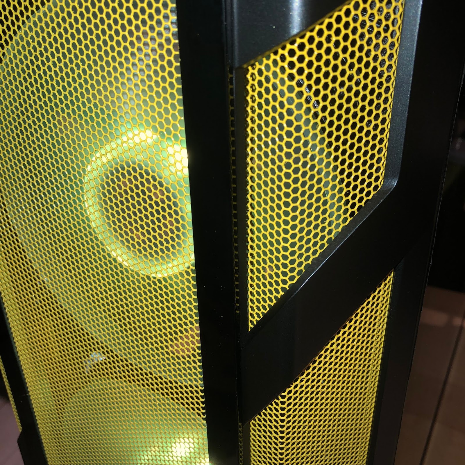

You can guess what colour its going to be right? :D
First coat of yellow, can you feel the power of yellow?
Will do another coat in a few hours after I've got the rig back together with a new PSU I'm currently waiting to be delivered today.

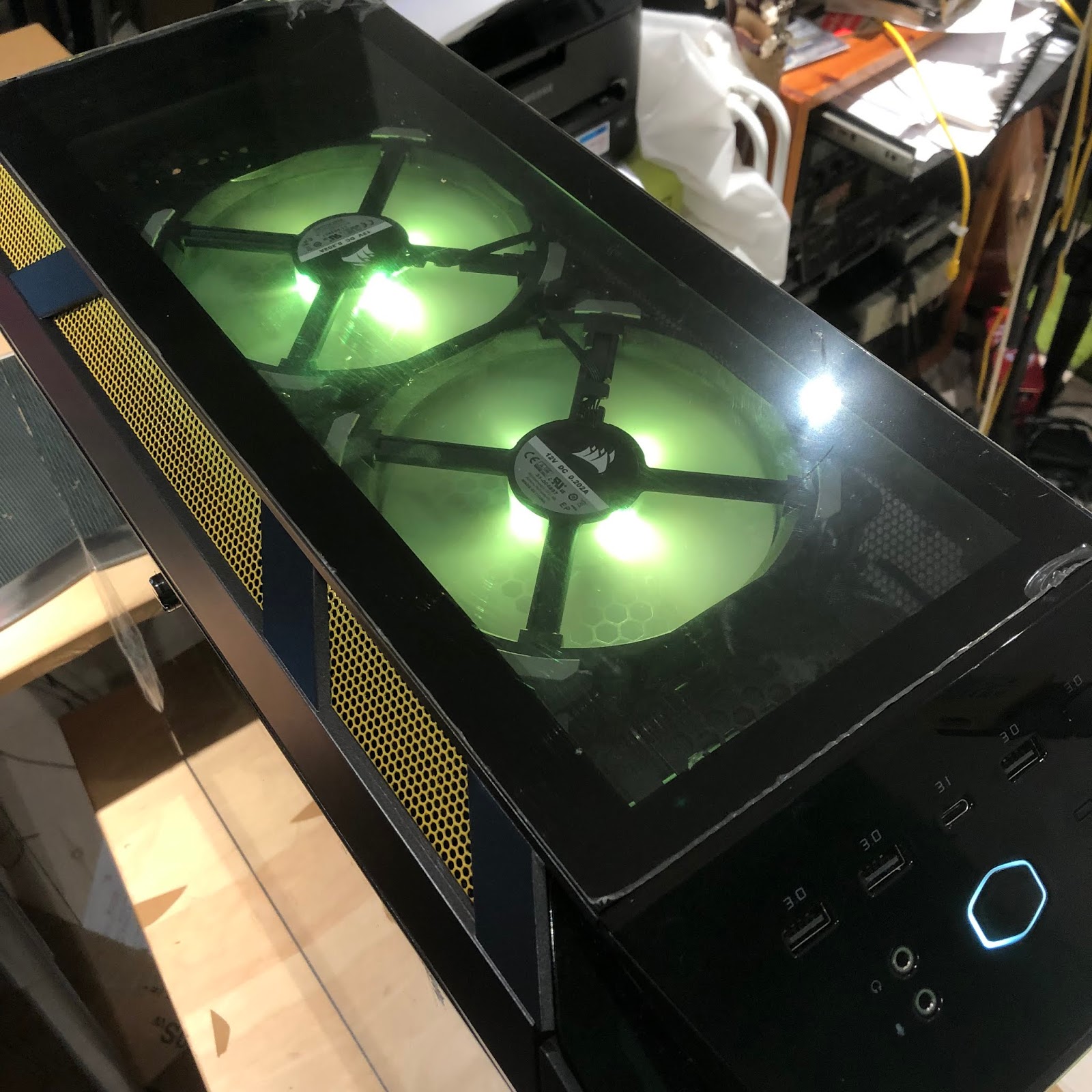

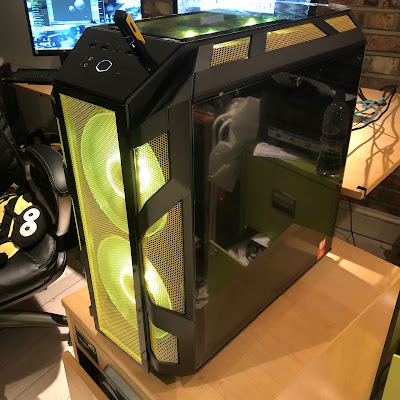

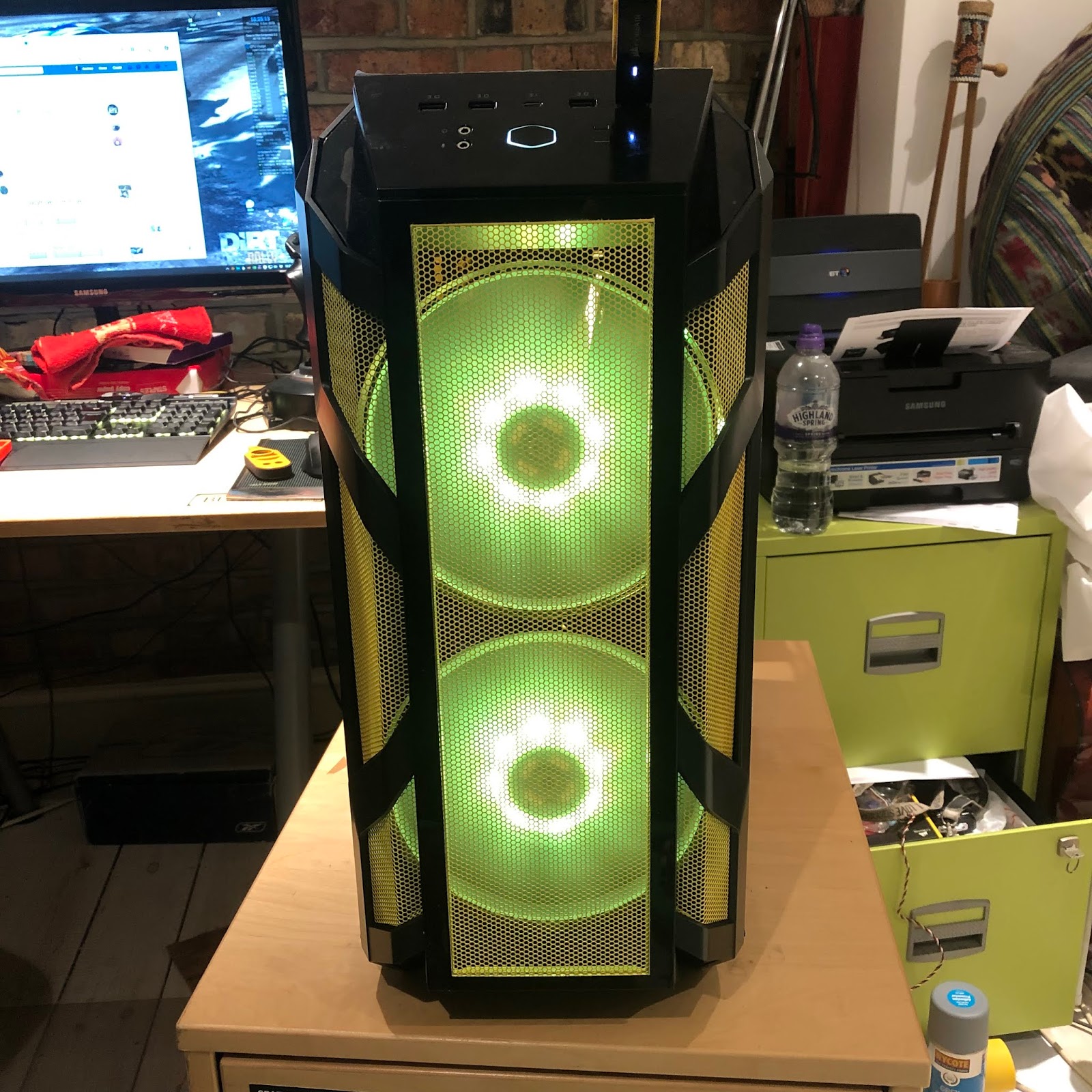

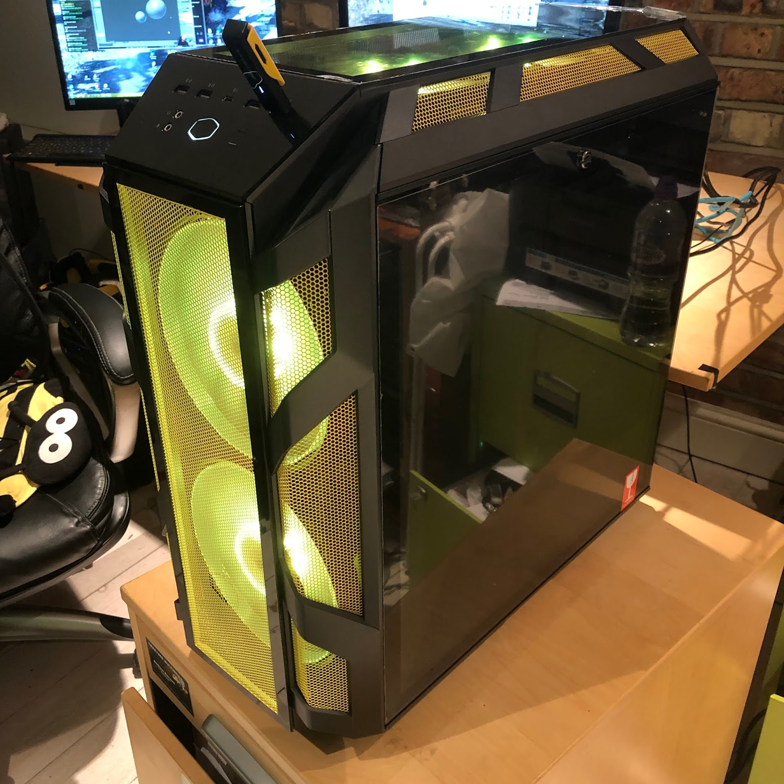

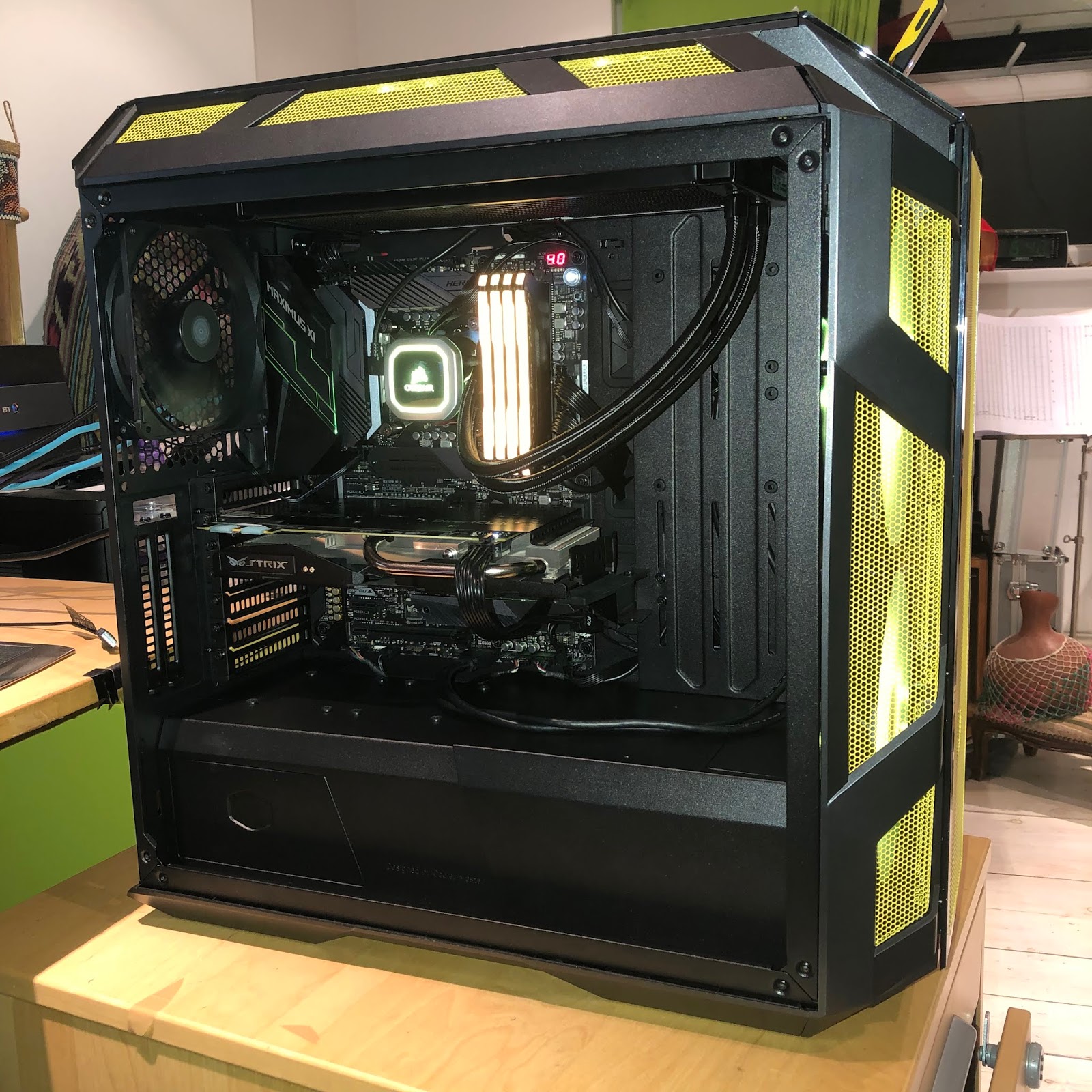

Well HiVE2.0 is finally here.

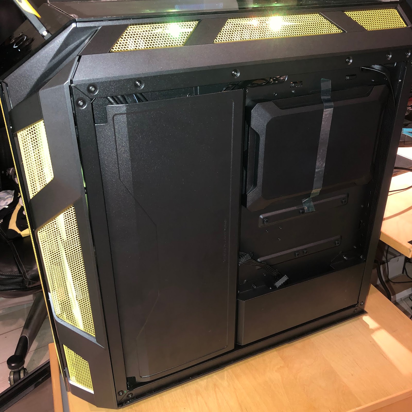

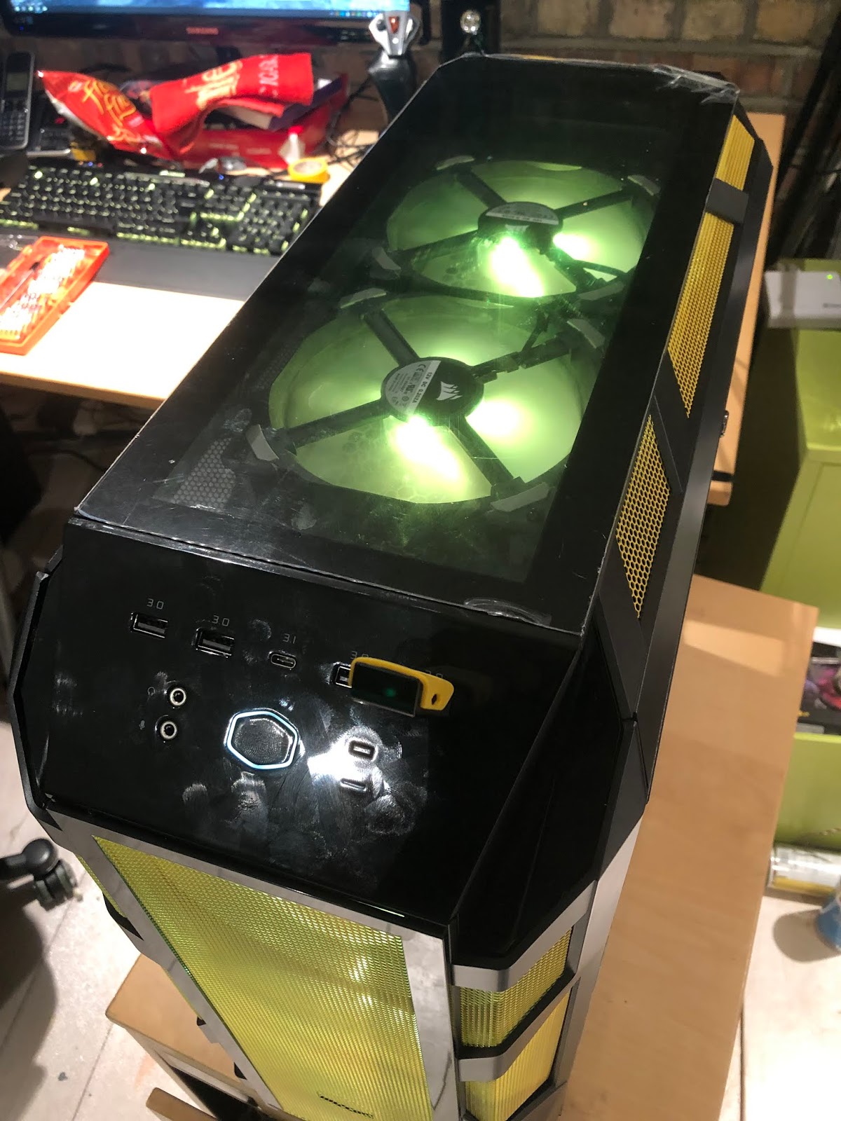

Moved the Corsair H115i Pro RGB Watercooler from the front of the case and put it in the roof of the case so the 2 big fans up front can pull the air inside. Managed to clean up all the wires as well so the case so it looks VERY clean inside. Well the cleanest I've ever built thats for sure.
Booted up again, played my game watching the temperatures and CPU (i9 no overclock) never went over 35C and graphics card didn't go over 65C when before it was hitting 90C. So its up and running without any issues now.
I present to you, HiVE2.0 ( I really need to learn how I've seen some other project logs do their case photos as they look so good, cleanr and really show of the case perfectly. Another time maybe. I do have a couple of spare ARGB headers on the mobo that are free, i may look into getting some light strips in future
Just that 1 SATA cable to the Coolermaster H500M RGB controller is showing, if it was just a touch longer it would be perfect
Glad to hear you've sorted the PSU / GPU issues, the finished build is looking very slick. Only VERY minor things I'd consider changing are routing the front panel USB cable under the PSU shroud (may need to use a slimline extension cable) and possibly moving the fans on the top to beneath the rad so they light the inside of the case. Looking very nice though :)
