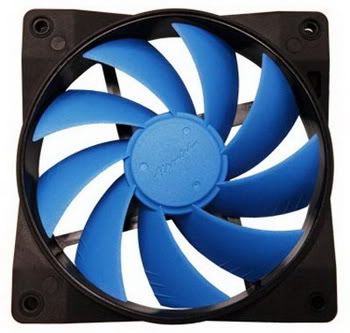

Im having an issue with the fan clips on a prolimatech super mega cooler. The issue being, i switched out a pair of akasa vipers for two alpenfohn wing boost fans on the cooler. Theese fans use a different type of frame than a conventional fan, on start theres a loud clicking, as i think the blades are hitting the wire clips, fine at idle in windows, but once the fans speed up it starts again. The clips also arent able to get a grip on the frame, unlike the vipers. Anyone suggest a better fan mounting method.
Comparison of fan frames.

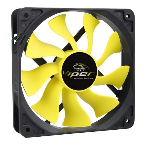

The flat section of the viper frame allows the clips to grab on, whereas on the alpenfohn, the inner frame is entirely circular.

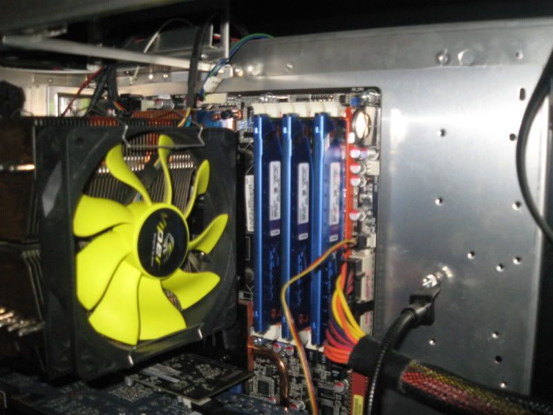

I had a Super Mega coupled with 2 Vipers & never did work out exactly which way round the clips were supposed to go.
Have you tried reversing them?
The clips can only go one way mate, they work fine on the vipers, takes no time to fit both fans. Unfortunately the alpenfohn fans are a different shape. Though they fit my TRUE fine as they use the fan screw holes to grab onto.
Vipers installed on supermega.
Yeah the Alpenfohn blades are slightly higher than normal although not all are like that so I suspect it might be a defect. I had a similar issue with one of my Alpenfohn fans.
Yep, it wasjust the front fan Helios, shame as they are pretty good fans, equally as good at cooling as the vipers, but a lot quieter. Idle temps were a bit higher with them, (40v vs 35 with the vipers), but load was pretty much the same. Wanted black and blue fans to match the gpu's etc, but theyll do in the other machine now.
