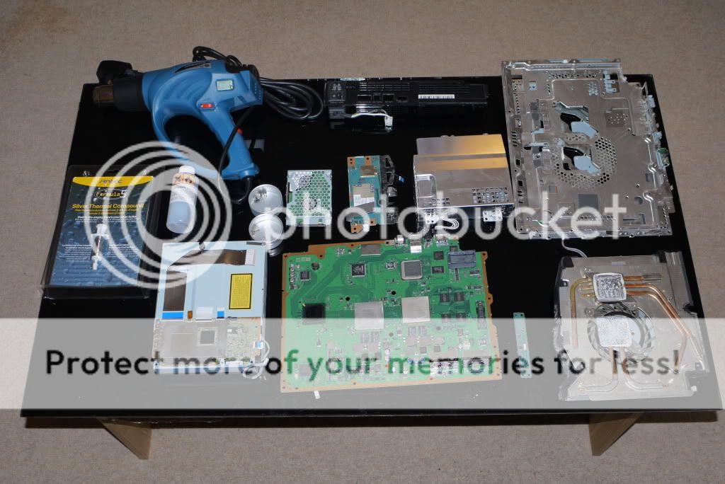

Hey all, just got all the supplies to tackle a re-flow on my YLOD'ed PS3. Has anyone actually done this and suceeded? Want to pull the trigger but have sort of bottled it! Any tips welcome.....cheers guys ;)
Sure will do watch this space here is one of the laid out parts i'll be tackling. Wish me luck gonna do it Sunday!
