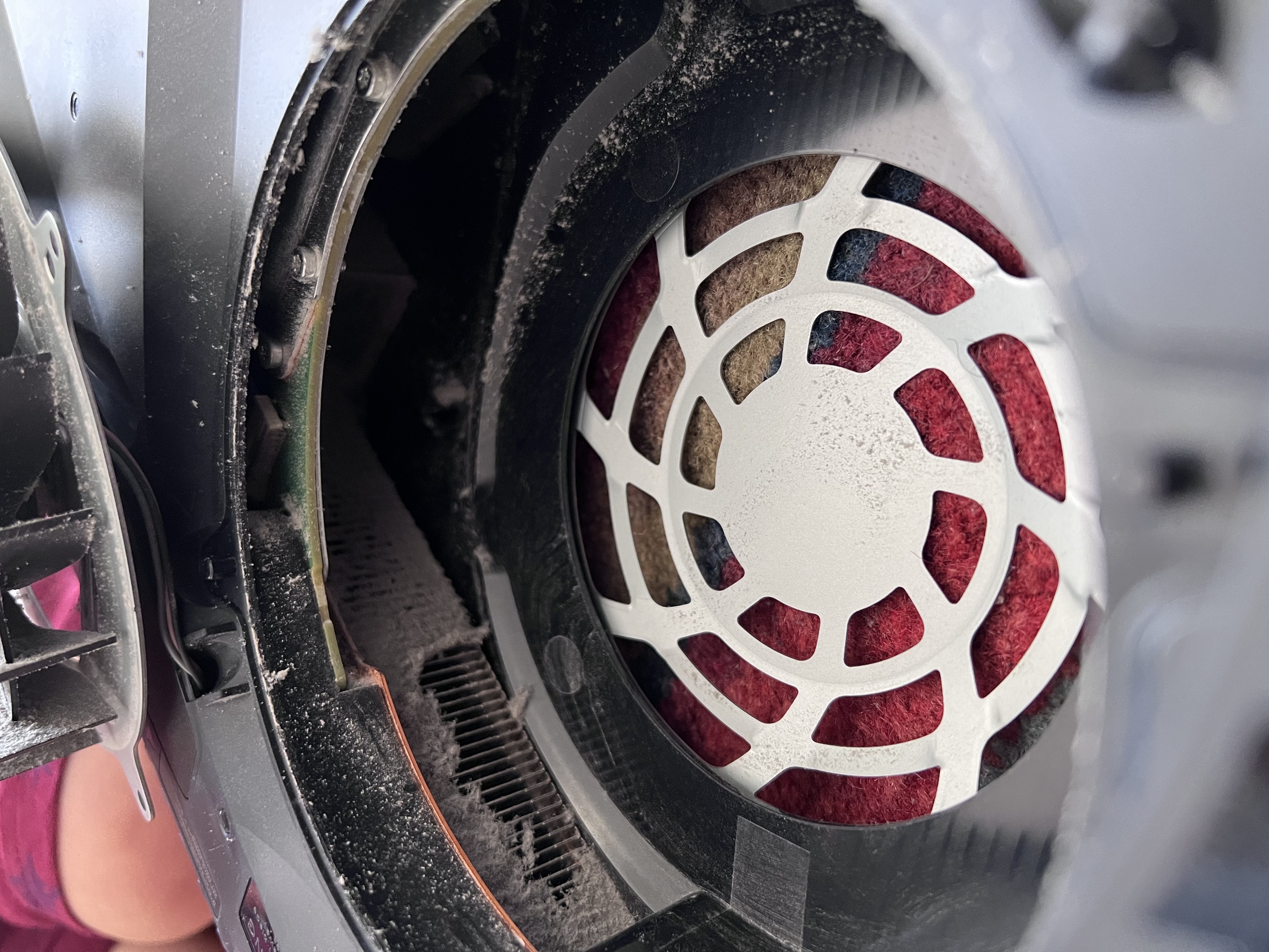

Do you guys not regularly dust around your PS5's? I give mine a dust before every session and have given it a deep clean twice so far since launch. Never have I experienced it powering down or a overheating warning.
I have never had the need to deep clean it or even dust it and absolutely no issues. I just checked it and there is barely any dust on anyway.
I need to properly open it up and clean it out but haven't any more issues so far. I don't think it helps with the fan being so choked off.
Same, those photos above are staggering and definitely not the norm. When I installed an SSD in mine recently there was hardly any sign of dust build up around the fan or vents, and my flat does get fairly dusty.
