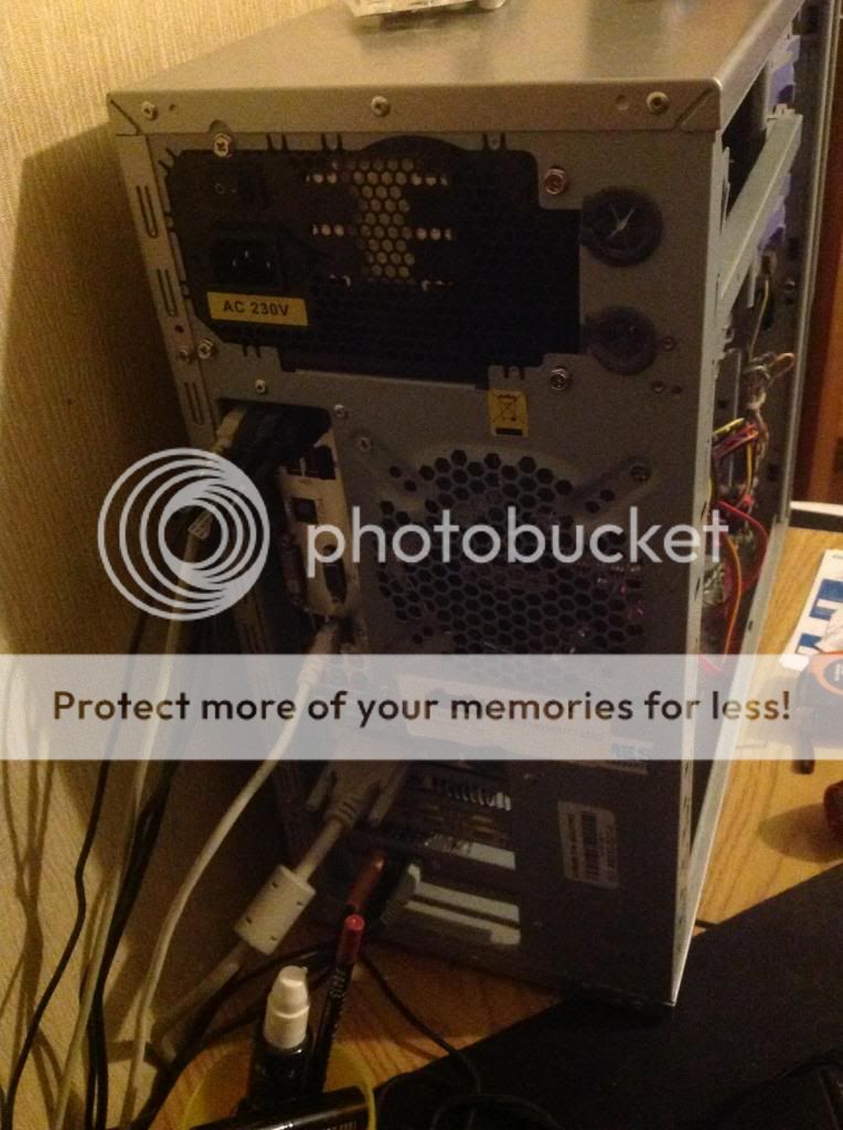

Hmmmm that is a good idea! The psu is about 1 inch inside of that bar and it does not seem to do anything! Was looking at it and thinking the same myself! Will just have to remember where and what plugs in where! Will call in the shop that fitted the faulty unit tomorrow and have a quiet word about it. Won't say what I paid but am NOT happy. They owe me cash so may see what they can do to rectify the fault. Maybe reimburse me, I can then get the psu myself and either have them fit it or do it myself. Thanks for the advice, will post back tomorrow when I know if I need a new psu from here and what is happening. Cheers!

Can you see any make/model info on the PSU they have fitted?
Failing that the rear side of your case (left side in rear pic) should easily remove and give you more room to remove the PSU, take a look!

Just ordered a corsair 750w builder psu. Had to get it from another site as needed del tomorrow to get it fitted (sorry oc but I missed the del closure time). As to the psu that they fitted, I did name it earlier here as evo labs 700w pentium 4 psu. I am certain this is the prob as in the store today they told me that they swapped out the old psu and replaced it with the same make and model that was already there. ..... Crappy psu prob not cope with the card, will see tomorrow if corsair runs it ok..... Really hope it does and they don't manufacture a fault! Sigh.....
