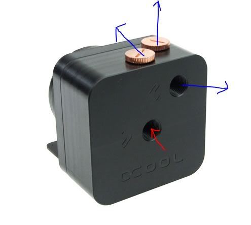

probs got it set up wrong. this what cooling & using.
360 rad , cpu, g card, pump, res & 140 rad. best way please

Red is inlet
Blue is outlet (only use on at a time :p)
I have the plexi version and going purely on looks it does appear that the top left could possibly be used as an inlet. For the sake of certainty, i'll stand by my original statement until someone can 100% confirm that :)
I know it can definitely be used as an outlet
It doesn't matter now I guess :) but I have that exact alphacool top using the two top ports - one as inlet one as outlet - plugged in and working in front of me :D
