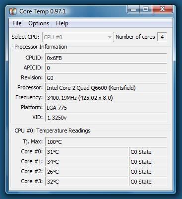

here's my idle temps:
I might give up on the higher FSB soon and try to run it @ 9x400.
