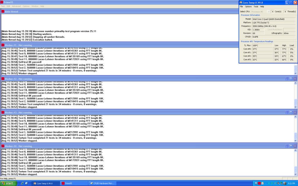

I'm still trying to find the maximum overclocked speed for my Q6600.
So far 3.4GHz seems to be quite stable with 30 minutes fail-safe Prime95 stress test.
I want to know if the following temperature is sort of acceptable Idle (40,39,38,35) and MaxLoad(56,57,54,51), what you reckon?
Thanks!
