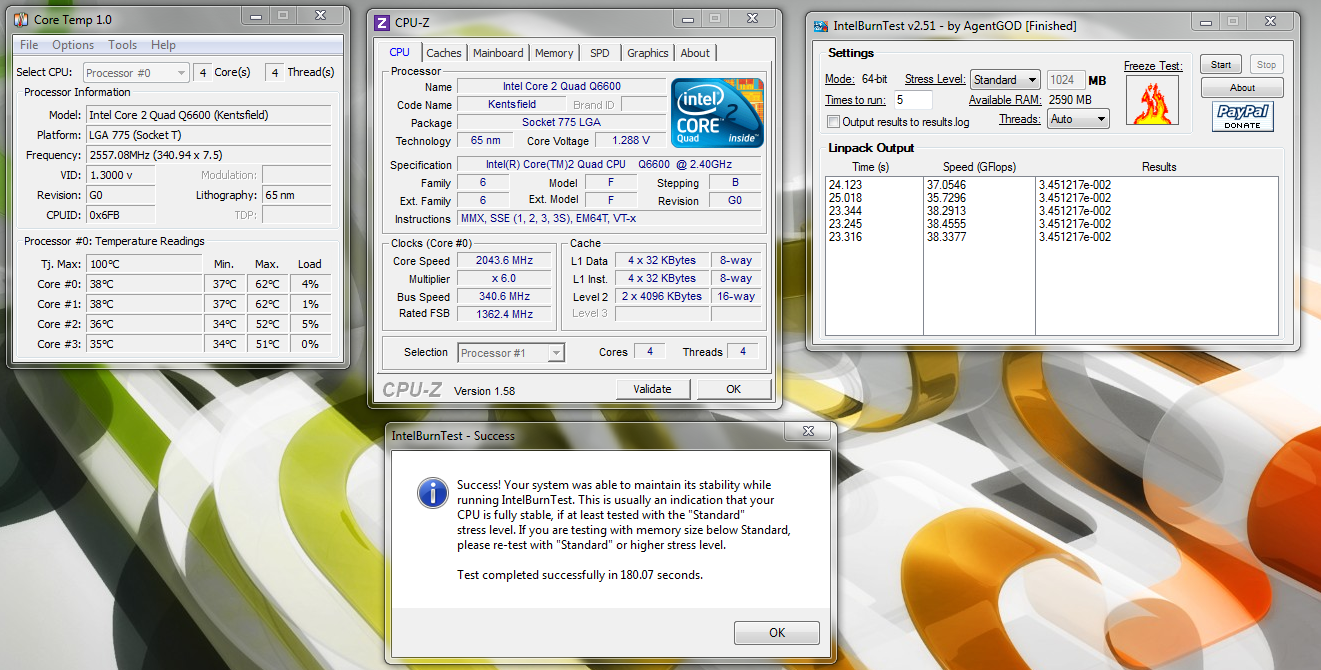

I just fitted my new Q6600 into my machine and want to try and maximise the performance on with (hopefully giving a boost in BF3 over my E7300). I've stuck a 3Ghz OC on it just now and all seems fine but I just want to check on the voltages and temps.
So while running IBT:
CPU-Z Info - CPU voltage is currently set to Auto in the BIOS and the value on the image is the highest I've seen.
If you can let me know where I can improve things I'd appreciate it!
The motherboard I am using is the Asus P5Q Pro and the CPU is running under a Noctua cooler.

Set the voltage manually, you'll get it lower than auto will which will lower temps.
Mine's clocked at 3.4GHz (378 x 9.0x) with around 1.27v.

Seems good at 3.6, bumped the volts up a bit and it's spot on. Temps are a little higher as I ran furmark as well to get the case temps up to see what the absolute max would be when gaming. It's staying at around 74c now that I've closed furmark. With a decent cooler I'm sure I could improve that a lot.

I've dropped the vcore a notch since posting and tems have dropped to about 71c now :)
Right, had a play around and got this:
I tried to get the clock higher but with manual volts on the CPU I couldn't get it to boot into Windows. Happy with this though, temps etc are lower now :)
