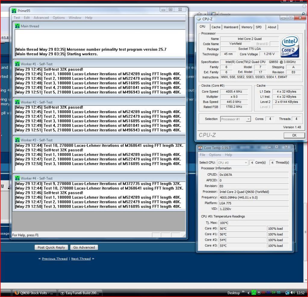

I had a quick check for you last night to see how far it could go on stock volts, as close to the VID as possible.
I'd have to agree with Greedo in saying that 4ghz on stock volts is totally realistic. Got mine just under the VID last night although only by a fraction.
