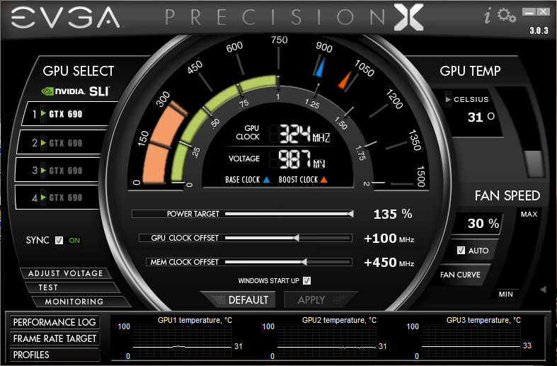

When running Heaven, or anything majorly taxing that isn't using v-sync, my cards will start heating up to 60C+ before eventually creeping up and beyond 70C. I have a custom fan profile that attempts to keep them below 70, with the fans running at 100% at this temperature but it doesn't seem to be enough.
I am aware of these cards automatically downclocking when they reach this temperature threshold so would ideally like to keep them under this.
They are in a Coolermaster HAF X case with a fan on the side blowing air onto them, one at the front blowing air inwards, with 2 exhausts in the top and another at rear of CPU. At idle the cards hover around the ~32C area.
Does anyone think it's worth me considering reapplying the TIM on the cards? (they are EVGA ones so I believe I can do that and remain within warranty?). Any other options besides watercooling that I could try?
On a whim I thought I'd have a blast with overclocking them, cranked up the core clock +100 and memory clock +450 - it only made about a 10FPS difference in Heaven, largely I think because it's downclocking above 70C anyway.

Your temps are fine. Your GPUs won't downclock, they just won't boost up if the temperatures are too high (unless they are hitting 100C+).

Yeah also note that your clock will only decrease 13mhz at a time. This is not going to affect you in the slightest with quad SLI.
Heaven is not very nvidia friendly when using multi gpus. Have a go on 3dmark11 you will see a much better result there.
