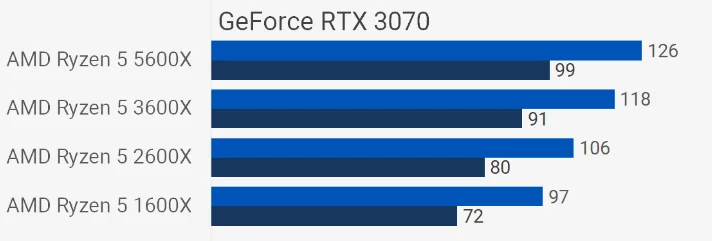

I doubt the problem is that bad like you say, AMD generations with a similar performance gpu below ... and this is a 'worst case' 1080P situation, you may actually be within 10-15% depending on game of course.
