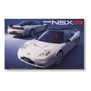

Hey all, just got a quick query, I used to bluild airfix planes but haven't done anything modeling wise for a while now, my girlfriend bought me a model of my favourite car
for christmas, and it looks really good, nice and complex but not too so :) Its a Fujimi model and has recommended the following paint colours, but I'm not sure where I can get the corresponding paints for the car (Car itself was bought from ebay) as its been a while :) and any recommendations on the best way to paint them? before building? after? Airbrush? brush? Just thought I'd have an ask around here before I make a start, any advice would be great, thanks :)
