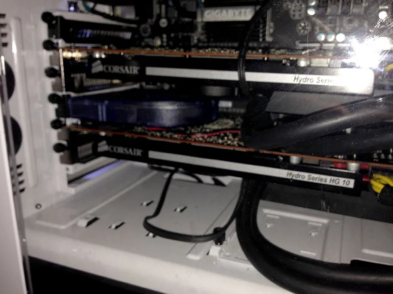

I have 2 R9 290s under water, albeit each with their own AIO strapped to it. The top card runs about 15 degrees hotter than the lower card, at around 65c after an hour under full load (vs 50c on the lower card). For less demanding games, the temperatures hover around 55c (top) and 40c (lower).

Single rads mounted in the front as intake. Only H55 AIOs.
This is in an NZXT H440, though, so poor circulation.

I've added a 2nd fan to the rad for the top card. It now runs at pretty much exactly the same temperature as the lower card, so around 50C under full load.
Push pull is probably very beneficial in the H440 if you have room for it.
And always remove the out of sight mesh strips from the top and front panel. Helps a tonne.

I found it creates a real hot-pocket down there without one. The other alternative was a 40-60mm fan in the window.

I will mount a fan on one of the drive sleds. Pushing air onto the cards. Will not be putting a fan on the window I hate that.
