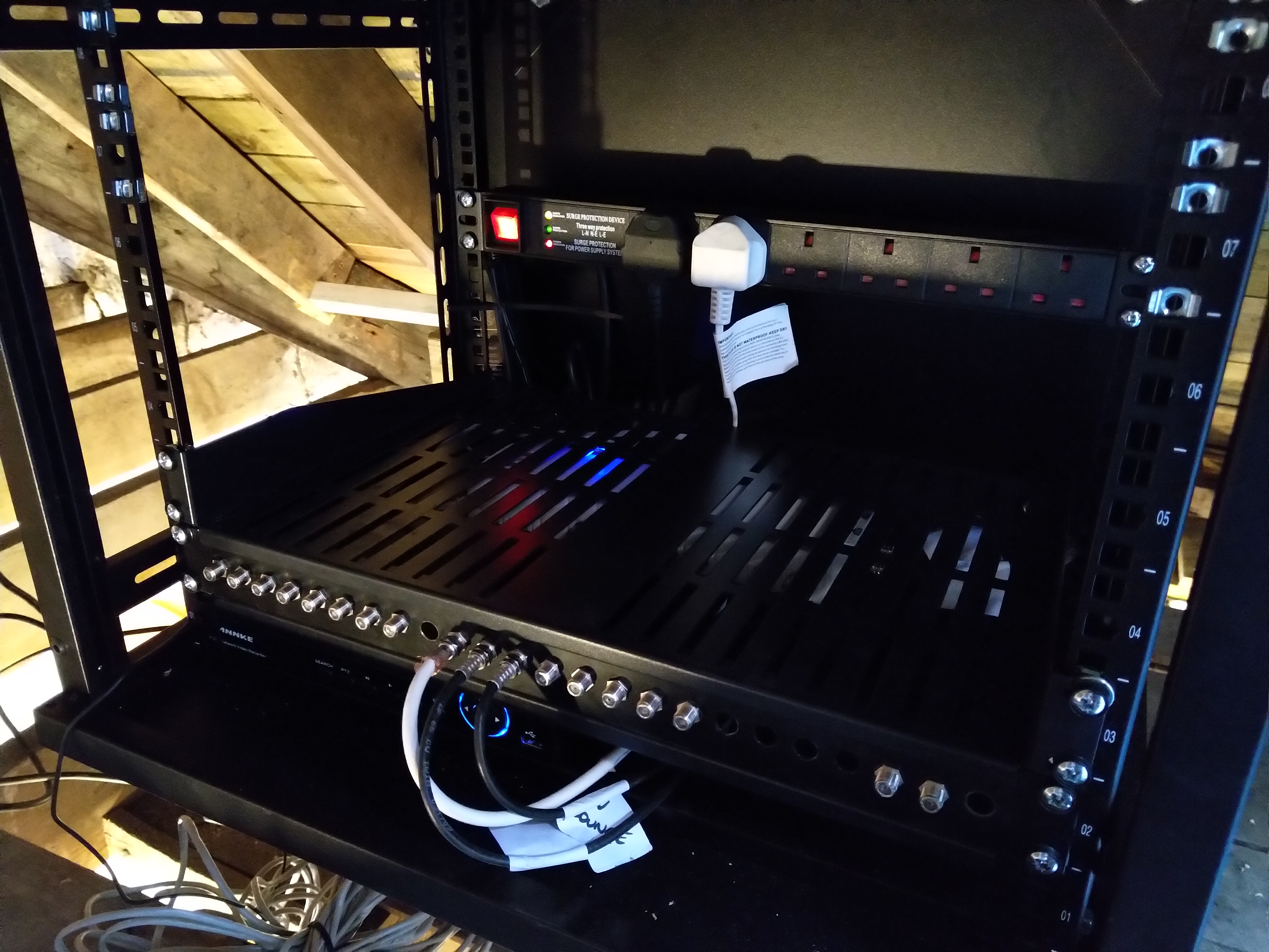

Thought I would.follow this up with my solution.
I ended up using a patch panel fitted with f-type connectors ( far cheaper to buy blank panel and connectors and make yourself ) and then connected the distribution unit outputs to that. So now I have a patch panel of 8 outputs which works a treat. The input to the unit I did direct as it just didn't want to work via the patch panel.
Then a shelf back on top and it looks very neat ....
That's the way to do it... Nice linear signal path. Should you ever introduce a second RF signal, you can patch it all as you see fit. Should be more than enough for household.
