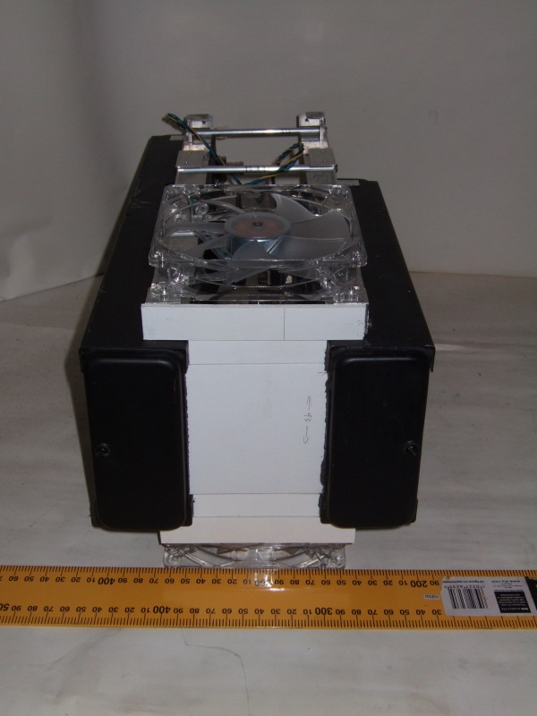

You may like this idea. My latest project, two PA120.3s + six fans in a space less than 200mm X 230mm. I've no idea how well it will work :eek:. Free for personal use of course.
Intresting Idea ecat - I guess all the fans are either pushing air into the void (out the rads) or sucking air out of it (in through the rads).
Looks like a 'boxer' engine block :D
Try a V6 next (with just the three top fans)
Thank you. Going off topic:
Following the current trends in product naming I call it the 200wPA.3TriFanx2 ;)
All fans pulling in my case.
The basic version has a flat central baffle plate to avoid the problem of a fan or fans pulling air straight through the opposite fans.
If I get adventurous the active version uses 'Advanced Microprocessor Control', aka a £3 pic to dynamically balance the fan speeds, oh yes :D

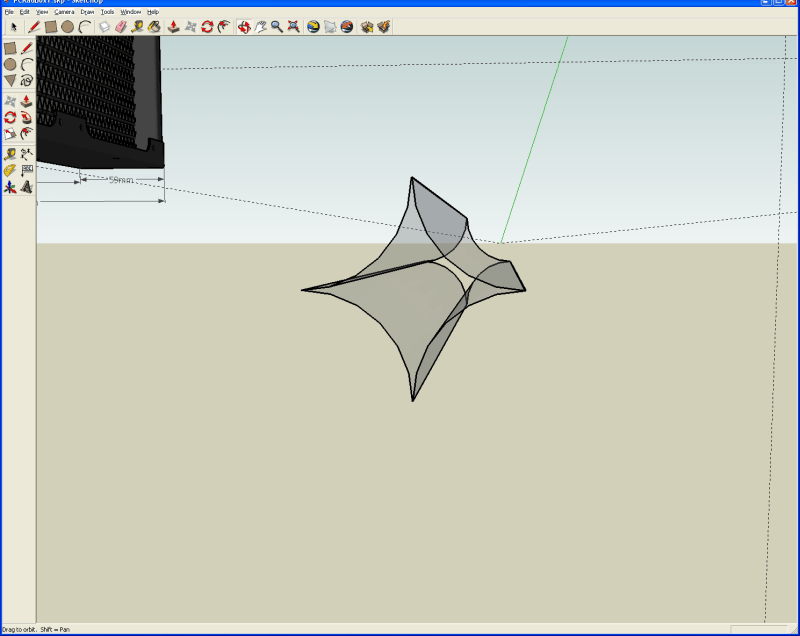

Perhaps the most interesting option is to use a profiled central baffle, something like this :
... seal the ends, add some fittings and presto you have a combined reservoir :D There may even be room for a DDC :D:D.
