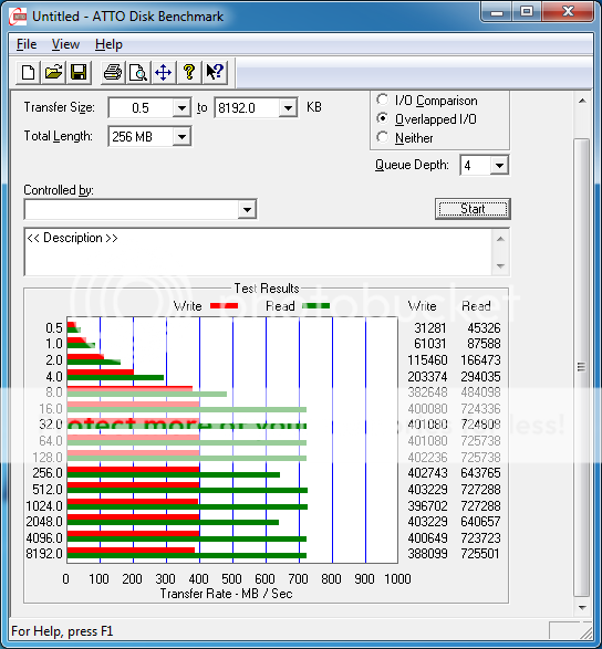

Ive been running my M4's in RAID 0 for a while now but have been getting low speeds.
Ive got the latest SATA / RAID drivers, plugged into the correct ports on MOBO but i am getting really low speeds from it.
Any idea why its doing this and any idea how to fix it?

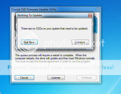

according to that your running old 1.10 firmware,000f is the latest version which improves read/write speeds for that ssd
ill suggest what someone else said the other day and that was to power off pc,then switch off at the wall,then power back up after an update,it might show correct firmware then
tried that also ran the manual updater instead of windows 1 from boot says both drives are at 000F but AS SSD is still saying 1.10 and speeds are still the same.
