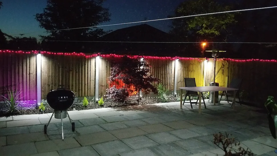

I use these:
http://www.ebay.co.uk/itm/291038206...49&var=590202050351&ssPageName=STRK:MEBIDX:IT
and have 13 in my garden at the moment; they're great and very cost effective. You can put whatever GU10 LED bulb you want in them too. You can also add light gels easily. I use small Wiska IP junction boxes for weatherproof joins.
the lamps are a little bit on the 'function over form' look but they're fairly discrete and I actually like them. better than spending 30-40 quid on a single spike light!
image:
