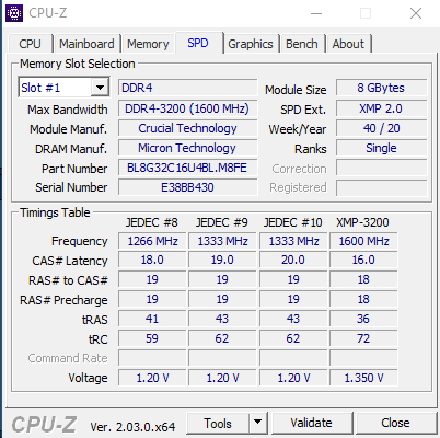

Main system spec below. I have no overclocking on at all. The BIOS was last updated when I bought the motherboard so that it supported the 5600x. I've only really been using HWMonitor.
CPU - Ryzen 56000x
Motherboard - ROG Strix B550-G Gaming (2201 Bios)
RAM - 4x Crucial 8GB DDR4-3200 (BL8G32C16U4BL.M8FE)
GPU - Nvidia GTX 1080ti
PSU - Corsair RM650x
