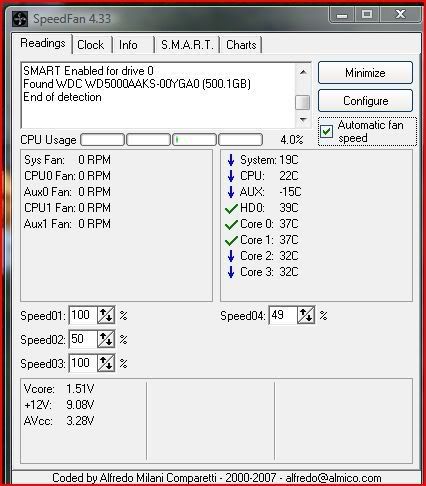

So I downloaded Speedfan with the idea of checking CPU temps...
Which are as follows when I get the blue dots:
Does not look anything to suggest overheat of CPU so what the hell is it?!?
Could it possibly be a faulty card AGAIN?
If i come out of playing COD4 or Crysis or X3 the blue dots disapear within a minute or so which suggest heat to me....
HELP!
