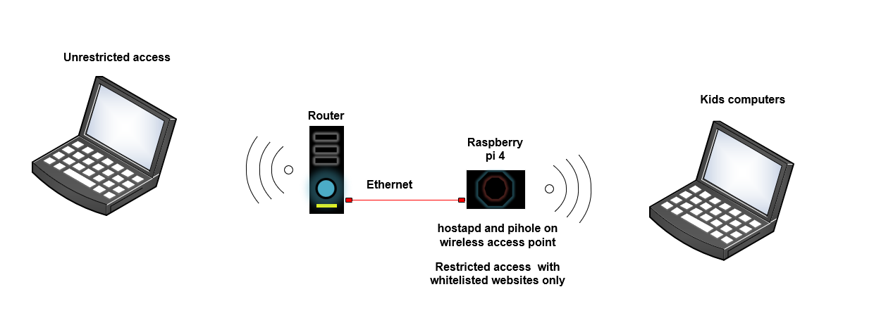

Would it be possible to set up pi-hole on wap for only my kids to connect to it so they have restrictive website access?
I currently have hostapd working on WAP but it doesn't have internet yet I think I need to bridge it?? and I wanted pi-hole to be part of the WAP if that is possible?
So kids connect to pie and adults can connect to my normal router with normal access?
Thank you for any help and advice.

You are over complicating things by trying to run a specific network just for the kids, you would be better running it as a subnet or layered network rather than a sperate physical network.
Thank you I will give this ago.
What I got working was having pie hole have sperate DNS to my router so the kid's computer connected to that DNS instead.
I know it is easy to bypass if they change the DNS IP back, but I am working on other options as well.
