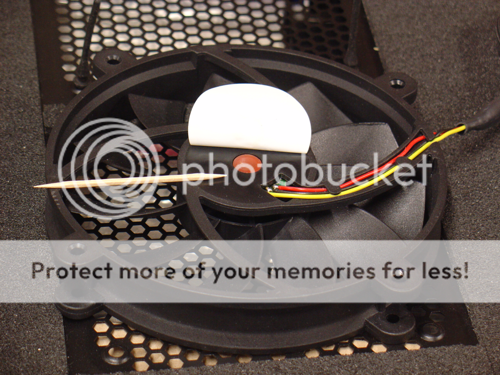

If it's a Sleeve bearing fan then that particular fans reservoir oil might have emptied.
Sleeve bearing fans you can self-service via filler cap on rear side with machine oil (As in the sort you would get with sowing machine etc, not WD40), providing there's a reservoir cap on rear under the sticker.
No reservoir cap then best to RMA card.

In below example from 0:55 onwards; you can hear what a sleeve bearing fan tends to sound like when in dire need of reservoir top up :)
Sound similar?
Sound similar?

Have you checked behind the fans rear sticker for small plug/cap? Could save yourself a lot of cash...

Think of it as your car oil running out, so you just scrap it and buy a new car. Who in the right mind would do that, when you can just top up the oil? :)
Well...machine oil is less than £3.00 delivered, if the fan has a rear plug/cap then fault can fixed in less than 5mins. Bearing wont be shot yet if it's not bad as one in linked video.

2 or 3 drops of £3.00 machine oil under that plug (If there is one) = possibly fixed.
