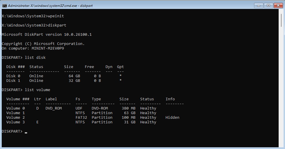

If not too late, everything you need to create an image of the the NVMe, with all partitions is right there on the Windows setup USB.
Boot the USB, start a CMD window and backup the disk to a FFU image. I think I've posted the commands before. Let me know if you need them and I'll post them again.
Why you not using Macrium or something similar? Keep it simple!
Nothing wrong with the above method but added complexity for little value tbf.
Sorry for the delay, I've been trying to create the guide using a VM and ran in to two issues. The Windows 11 24H2 setup WinPE doesn't recognise the "Capture-FFU", I'm sure previous versions this. Secondly, the "Capture-FFU" command doesn't work on a virtual disk and I don't have a spare physical device to hand for a complete set of images.
First, you'll need to create a bootable WinPE USB, as shown in this guide. Or you can save some time and use the WinPE ISO I created using the same guide, which you can copy to a USB using Rufus.
1. Boot your computer using the WinPE USB. WinPE starts in a CMD window.
2. Before you start, run Diskpart to identify the volume labels, i.e. the drive letter of the disk to save the image to.
2.1. Type Diskpart
2.3. Type List Disk to confirm the disk you want to backup (OS Disk) is Disk 0
2.3. Type List Volume to confirm the drive letter (Ltr) of the backup disk, can be internal or external.
2.4. Type Exit to leave Diskpart
3. Enter the command below, replacing E: with the letter of the drive you're saving the image to if different
Code:
DISM /Capture-FFU /ImageFile=E:\NewLaptop.FFU /CaptureDrive=\\.\PhysicalDrive0 /Name:Disk0 /Description:"New Laptop Backup"
4. To restore the FFU image, enter the command, replacing E: with the letter of the drive the FFU image is saved on
Code:
DISM /Apply-FFU /ImageFile=E:\NewLaptop.FFU /ApplyDrive:\\.\PhysicalDrive0
More information on FFU images and some limitations. The most notable one is the FFU needs to be applied to a disk of the same size or larger. There is an optimze command to shrink the image when applying, but this doesn't seem reliable.
