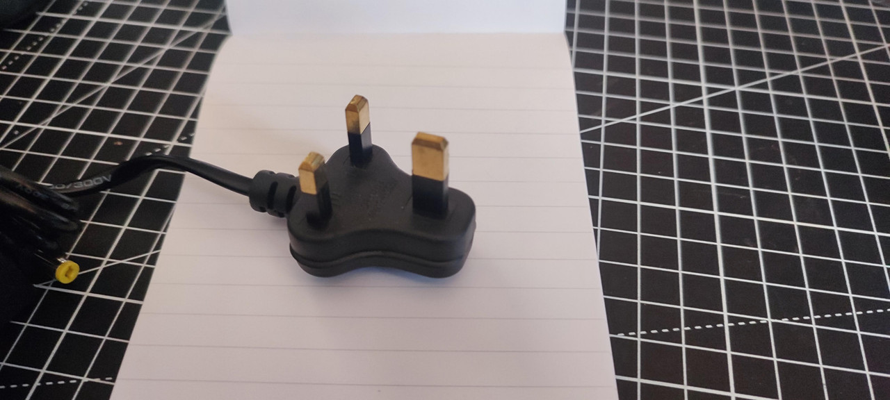

Gotta love the fused, not, plugs these come with on their PSU's.....
thankfully, I had 3 12v 1.5A PSU's not used from Shucked WD drives.
