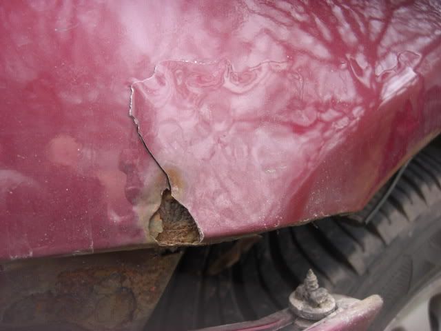

Sorry, the rust has penetrated right through all of the spot welds, the tin worm is well and truly in there. Do anything other than replace the metal and I guarantee it will make a return sooner than you think.

As mentioned, I would rub it down with a wire brush, treat, fill, sand and re-spray.

This is when you need to start thinking about cutting it out :D
Was botched previously by the former owner i guess..
I don't have 'credentials' but I do know a great deal about bodywork. More relevant than that though, I had exactly the same thing happen to my car. I cheaped out and had it 'repaired', the rust came back within a year. Next week I'm having new quarter panels put on.
Those arches are well and truley salvagable.
it looks like the rust has crept in from the edge under the paint, rather than come through from behind. So i don't think there is any extra hidden rust, which is often a problem with arches.
So i reckon, grind out the rust, use a sanding disc or belt sander rather than a wire brush. wire brushes sometimes just polish the rust rather than remove it all.
use a rust treatment on any remaining nooks and crannies.
weld in a bit where it has rusted through.
after it has painted i would use an anti rust wax treatment, like dinitrol or something similar (not waxoyl, that's rubbish). spray it on the edge of the arch where the water got in before.

Absolutely salvageable, I suggest the repair you had wasn't done correctly Clarkey, especially if it is now requiring you to have new rear quarters. :D
I suppose it depends on the cost of new arches. I can get mk1 mx5 rear quarters for £88 each so it would be foolish to repair my arches when they get done later this year. If you can't get decent parts at decent prices, they are very much repairable. £200-£400 depending on the body shop. The higher price also won't guarantee the best work so ask around - I have found this to my cost that different body shops have hugely varying levels of overall quality.

The quarters are cheap, but the quote I got to fit them wasn't! Apparently there is a lot of work involved, It was suggested it would be £500-600 a side.
Yep, due to how the 5's rear quarters join at the bottom and around the inside edge of the door its quite a task to make them fit and look correct.

The amount of work to cut out a complete arch, weld a new one in, prepare the surface and respray to a decent standard will absolutely dwarf the cost of arch repair panels. It's a fairly skilled job as well since it's easy to create lots of distortion when welding large flat panels like rear quarters.
There is absolutely no reason that the existing arches can't be repaired to a good standard that will last. Done badly then they would be lucky to even last a year.

My arches looked like the 1st picture until i started sanding back and had quite a few little holes were the rust had gone through quite badly. Unfortunately Honda's have a habit of rusting inside out.
The corner will be allot worse than it looks, the 2nd and 3rd pictured areas will easily be sanded back.

Right,
Not specific to the s2k, but just in general, who has treated arch rust before?
I've taken a few quick pictures (First two of the rear left arch, the worst in my opinion) and the other is the rear right arch.
Interested to know what people think the best option here is. I want to cure it permanently and want the job to be as new and not have to re do it in 6 months time....

Has it ever had a replacement rear quarter? seems odd as mines rusty on one side but thats due to a replacement panel sometimes in the past. The otherside is mint still
