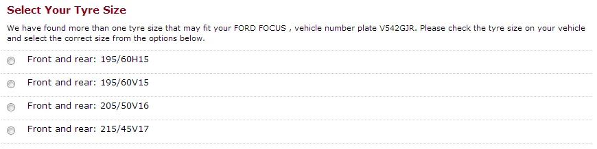

Edit - oh dear, I searched for the tyres based on my number plate, and it's come up with 195s at the minimum (whereas I've got cheap 185s on there). I take it this could be yet another contributing factor?

185 might be right in terms of size...I assume all 4 tyres are the same size? If so just stick with that unless there's a significant price difference.
