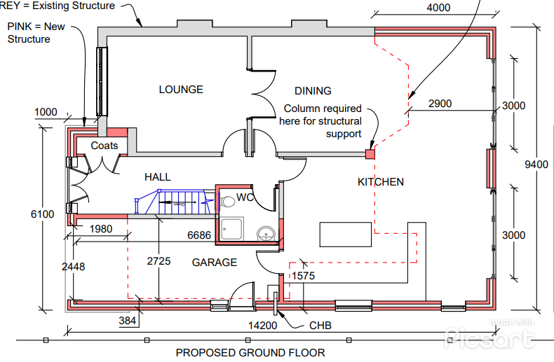

You may have seen this structural plan from my previous posts on this forum.
I've already got a set of Monitor Audio Bronze 500 and a Marantz NR1608 (I think it was) AV receiver.
I want to use a 5.1 system in my lounge but not sure where to put the rear speakers.
The TV, centre, fronts and sub will all go along the exterior wall (above the word lounge) and my sofa will be against the wall with the door.
Can the rear speakers be facing downwards or should they be at "ear level"? If so I would probably have to get some stands but can plan around that
The ideal placement is either side or slightly behind the listening position, and about 12" (30cm) above ear height when seated. However, in your case that won't be possible. With the couch close to the back wall, the potential left speaker position by the window is sitting behind the outcrop of the corner return that is the cloakroom. This rules out the mirror position on the right just past where the door opens out. This is before considering practicality such as drape positions and a speaker being in the way as someone enters/exits the room.
I think high up, facing down is your most practical solution. Look at MA Radius 45. The tweeter faces backwards so it diffuses rather than drawing attention to itself at such a short throw distance. This, or in-ceilings, but you'll have to think about how to stop the sound leaking up into the rooms above. You can end up spending as much or more on a fire hood with acoustic damping as you would a speaker.
I'd put them above the wall where it says "hall" also look into wall mount bipole speakers
Since you have Monitor Audio speakers
Yeah I'll be looking at which ones to get, but will stick with MA as they've done me well
That was my initial thought as well, I'll probably wall mount them but will look into stands just in case

I am thinking to put the speakers either side of where the sofa will be, so next to the door and on the other side of the cloakroom midway up the wall.

That's info you didn't give in the OP. We can only advise on the basis of what you tell us. If there's something that's going to affect equipment choices or how you use the gear then you need to include that stuff in your opening post.
Since you'll have underfloor heating upstairs, then that also rules out in-ceilings for Atmos (since your 1608 is 5.1.2 capable), but not upfirers. Your speaker choice for the ground level surrounds does depend to a degree on whether you plan to go Atmos sometime in the future. With a major rebuild/refurbishment job then it's prudent to include wiring now for what might reasonably progress to in the future. The argument here is simple. Opening up walls and ceilings just to run speaker wire is expensive, messy and disruptive. The cost of adding that wiring now while you have all the mess going on - even if it never gets used - is a drop in the ocean.
If Atmos will never ever happen, then you can choose diffuse surrounds. The Bronze FX are a good choice.
@hornetstinger is correct. If you're going to be close to the speakers then you don't really want direct firing monopoles (ordinary speakers) because they'll just be too distracting. That's part of the reason why the 45s work well. The tweeter doesn't point at the listener. It points away. Position them about 1ft from the ceiling, and facing diagonally down. The 45 speakers will work okay with Atmos. The FX though won't image correctly when working with the other Atmos speakers to create the height effects.
Also to add to above regarding diffused surround speakers in 5.1 and direct firing (all round) for atmos, just how common will discrete (not expanded) atmos mixes be? 95% of my material is 5.1 and 7.1 lossy or lossless, so the compromise of diffused surround speakers to direct- seems a fair one. Also cost of changing them.

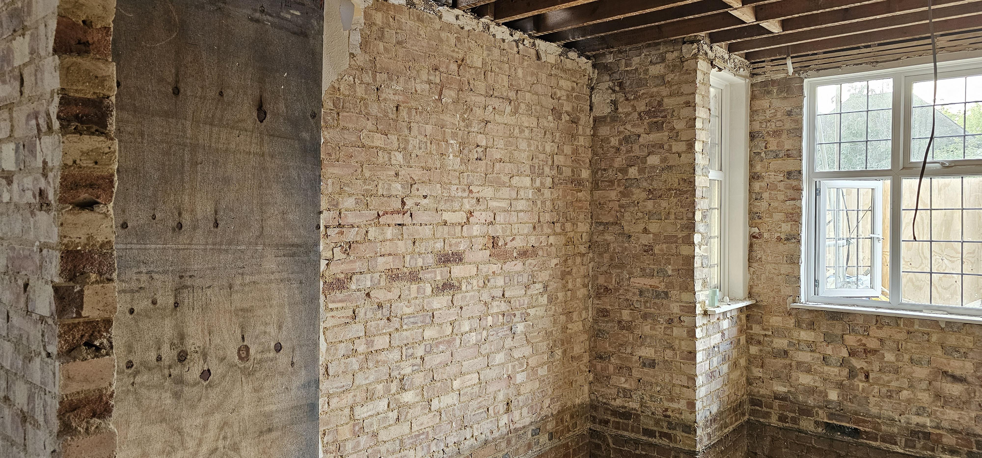

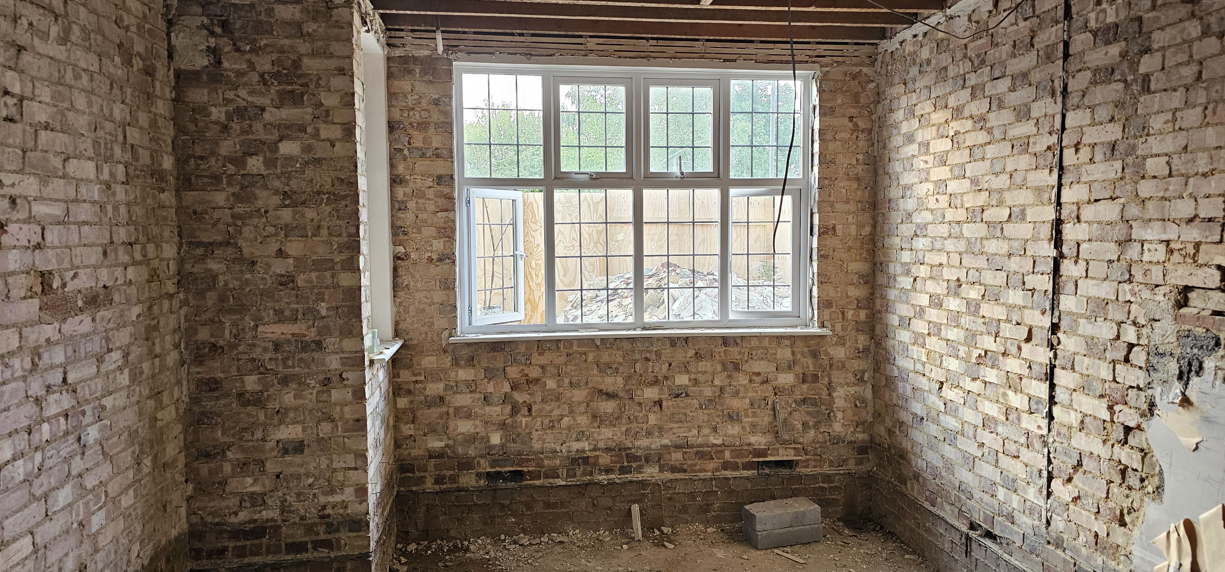

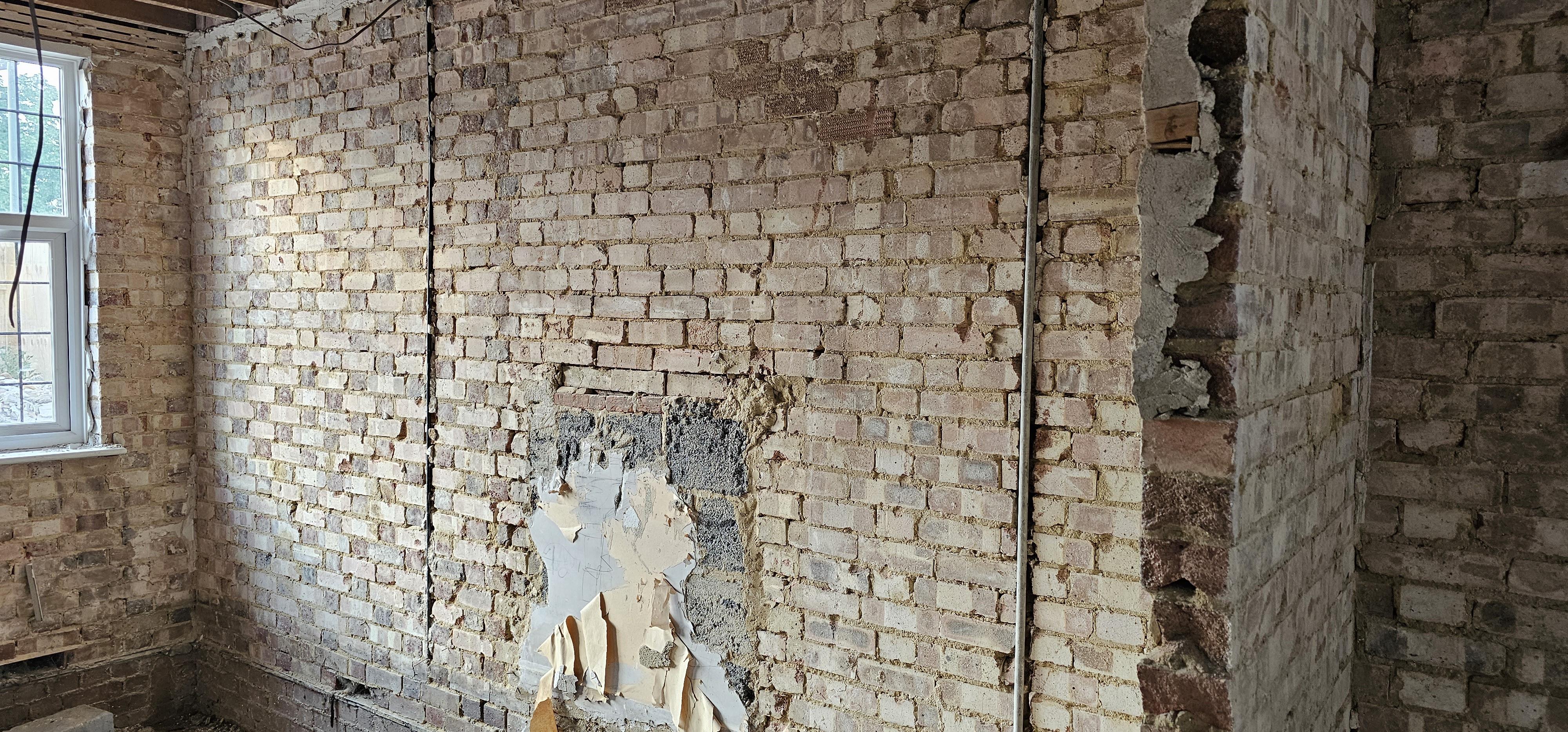

Just to give you a updated view of what I'm working with!
Side view of the room
TV wall
Sofa and door wall
