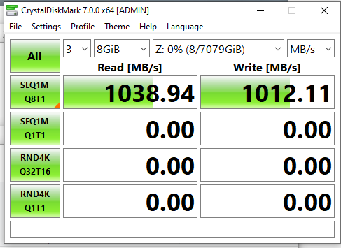

If you use Crystal disk mark on your NAS share you can see what its burst rate is, you will probably see ~1000 Megabyte unless your SSDs are particularly slow.
Of course Raid 5 doesn't offer the performance benefits of say raid 0 or 10 so might just be that.
Example of 10Gb Crystal diskmark on my NAS share, this is two slow 4TB Samsung QVO drives in raid 0 Normal SATA SSDs like this top out at 550MB.
If you wanted to confirm your network has the performance or if it is the drives you can do some iperf tests between NAS and a client to see what your network performance is without drives.
If I use crystelmark I only get (usingSEQ1M 5X 8Gib) 627 MB read and 922 MB write.

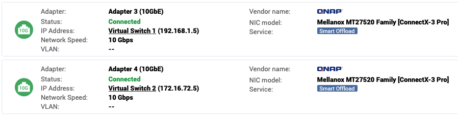

This is my QNAP:
@Avalon Aren't SolarFlare and Mellanox the go-to 10Gb NIC for 'our sort' of hobbyist these days? Decent driver support and cheap 2nd hand, certainly for SolarFlares. The HotLava cards look phenomenal as well, but definitely on the pricier side with no eBay bargains to be had. :p
It depends on the usage and how you want to scale, in this scenario my sit back and wait approach to NBASE-T WAN now has an end point in sight, it's almost exactly 6 months from now and the only option I like technically is an Intel x7xx. The bare minimum would be an i225-2T, QNAP make a 2T and 4T, but we're talking used Intel x7xx territory and that brings 10Gb to the party along with well proven stability/drivers, the i225 really doesn't.
For general 10Gb on SFP+ Mellanox CX2's are (or were) the go-to, later cards run cooler and are less power hungry, chuck a £100 Mikrotik SFP+ switch in or an 8 port TP-Link for twice the price and it's great for a few workstations/NAS/Servers. Staying copper is another £100 on-top of the TP-Link for the switch, but lets you pick up the x540 or Supermicro cards and use 5e, but prices now are still generally higher than a few years back :( ESXI has made a lot of decent hardware EoL and Proxmox support is variable for similar reasons. Hopefully 2022 is the year we get better hardware options along with better connectivity.

This is my QNAP:
I changed the IP to what you put and it's still the same.
Both PC and Qnap say 10Gb connection.
My qnap has a Annapurna SFP+ 10G Ethernet Adapter
