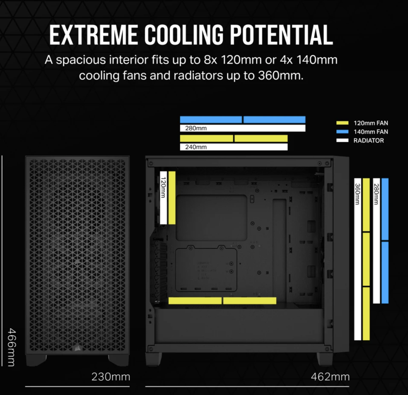

Tbf the reference cooler should be alright BUT also the 6950XT is a pretty toasty card overall too. Any chance you can get a 120mm or 2 underneath the gpu at the bottom of the case to feed it cooler air?
As shown here in yellow;
