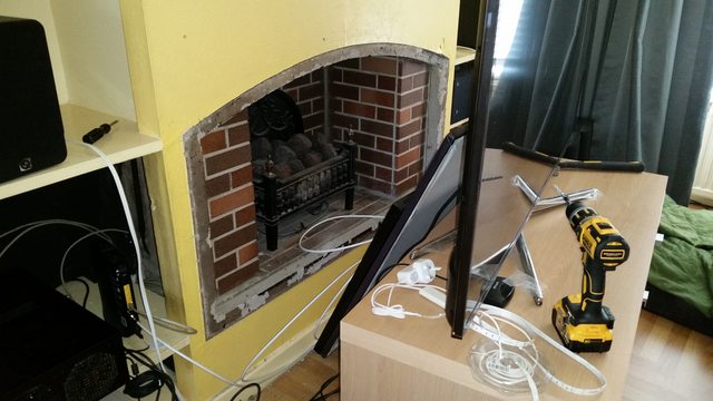

I did this in our house but luckily I didn't have to remove the actual fireplace. When we moved in there was some god awful gas fire which was so old the gas engineer said he'd never worked on one before and it had no safety features or proper ignition. We needed to replace the old pipe running through the house as it was corroded and leaking so while he was doing that I got him to take out the spur to the fire. I then just ripped it out and skipped it.
The nearly finished version:
