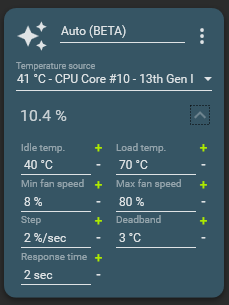

I'll look into the fanstop, in fairness most of the noise is the case fans which SCREAM when gaming, I've got a fancontrol setup that keeps them calm at idle, aside from extreme cases in the middle of summer, I can't see a way/feature to adjust the fans on the AIO, maybe that's a good thing, but also with an 360MM AIO pushing out of the top, do the case fans really affect that so much? Temps are never really the issue, just the sheer noise of the front fans when gaming, which, in fairness has actually stopped me a lot of the time just due to the sheer racket.

You'll just have to adjust the fan curve. I'm assuming you have the case fans linked to the CPU temp.

You can either (1) set your case fans to run off the mobo temps instead, or (2) just separately alter the fan curve independently of the AIO pump/fans.
It's a Gen 13 17 13700KF
Idle temps are usully 35-40, any better options than FanControl that would allow everything to be controlled effectively?
That's the current curve/setup, as said with the AIO I'm not sure how much the fans are really doing here for the CPU as I assume the AIO is taking care of that!

Personally, I would use the motherboard bios fan controls rather than a windows program.

You could just change the temperature source to the motherboard temp, rather than the CPU temp.
