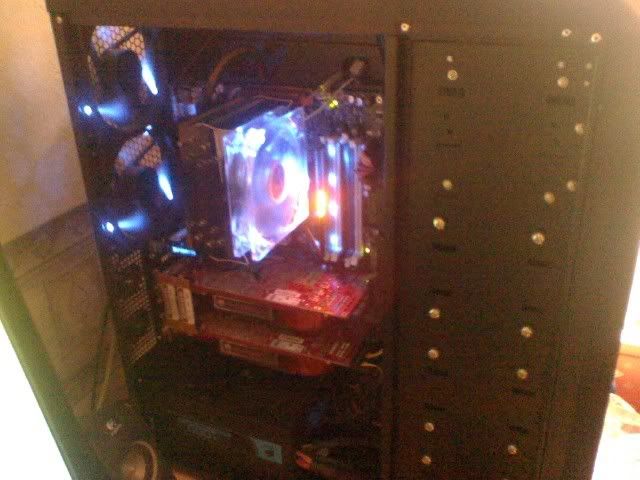

Almost time for a new build and I would fancy a replacment for my early version antec 1200. I don't mind the noise of the case, everything on mine is stock and the only thing I find irritating on it is the cleaning of filters and pain in the **** to change over HDD. I would probably have stuck with it but the power button on mine is dead and I have to use the reset button now instead.
The depth of the 1200 is 513mm and I really don't want or need to go bigger than that or it will protrude from under my desk.
