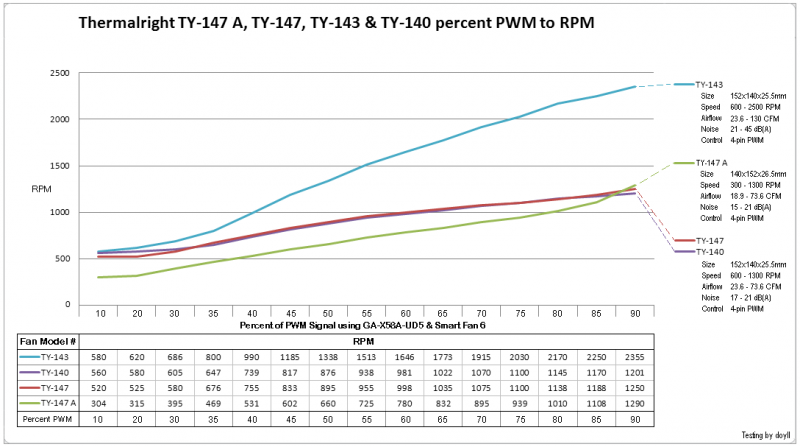

What do your PH-F140HP fan PWM% to speeds running on the PWM controlled hub look like? I assume that is how you are controlling them?
TY-143 work really well. I found their rpm difference to 1300rpm case fans using same PWM signal to work very well. I was using TY-140 for case with TY-143 on cooler
PWM TY-147A TY-143
10% 304rpm 580rpm
20% 315rpm 620rpm
30% 686rpm 686rpm
35% 469rpm 800rpm
40% 531rpm 990rpm
45% 602rpm 1185rpm
50% 660rpm 1338rpm
55% 725rpm 1513rpm
PWM TY-140/147 TY-143
10% 520rpm 580rpm
20% 525rpm 620rpm
30% 480rpm 686rpm
35% 676rpm 800rpm
40% 575rpm 990rpm
45% 833rpm 1185rpm
50% 895rpm 1338rpm
55% 955rpm 1513rpm
60% 998rpm 1646rpm
I didn't run them at higher PWM% in the above system because they will not even reach 55%, even when stress testing. :D
The reason for the difference between the above charts is the TY-147A has a very different PWM /rpm curve to TY-140 & TY-147. Same fan, different curve and lower idle.
TY-14xseriesfanPWMtoRPM_zps159afb80.png~original
