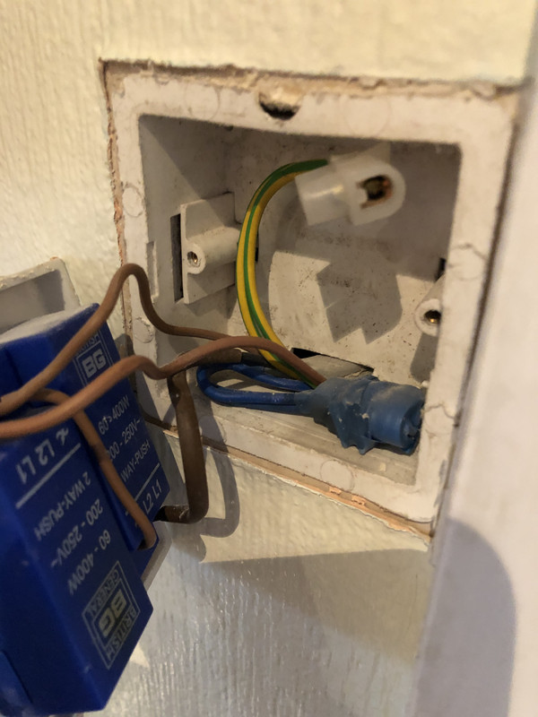

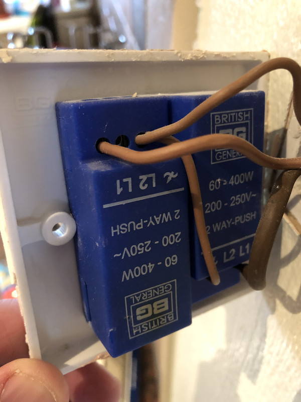

I'm replacing a double dimmer in the kitchen with a normal double non dimmer switch. I thought it would be straight forward but I cant just work out what I need to connect. The dimmer seems to have some kind of link cable between switches and the earth and live are bundled up in the socket.
Could someone point me in the right direction (and I dont mean calling out an electrican just yet!) :)

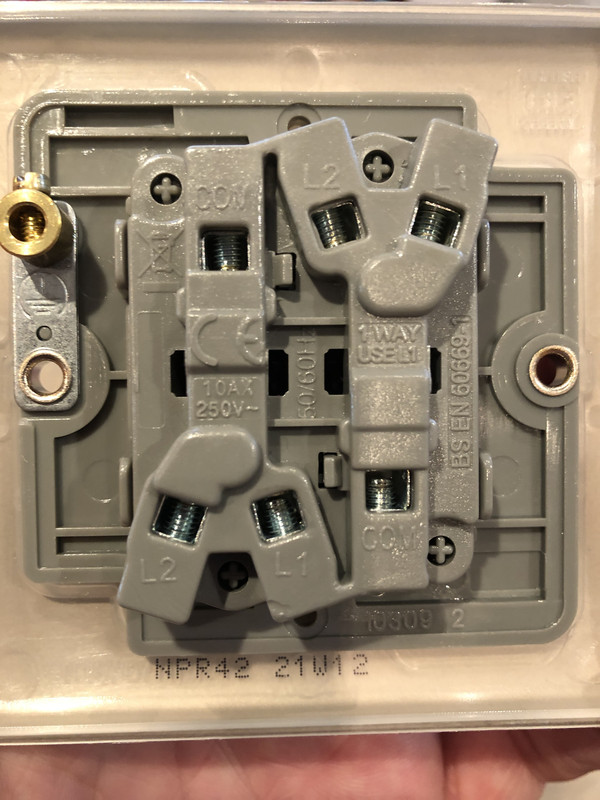

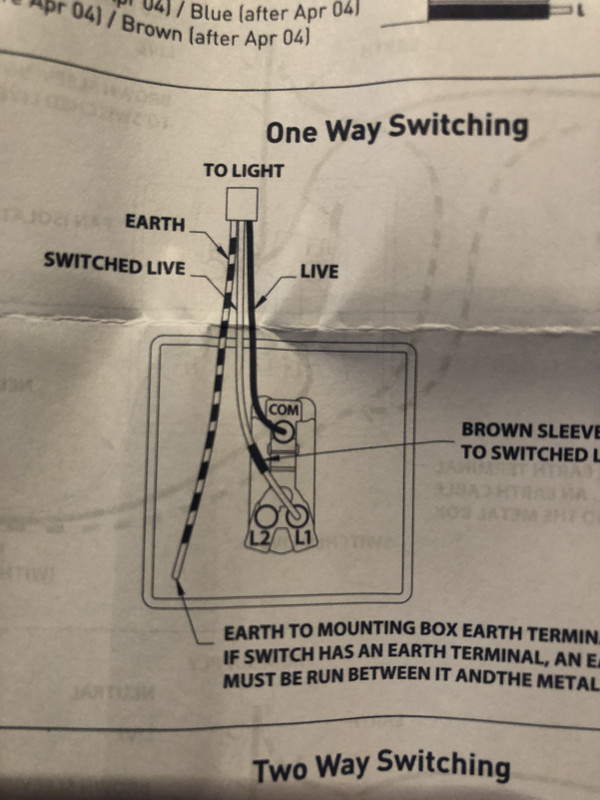

Wire it identically the only difference is the X type symbol (on your old switch) is now your COM on your new switch oh and make sure that you connect the earth (yellow and green) on the new switch (earth is the brass ring on the left of your new switch)
