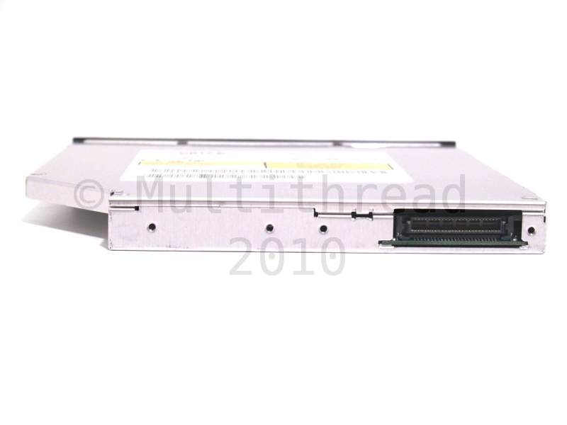

Does anyone know if you can just use a generic slot loading drive and do a direct replacement as replacing with an apple part is just far too expensive compared to an external drive?
I don't see why not. The optical drive in the MBP is just a generic slot loading drive. Although make sure you order one that has a similar connector, be it SATA or ATAPI.
Slim SATA
Slim ATAPI / IDE
You'll know when (if) you take the drive out yourself what you should need.
I'm not sure if you can use a generic one? I've read through the service manual on the macbook and it looks quite crammed around it so I'm not sure a std will do? might be wrong thou (hope I am and I can fix it on the cheap :) )
It's a standard slimline drive. The only proprietary parts will be the brackets (if indeed it has any) that mount to and hold the drive in place. What's the model number of your MBP? It should have it printed on the underside where it has the "Designed by Apple in California" spiel.
a mac book pro i opened had some sort of connector plug lik you get inside iphones.
