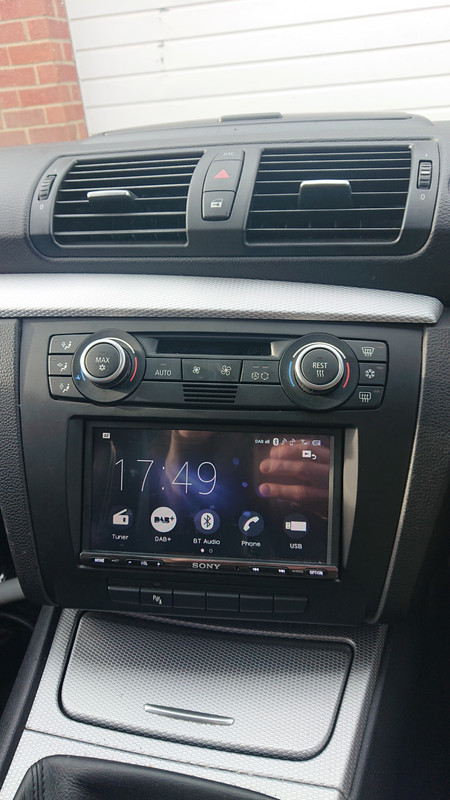

I had a Sony XAV-AX3005DB headunit in my old E87 130i that would match all of your requirements (BT, AA, DAB, RC).
For the microphone i installed one of these in the oem location
The fitting kit was a Connects2 CTKBM08 which included all the hardware to keep the steering wheel controls and PDC beeps
I bought mine from Halfords and got them to install it as they had a great deal on at the time on Android Auto headunits, and also a deal on free installation. IIRC I paid around £275 fitted. Buying everything separately and fitting it myself would have been over £400!
