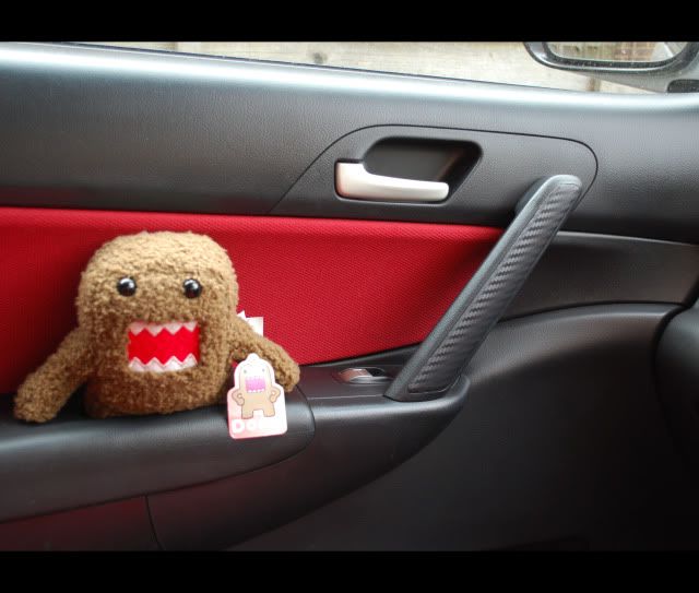

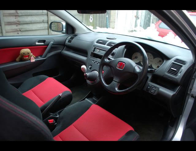

I've seen some done with that 3M stuff and it can look good:
Takes aaaaages to do it properly though apparently... only thing putting me off, I'd rush it and ruin it!
