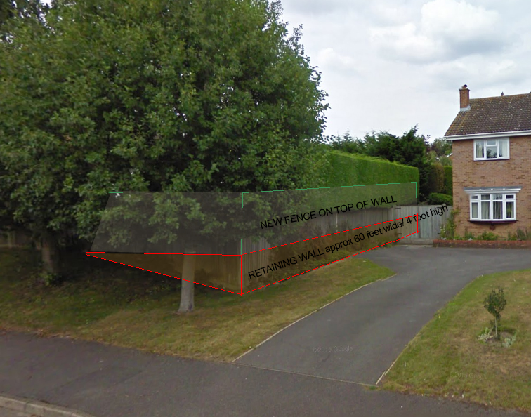

Hi Guys,
My garden slopes down at the back probably about 4 foot in height and starting from about 10 feet from the current fence line. This means that there is a lot of wasted space in the garden, previous owners had planted confiers that are now massive and the previous owners never really kept them in check so they fill nearly all this space. Although my neighbour behind has always kept them very tidy by the looks of it. Its his side you see in the photos.
If I was just to chop the tree down and keep the current fence it would mean that the top of the fence only just reaches the height of the majority of my garden. So I have been thinking about way of fixing this and my only idea was a retaining wall with a fence on top and then back fill this. I guess this would need to be about 4 foot in height and the length is approx 60 foot.The photos below show how it is at the moment and my mockup.
What would the best way to go about this brick wall, sleepers, those cages filled with rock? Or do you guys have any other ideas that might work?
If you were my neighbour would you have a problem with me doing this. Its their drive you see in the pictures. I haven't spoke with them yet as I have no solid plans.
View from my back garden, hopefully this shows the slope and size of hedges. This was just after I moved in and trimmed the hedge back hard.
Cheers

The best would be a small foundation and a garden wall built to the height you want. Ultimately though it'll be a lot of money.
Gabion baskets are nice with a nice stone and nice planting but it's difficult to fix a fence over it.
It's quite tall so it's not going to be cheap in any way or form if you want it to last.
A 60ft retaining wall would not be cheap mate.
If it truly needs to retain earth then either a very wide based footing or cantilever base would probably be required and maybe hollow breeze blocks with concrete poured into them.....for 60ft in length? Eek! :eek:
Digging out the conifers and roots could open up one big can of worms.
If you can really get back 10ft in width then maybe it is worth considering, but i think you've got a big job on your hands there for anything less dude.

If as you ask Joe and it didn't need to retain earth and I levelled the area behind the boundary to be level with the bottom of the wall would this brings costs down?
If it didn't need to retain earth then i guess you could simply dig an adeqate footing, maybe 300mm x 300mm and do a single skin breeze wall?. That would save a lot of time and money probably.
If you do most of the labour yourself like ripping the conifers out, digging the footings and filling with concrete, then pay someone to build the wall it may not cost anywhere near as much.

The wall is only four feet high so won't need to be anything like as well built as some are saying as the weight of earth it is holding back simply isn't that big! best bet is to have a chat with a structural engineer should be that expensive and they will tell you what you actually need.
